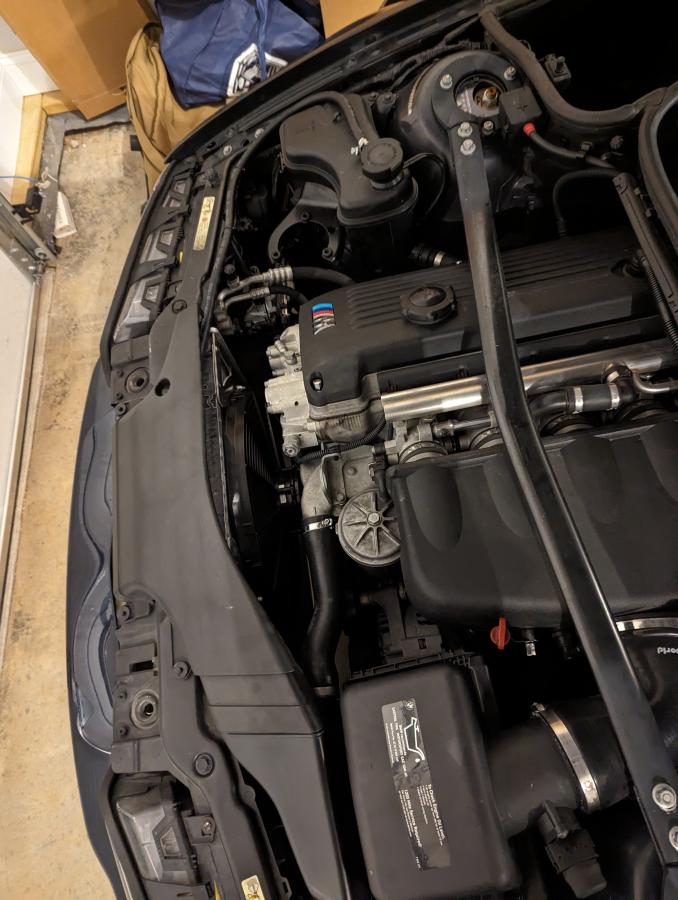

                          Finished swapping out my CSF radiator for an OE. Did a super flush on the cooling system like Chris Fix, broke the expansion tank that connects to the upper radiator hose and replaced that with the RE metal one which feels like a.huge upgrade. Got the coolant in it, drove it around for 30 min get all the coolant to circulate.
