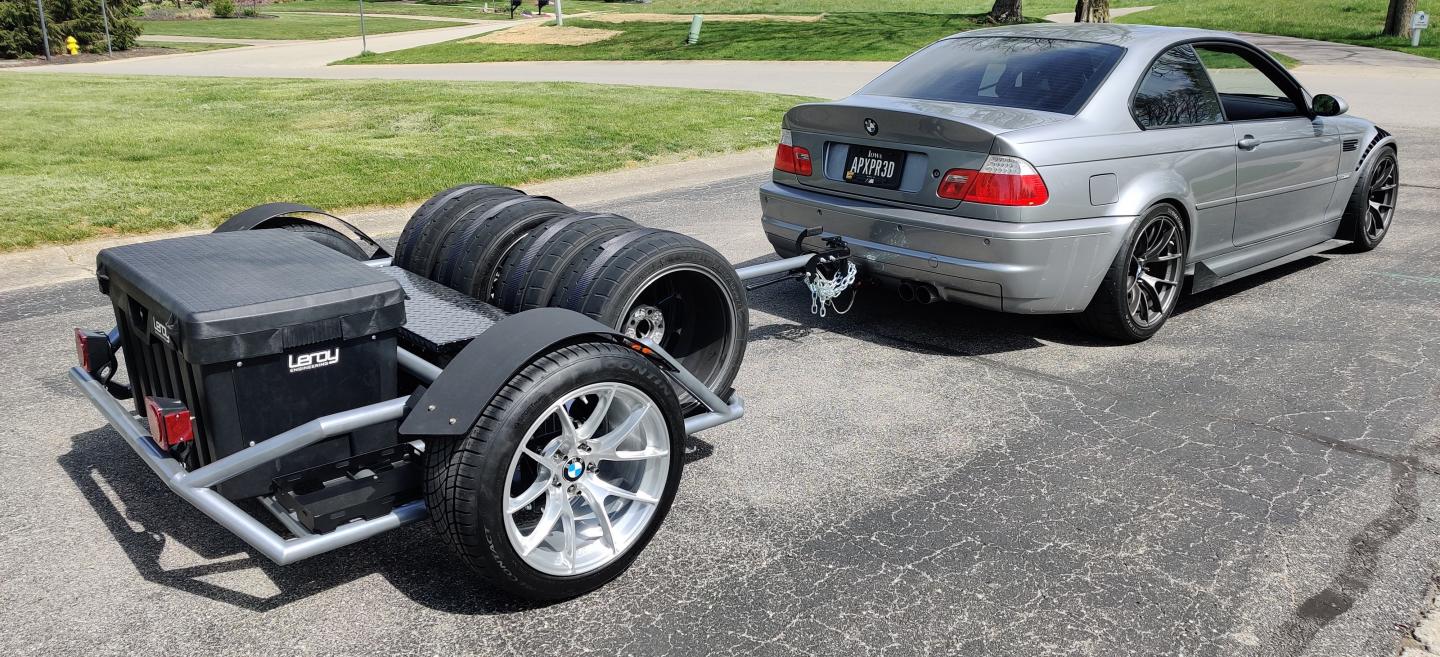

    Got the M3 a track buddy. I must say unloading at the track was a breeze!
    The matching wheels are awesome

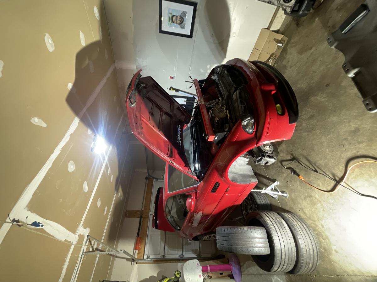

      finally did my rod bearings, the job wasn't that bad at all considering it was done on my garage floor. having a early model s54 with re-usable rod bolts that don't need to be torqued and loosened 3 times definitely made it easier. not looking forward to doing the same job on my s85 with new arp bolts. cheers!

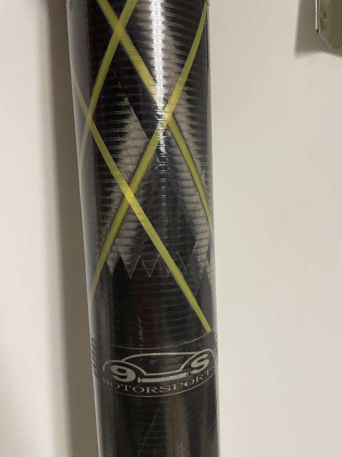

        Today my car received this thing in the mail from Matt at EuroConnex. Looks to be a very nice piece of kit. Looking forward to getting it installed on Tuesday...
        EDIT: It weighs 11 lbs on the button.
          Love the trailer, can you post more pics of it?
          It’s custom made or you bought it like this?
              It's custom so that I could mount bmw wheels to it. The trailer bearings are actually e90 front wheel bearings, so those shouldn't ever go bad on a 250lb trailer. Then they made the fender covers wider to accommodate the 18x10 wheels. It'll probably look better once I throw the all seasons on the car so the wheel color matches. I can snag more pics when I load up today to leave the track

                Can't wait to hear your impressions on this. This feels like a great alternative to a lightweight clutch/flywheel.
                  Good point. And I just dumped that LW clutch/flywheel rig so it should be a relatively solid A/B.
                  That junk was crazy loud. To quote my friend at idle, clutch out: "Why does your car sound like a diesel VW Rabbit?"
                  But it did feel great!

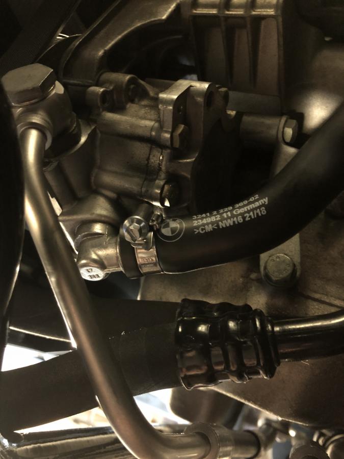

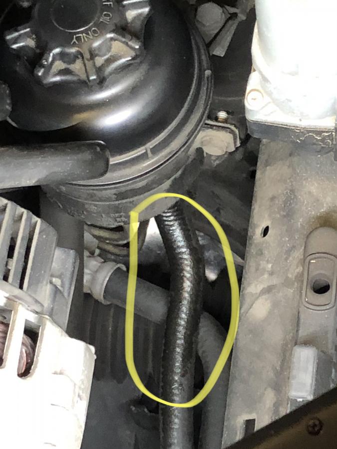

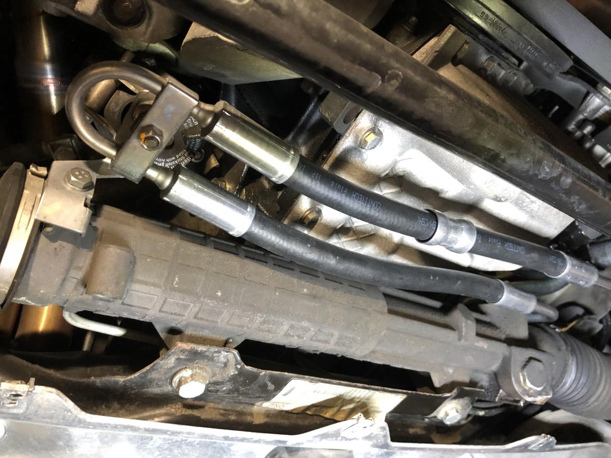

                    Finished up a full PS hose replacement, all initiated by an engine filter cleaning, which revealed a leak between the PS reservoir and return hose and a rotting high pressure hose set (photo below). I used all BMW parts, and realized 1) a fine tooth flex head torque wrench and ratchet are extremely valuable here for accessing banjo bolts unless you have every combo of swivels, extension, etc. (my case); 2) while installing the high pressure hose to the rack, ensure no hard contact between the line and rack body, while simultaneously ensuring no contact between the flexible hose portion and the oil pan. The original high pressure line was turning to dust and is seemingly a different construction than the updated part. I used the Clic-R clamps at the reservoir, but couldn't get it on the hose to the PS pump so I used a CMP German made clamp there, from FCP...seems to be good quality, and isn't leaking. Filled with LiquiMoly Top Tec 1200. Good to go! And, I replaced a vapor purge solenoid since I had access.
                              S85 isn't too bad, I would also replace the vanos line/ vanos pump with an uprated unit while your in there, just make sure and lever style dial indicator (not plunger) with a solid mounting point to set proper backlash.
                              You can buy the OEM BMW dial/holder but its $$$.
