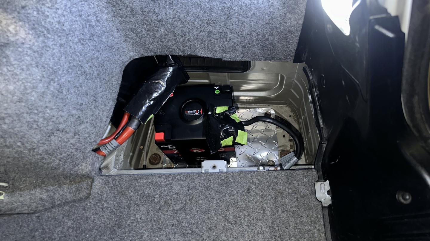

      Just recently got my car back after four months due to a front end collision. Immediately installed an Antigravity ATX-30 battery with aluminum cage and floor plate (-47 lbs) and OE CSL trunk (-8 lbs? 😭). Didn’t make any adjustments – just lined up the four bolts on the trunk in the exact same spot as the stock trunk.
      Ignore the ghetto terminal covers…proper rubber covers are en route.
