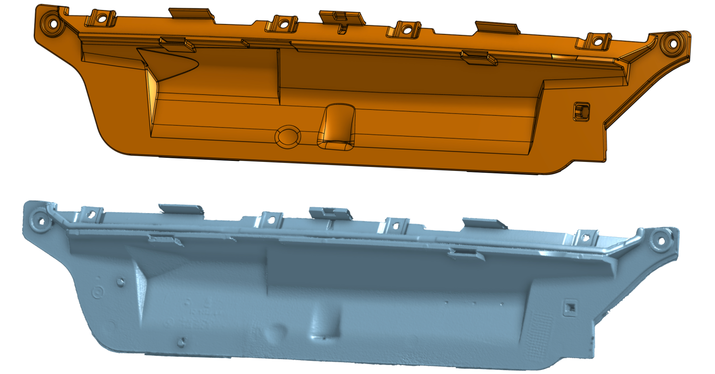

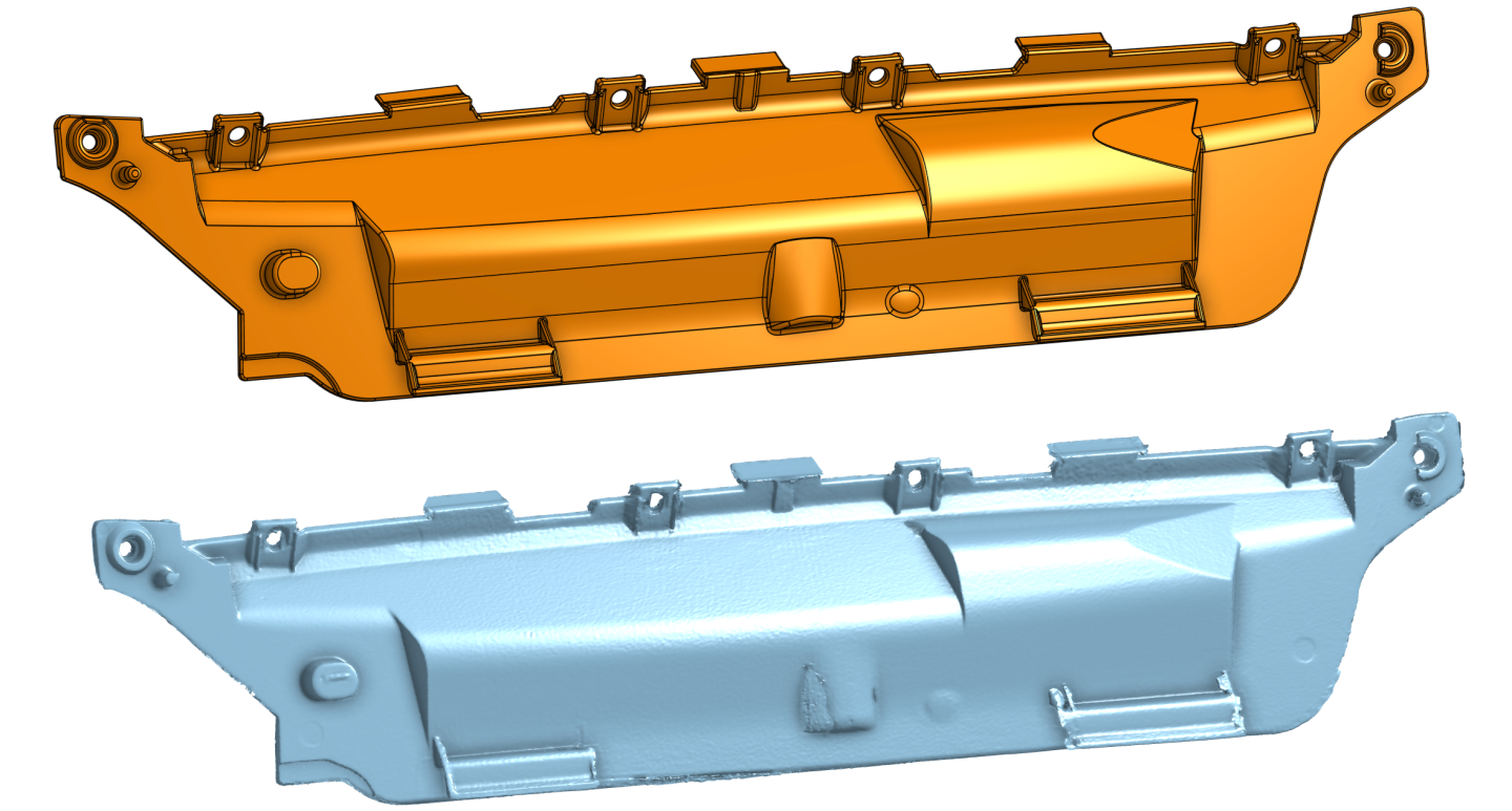

          Recreated the stock firewall plug in CAD from a scan:
Name:	Screenshot 2025-07-23 at 6.13.45 PM 1.png
Name:	Screenshot 2025-07-23 at 6.14.16 PM 1.png
          It's essentially a 1:1 copy of the stock piece.
          Have to split it up into three sections to fit in a regular desktop 3D printer, but it does all fit in one build plate. Weight comes out to around 300-400 g, depending on the choice of material and infill. Stock is 1618 g, for reference.

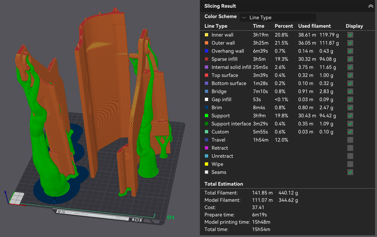

          This is the slicing result in PET-CF, with 10% cubic infill (complete guess as to what infill settings would perform well for thermal insulation) and some slicer-generated connecting dowels:
Name:	Screenshot 2025-07-23 at 11.21.34 PM.png
          Anyone up to print this and test it out? Am just looking for feedback on the fit and the thermal insulation properties. Hit me up if you want the STL!

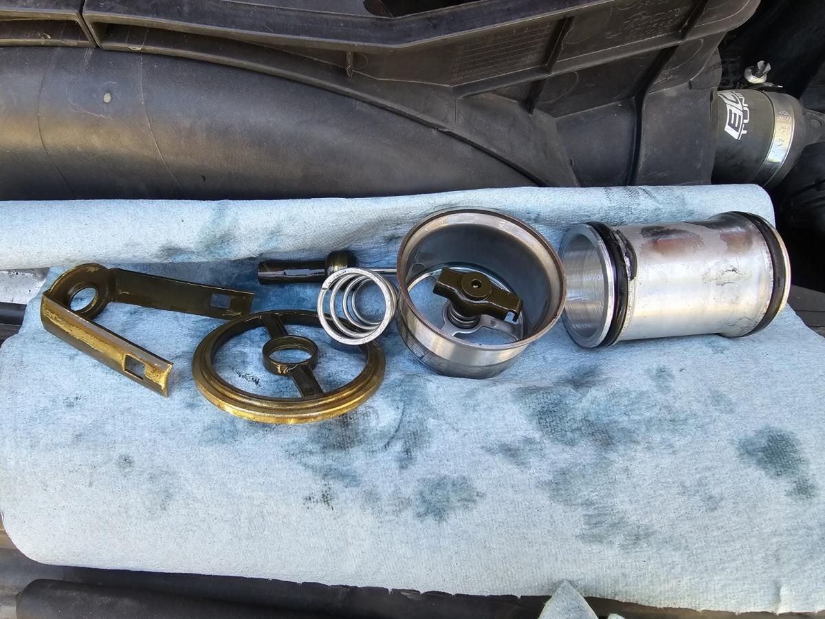

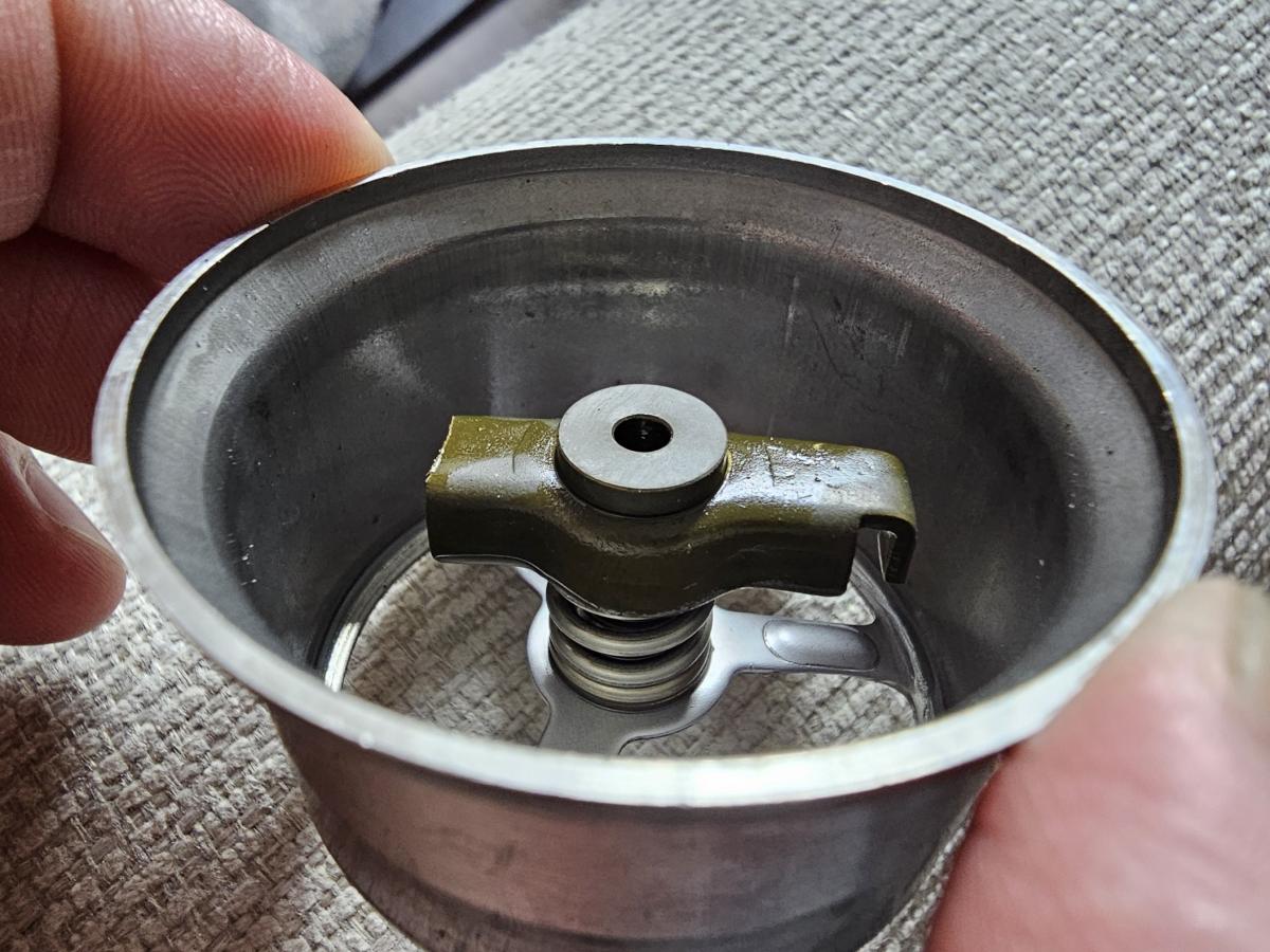

            the P0128 code didn't go away so I decided to change out the thermostat, since I had one on hand.
            I pulled off the thermostat housing and found thermostat parts lol.
            Click image for larger version  Name:	20250725_125835.jpg Views:	4 Size:	179.7 KB ID:	313278
            Click image for larger version  Name:	20250725_150402.jpg Views:	4 Size:	149.7 KB ID:	313279
            It looks like the bent tab snapped off (hopefully it is inside the radiator) and the rest of the thermostat disassembled itself. The stamp on it says "01 15" so I'm guessing it's made in 2015.
            While I was in there, I installed a few of the high temp o-rings from WOLFN8TR​'s kit.
            Put it all together, put some new coolant back in, fired it up, checked for leaks, reset the code, and now it's ready for the drive cycle to get the readiness monitors ready.

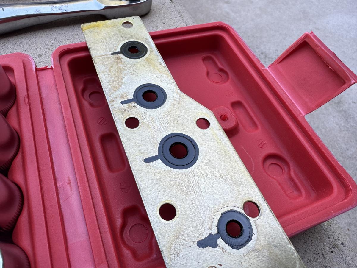

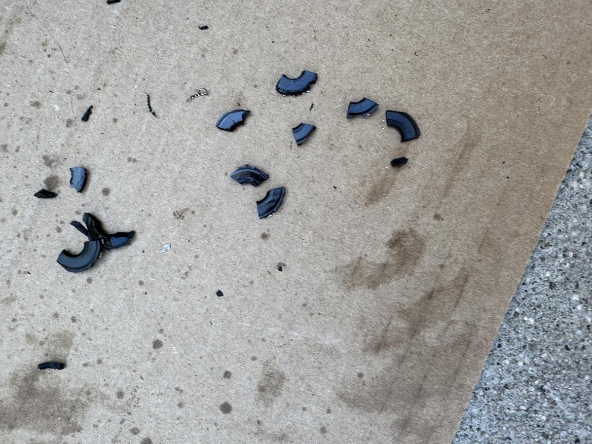

                    Replaced VANOS solenoid with Beisan rebuilt one after getting p0011 code. Sealing plate seals were plastic, as well as one of the gaskets on the restrictor valve.

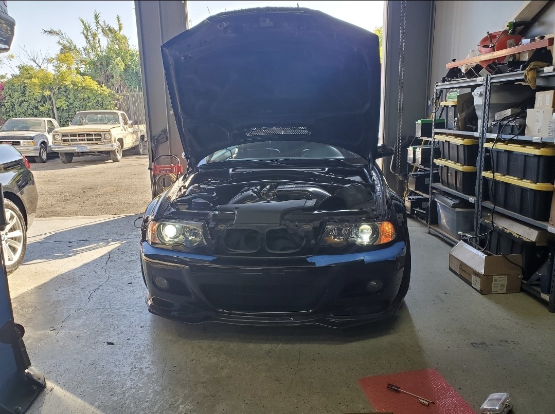

                              Oil change because I was bored… but also look at this temp!
                                Ya it's hot out today. I stepped outside and promptly went back to the garage lol
