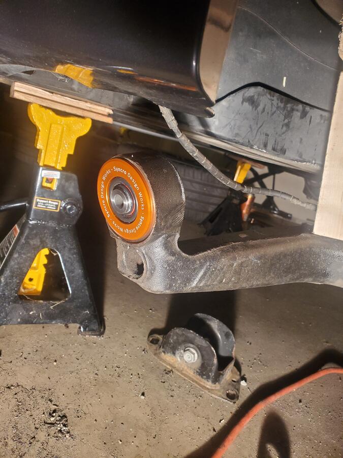

                    Doing a refresh on my suspension over the winter. Replaced the original almost 20 year old RTABs (car has low mileage). Click image for larger version  Name:	20201122_160312.jpg Views:	0 Size:	82.8 KB ID:	69050

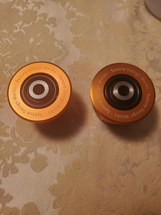

                    Click image for larger version  Name:	20201123_020416.jpg Views:	0 Size:	94.1 KB ID:	69051

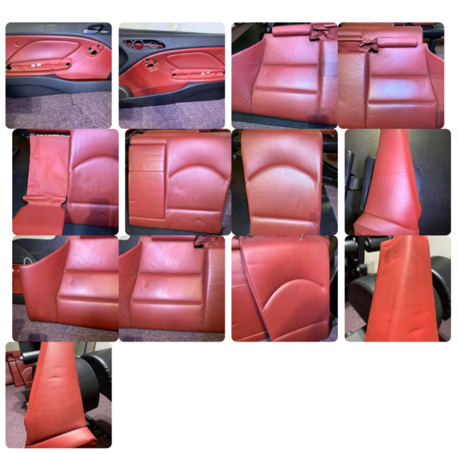

                        Bought Imola interior 😁👍

                          How difficult was the install?
                            I feel like the removal of the stock RTAB's was a pain because they take a good amount of force to remove them with the RTAB tool. Just make sure you clean the inside of the bores with a wire wheel so the new trailing arm can slide in easily with the RTAB installation tool. I also added a very light layer of anti-seize inside the housing so they can slide in easily as recommended by Syncro Design in the installation instructions.
