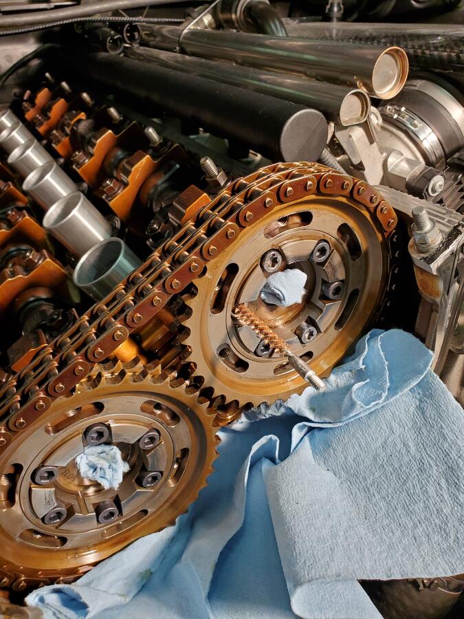

                              Cleaning loctite from female threads...for the 3rd time.
                              1st try= Lang bolts and loctite 242 factory torque spec
                              2nd try= Lang bolts and loctite 243 factory torque
                              3rd attempt will be: Lang bolts with loctite 243 (maybe 263 red) and a higher torque spec., 12ft lb instead of 9ft lb.
                              I am sure it would have been just fine on my first attempt.
                              .22 cal gun cleaning brushes work well.
                              I am so nervous that I have to cheat (bias the crank slightly CCW of TDC1) the timing for the bridge to sit flush on the head I am scared to start the car so part of this is me just stretching out the time it's going to take before the first turn of the key.
                              Instead of "bulletproofing" my vanos which worked just fine and already had the updated cam bolts (didn't know until disassembly) I feel like I am going to ruin my engine somehow, fingers crossed.
