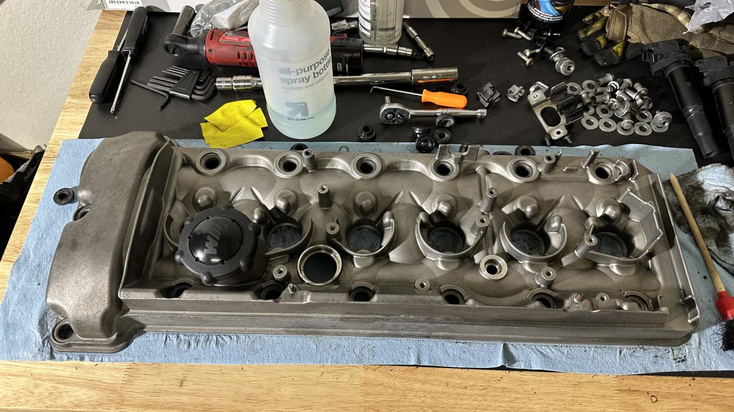

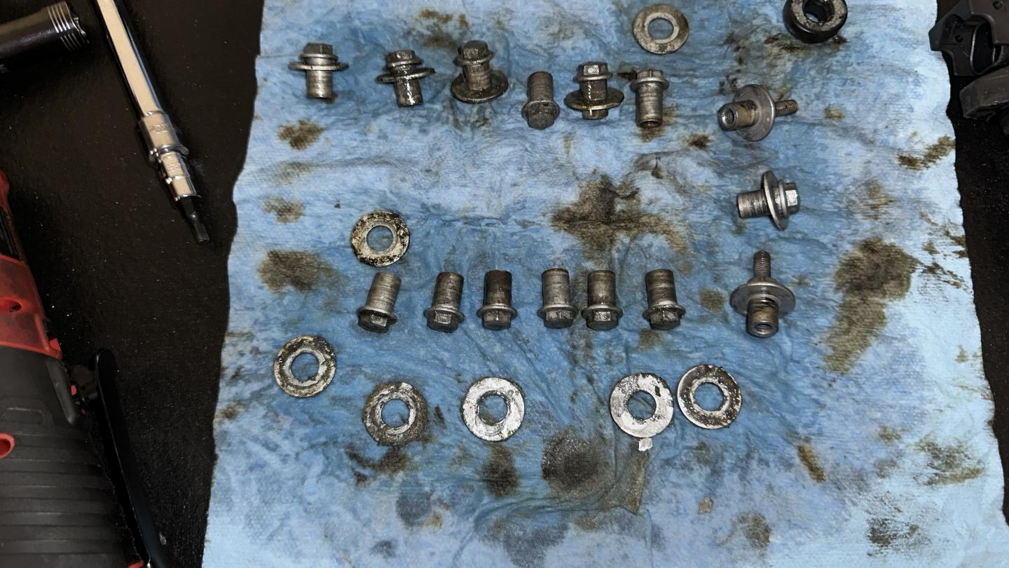

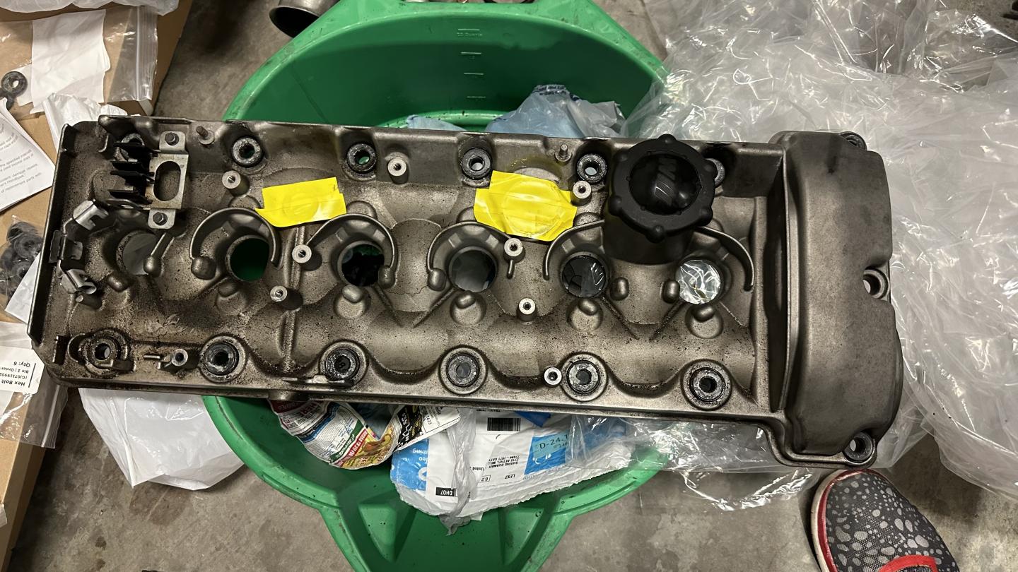

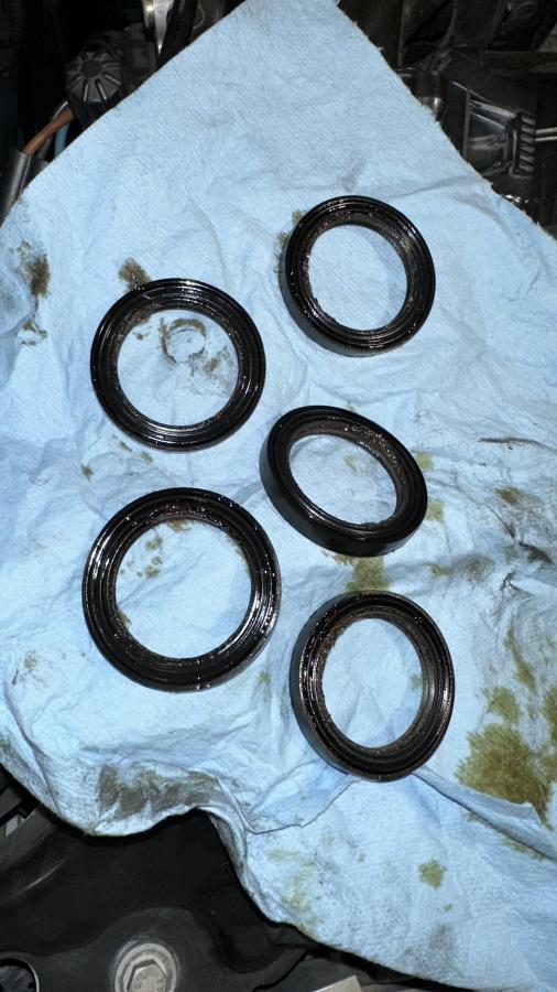

        Spent three hours replacing the VCG seals/grommets and cleaning the valve cover and hardware bc the guy who did my valve adjustment years ago overtorqued everything, which caused leaks.

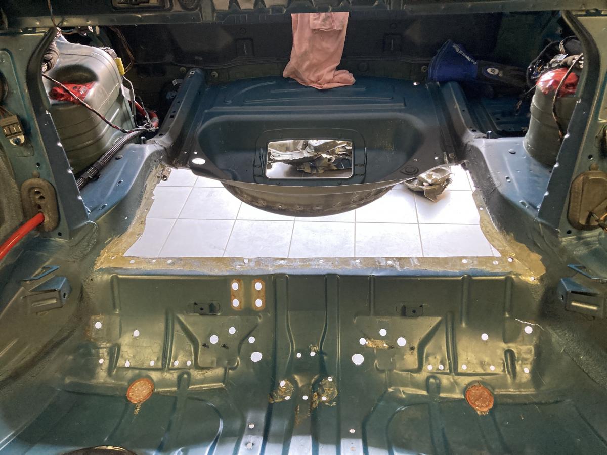

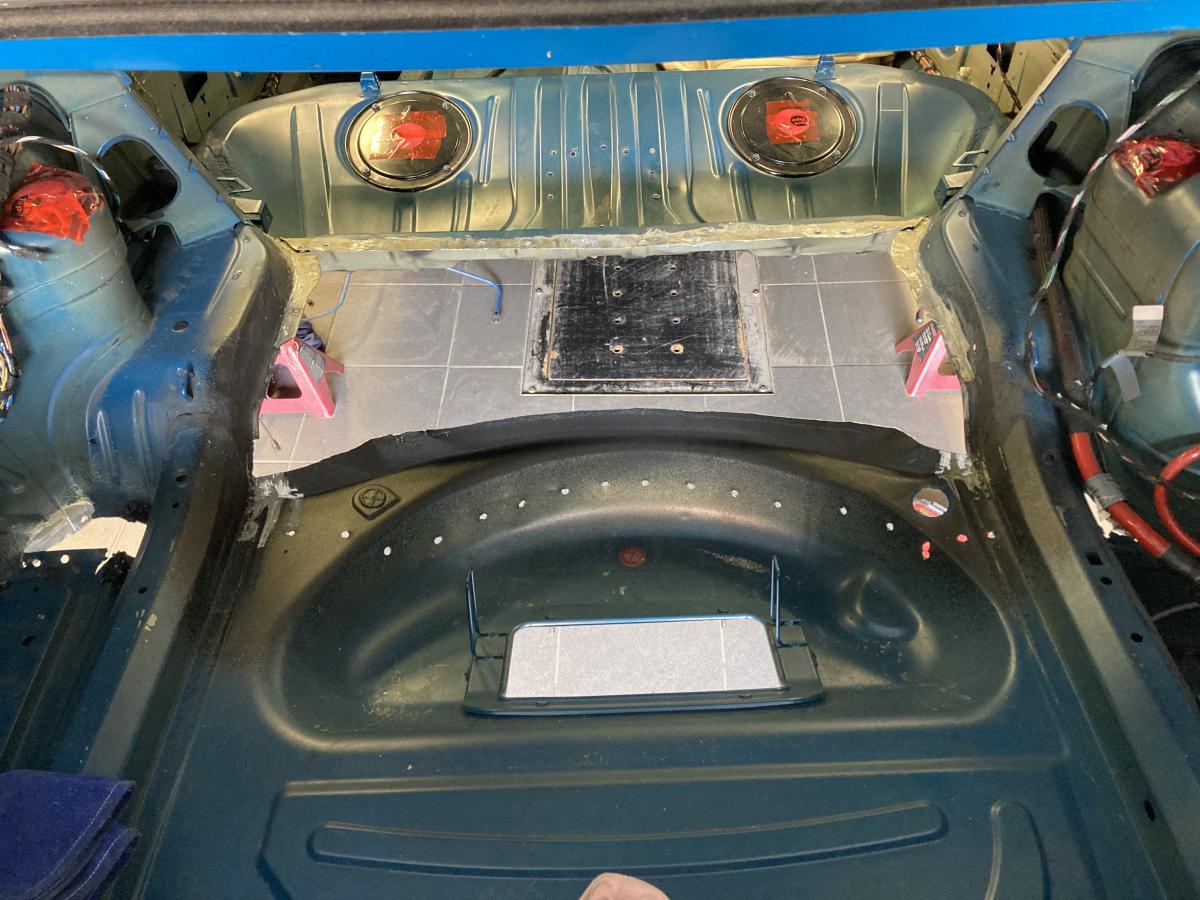

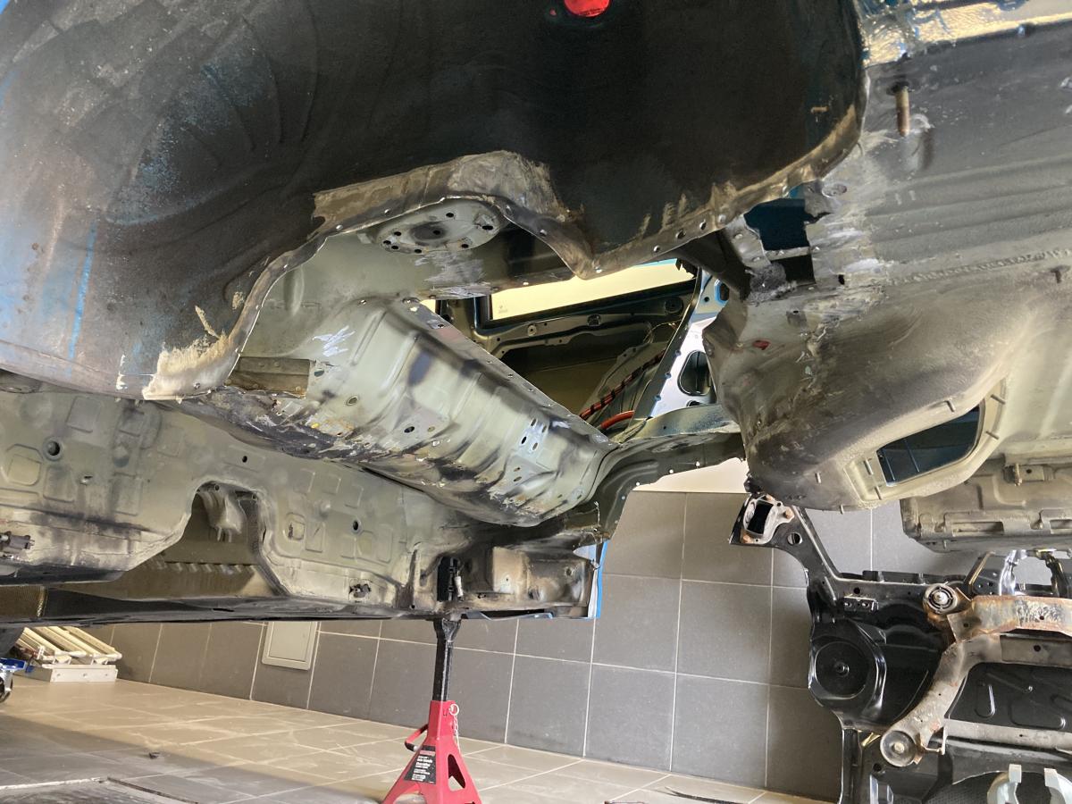

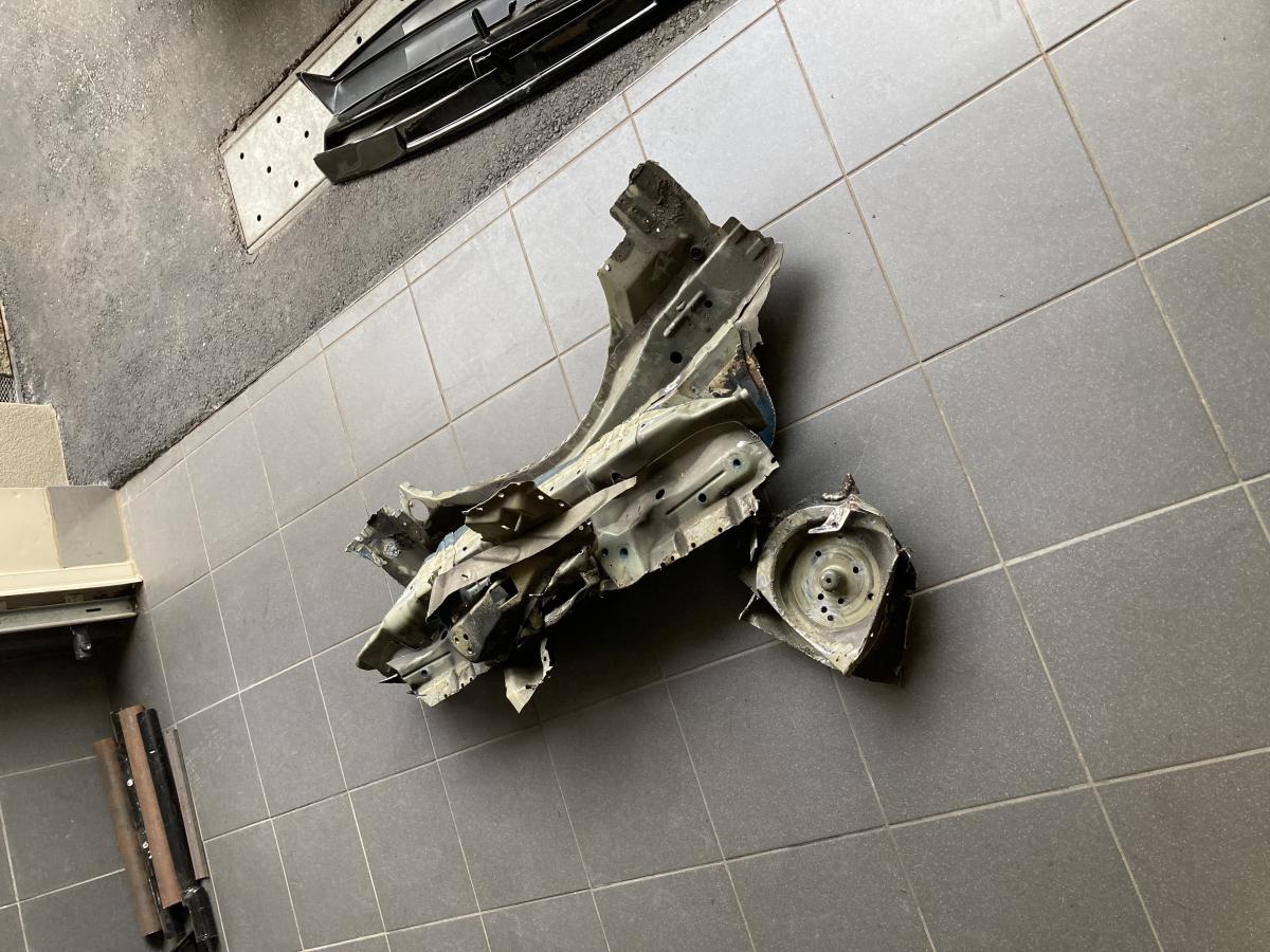

                    With the warmer weather here, I was able to work with the garage door open. So the old and cracked RACP is out, yeah!!!

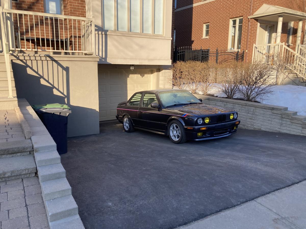

                    And yesterday, I bought an older friend for the M3’s!

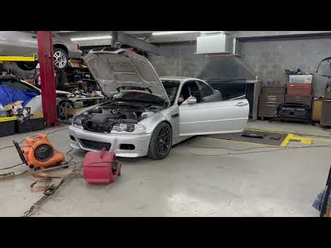

                      HTE Performance AlphaN dyno tune after doing a bunch of maintenance and installing CSL Race airbox. The car made 331 WHP/248 TQ. Interestingly, the airbox sounds better and louder on this car compared to my blue car with standard Karb airbox, Karb snorkel, and ITG foam filter. I bought an OE filter for the blue car as well, so I’m gonna see how much filter choice affects sound.

                        I read someone say that the OE filter sounded louder than the ITG filter on a karb box, but in my experience, my karb with OE filter isn't any louder than my evolve box with ITG filter, though the sound is a bit cleaner, metered - more like a true CSL car, but that I put down to the difference betweent he boxes, not the filter.
                              DIY this job? You have skills sir.
                              Old, not obsolete.
                                Thanks but it looks worst than it really is. Anybody with welding skills can do this honestly.
                                I bought a spare non-M rear subframe to make a jig out of it to make sure new RACP is perfectly align.
                                There is 7 episodes on Youtube from Redish on how to do this panel replacement.
