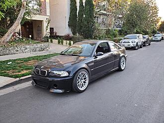

    My wheels FINNAALLYY shipped, they'll be here on Saturday
      I'm running an Eventuri intake.
      Fuel pump = $105ish genuine
      Injectors = $180
      Tune = $350
      I feel about 10-15 whp more on the butt dyno throughout the powerband. Once fine tuned I'm guessing it'll make 20-25 whp in various spots throughout the powerband over 91 tune. I'll dyno mine at EAS sometime to compare against everyone else in SoCal.
      Ah, you're running fresh stock stuff! I wanted to go Walbro 340 / larger injectors for an additional margin of safety for when I add cams in a few years. I made 334whp on EAS' dyno with the Hassan tune & a TMS CSL box. I'm definitely curious to see your results - I'm sure Hassan will not let you down. Keep us posted!
          Injectors = $180
          Tune = $350
          Oh boy, it will prolly make 400whp on EAS's dyno-lol. Do you by any chance have any base numbers on EAS's dyno so that we can compare before and after numbers?
              Just to clarify, I'm running Bosch 550cc injectors and a Walbro 485 that's E85 compatible. I would never recommend or run stock stuff with a full E85 tune, not enough overhead for fuel volume.
              Haha yeah I heard their dyno runs high but seems like the best baseline to compare to other local guys.
              Unfortunately I did not dyno before I added headers etc, so it will only be useful for comparing to what other people have put down, not against my own baseline. Normally I really like those kind of comparisons, but in my case I didn't have time. The motor also has 222k miles on it so it'll be compared against motors with a lot less miles.

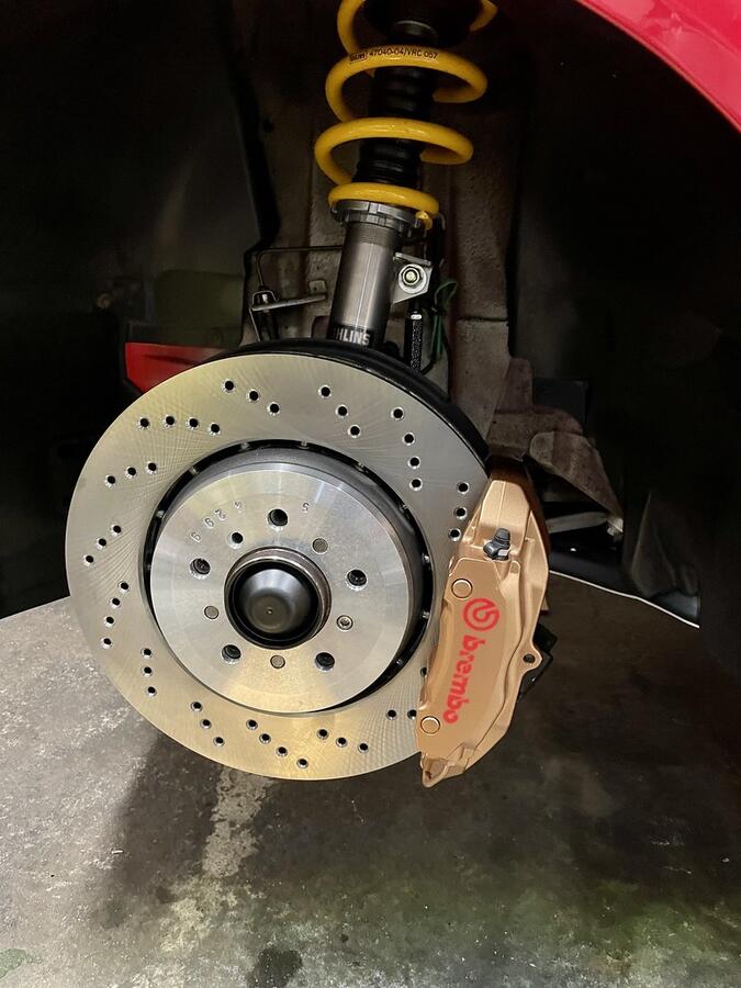

                Started my 996 Brembos install with new rotors 👍

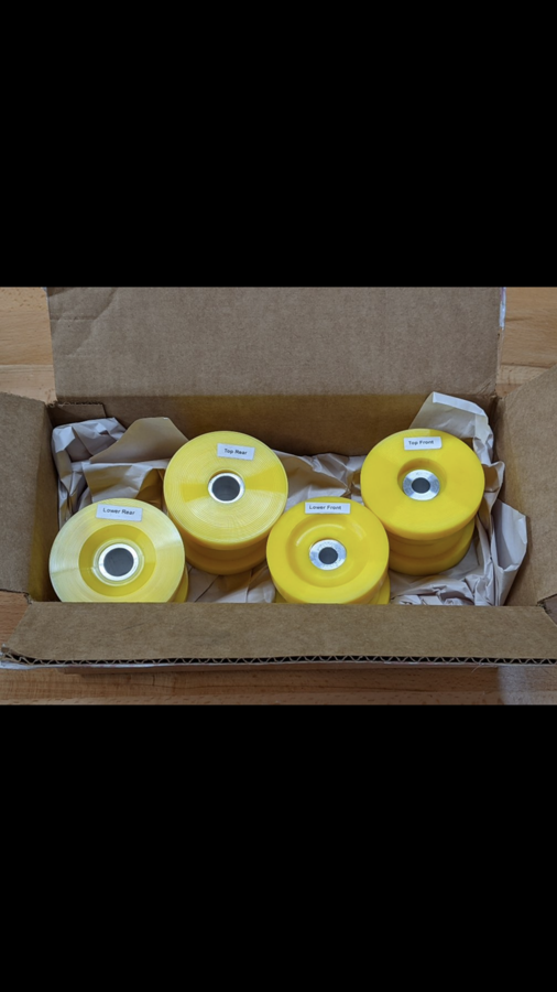

                        Reddish Motorsport subframe reinforcement and AKG 95A subframe bushings.
