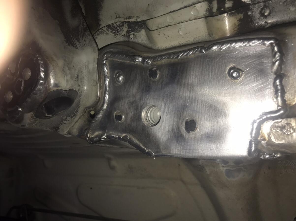

    My previous picture...not sure how to edit comment but anyway...almost finished with CMP top and bottom reinforcement, cmp bushings, aluminum diff bushings, Ohlins R&T— some interior work to finish but car drive-able. Took it out today...everything felt really good. Glad to have reinforcement behind me.
    Did you do it yourself?
      #47
      You hear more diff whine from al bushings? Other than that, the rear end should feel super tight. After my CMP was done, it kinda felt like someone added a big swaybar in the back.
                My son and I did it. Couldn’t have done it without him. Spent a lot of time in the garage on this one. Great father/son project.
                  #53
                  Yes, more diff whine. I kind of liked it on the short drive yesterday but could see it being annoying on a long drive. Have to get the back seats and carpet installed which cut down on the volume a little. The rear end felt really good. Much tighter than before.
                  Need to say thanks to Cayn from CMP who answered multiple emails regarding clarification on the instructions and to the diy thread in the previous forum with the write up and pics.
                    #54
                    Wow, was welding difficult?
                          A little yes. Lots of odd angles and positions plus welding underneath and stopping a lot to avoid metal fatigue from the heat. I’m sure a professional welder would have been quicker but we we’re not in a rush. Did a little welding each night over a week. Happy with the results.

                            #58
                            Update on the aluminum diff bushings, installed rear seats and trunk liner today. As expected diff whine much reduced, you can hear it but it’s not real noticeable, you have to listen for it.
