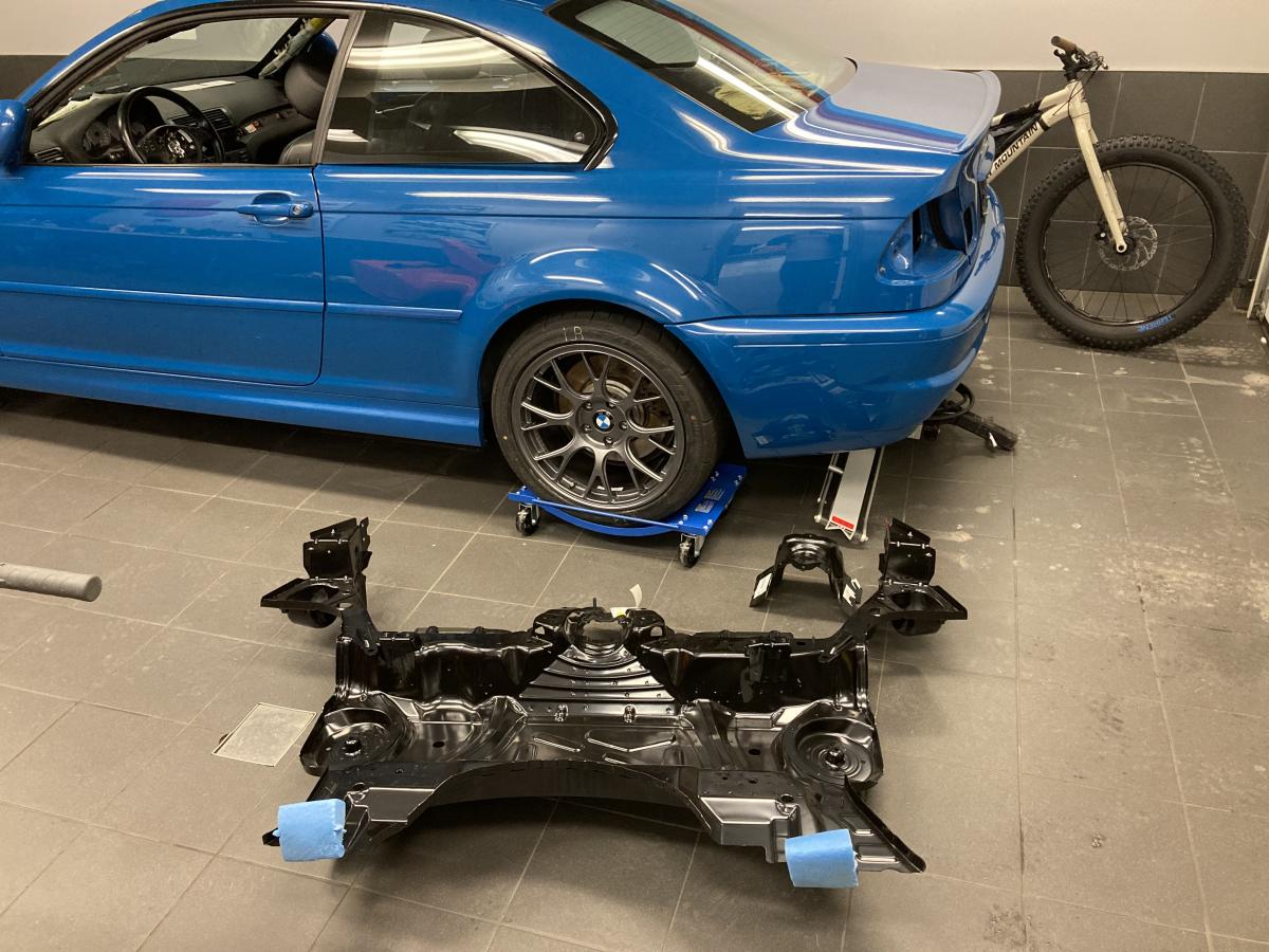

        I see, thanks. got it so it is totally possible to install the Vincebar or cmp bar without removing the subframe. I may do them in two steps first install lower plate and then save money for installong the top bar later. Does it waste labor time by your experience, thanks.
          #49
          Cant speak to the CMP, i did the vincebar myself so thats what i know about. I dont think youll save much labor or money doing them seperately. The plates will require removing the subframe and the vincebar will be much easier with it removed. the amount of work that goes into each invidual job is quite a lot, adding them together is going to be advantageous in the long run.
          its a big job but once its done you should be good to go. As so many have said before, ‘buy once, cry once’

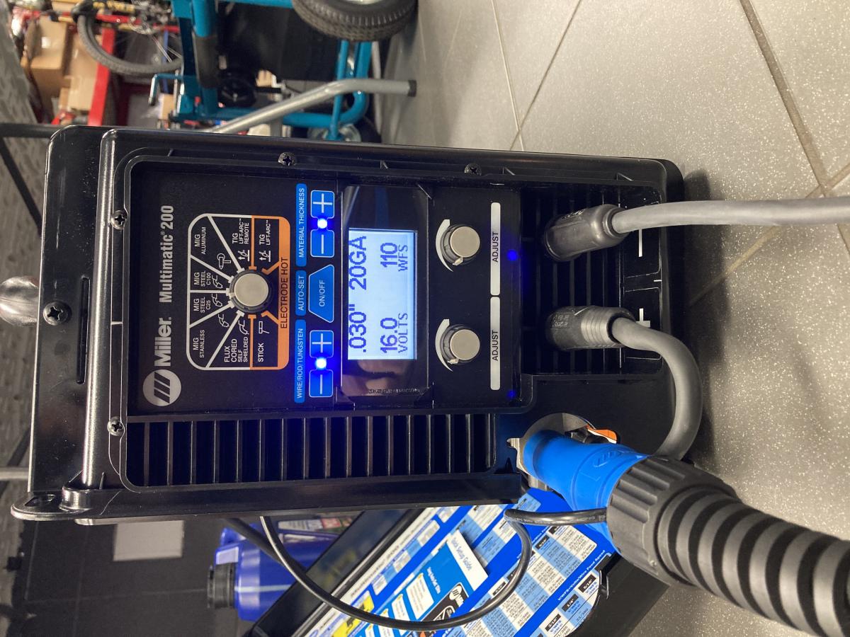

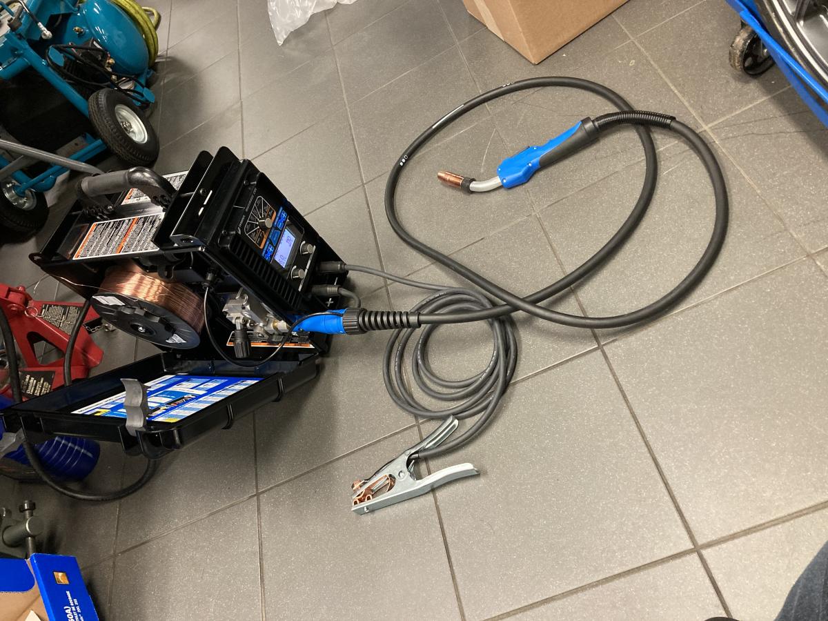

                  Just got a new welder, first time I will try it will be on this RACP job!

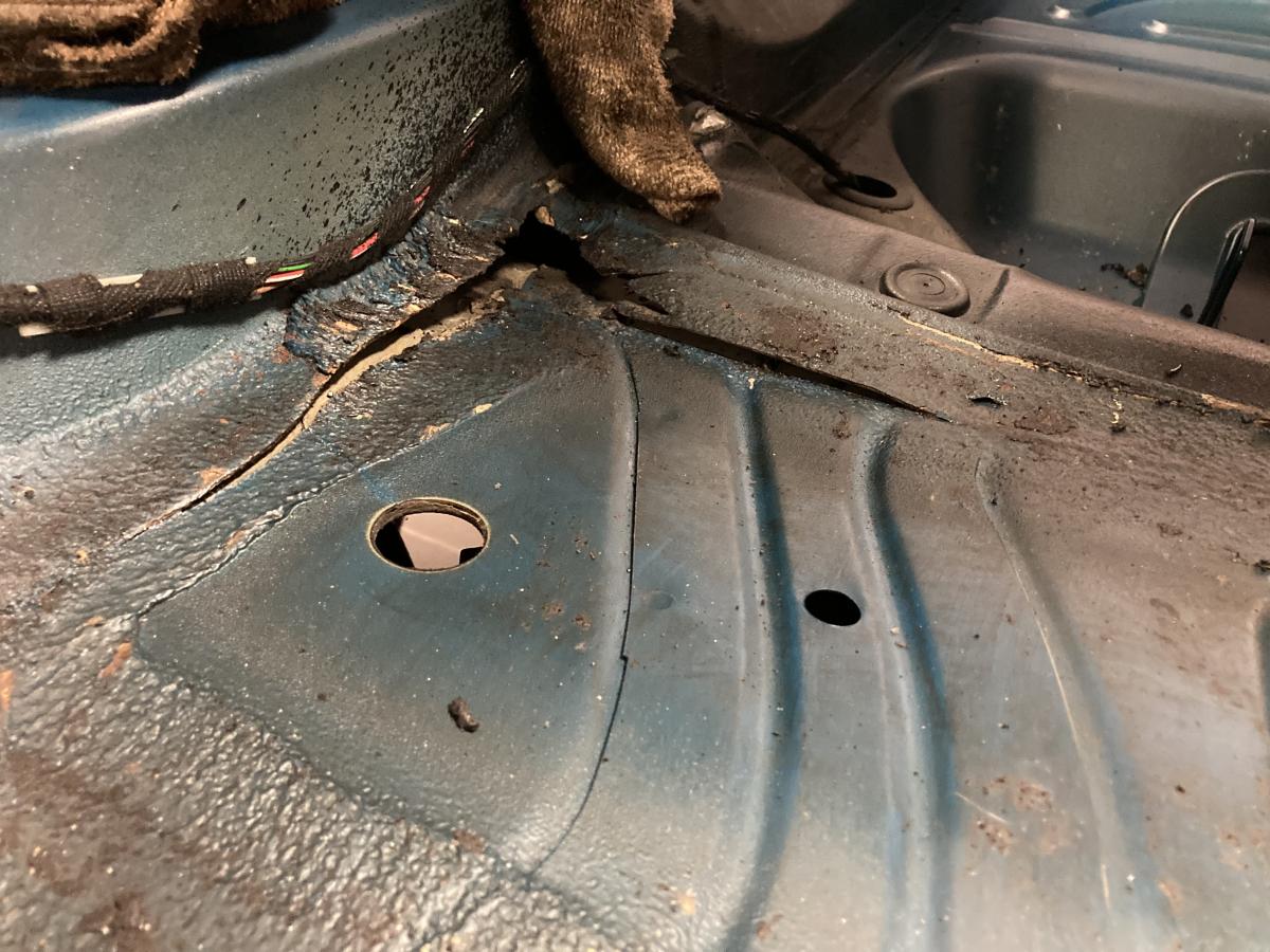

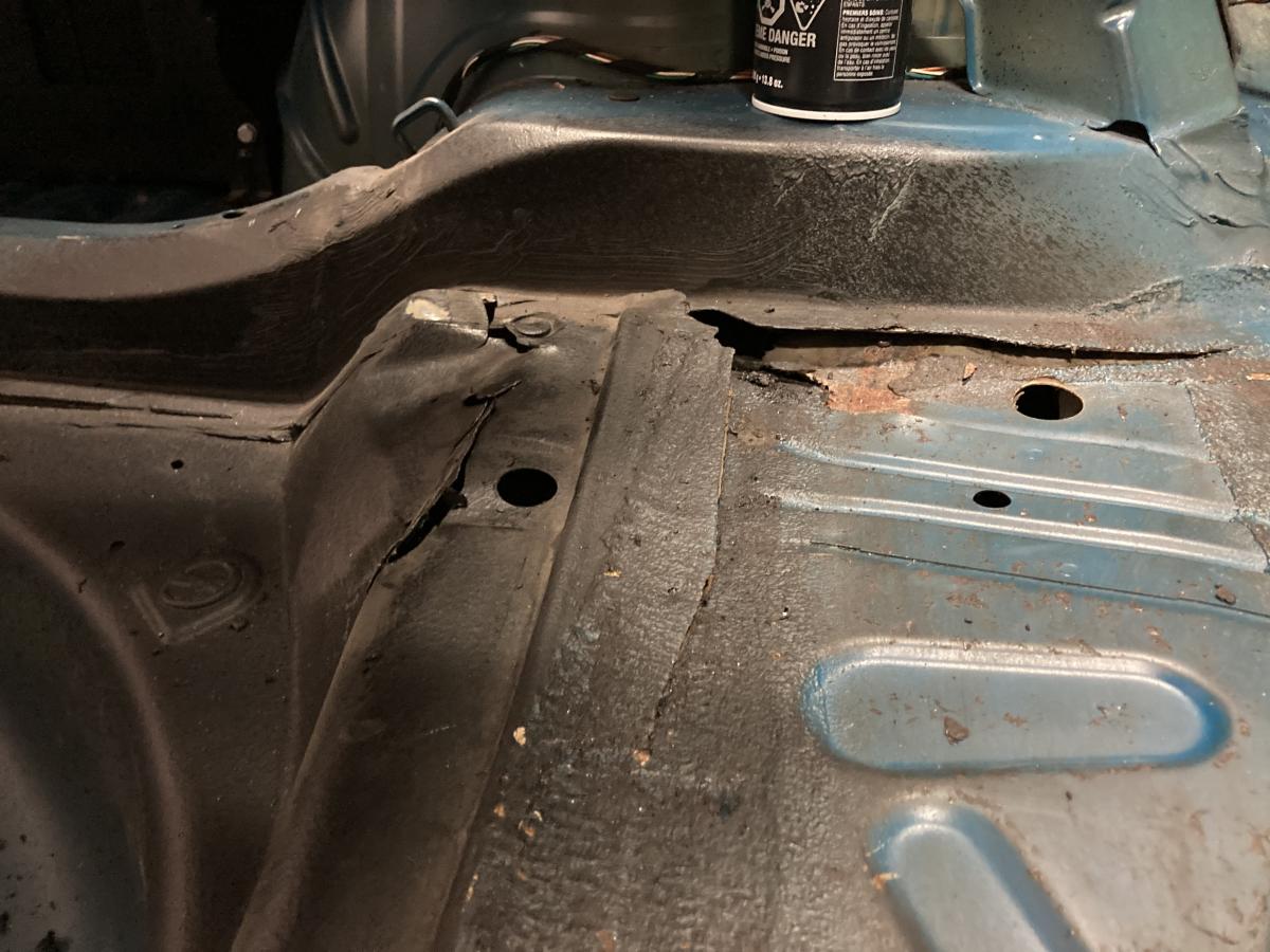

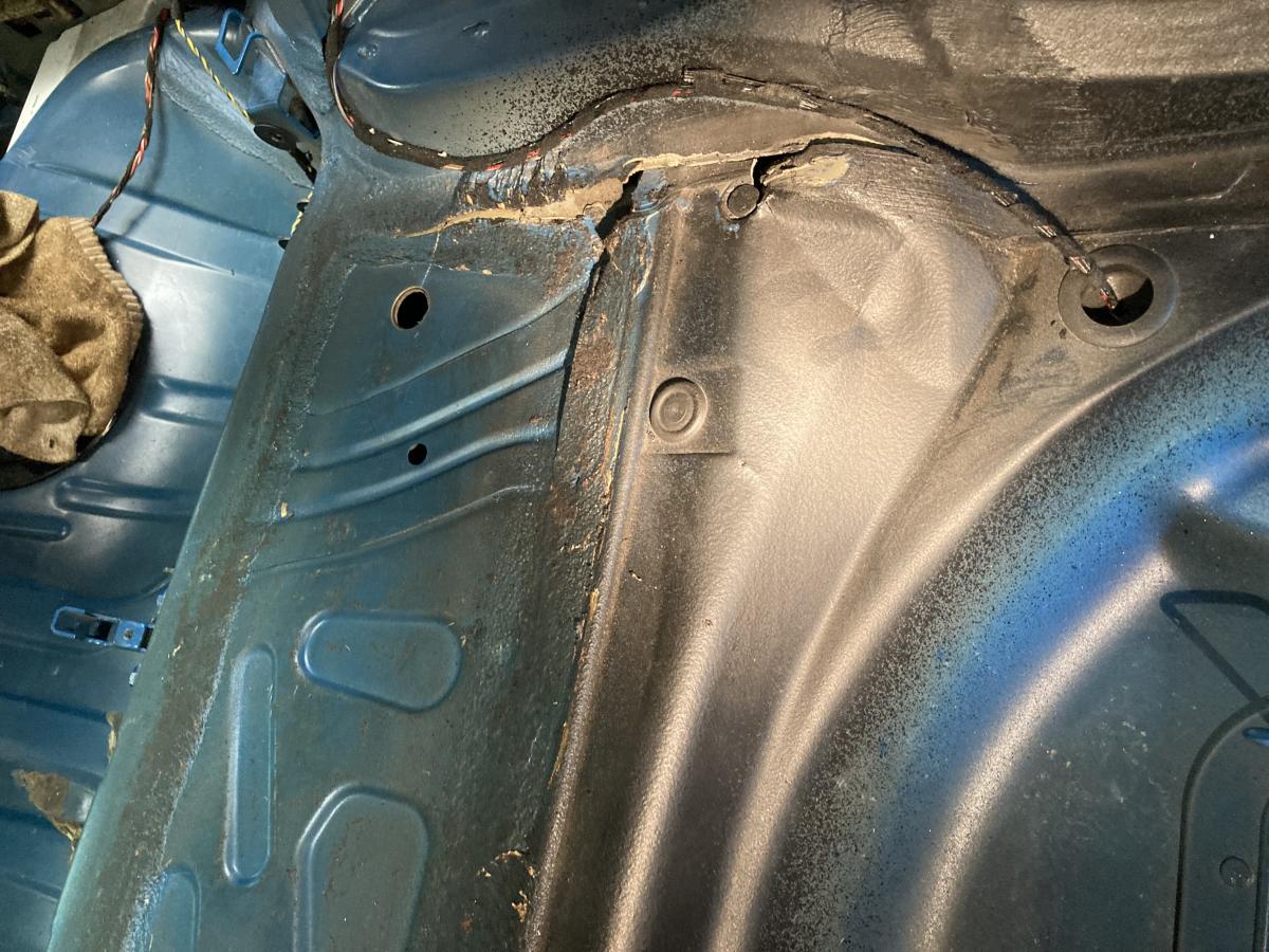

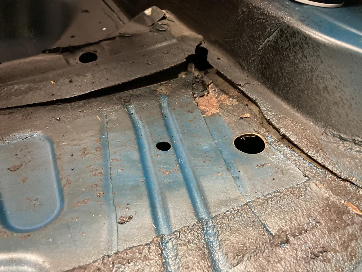

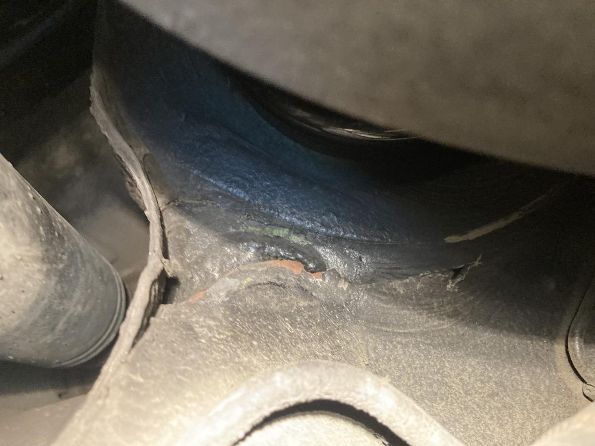

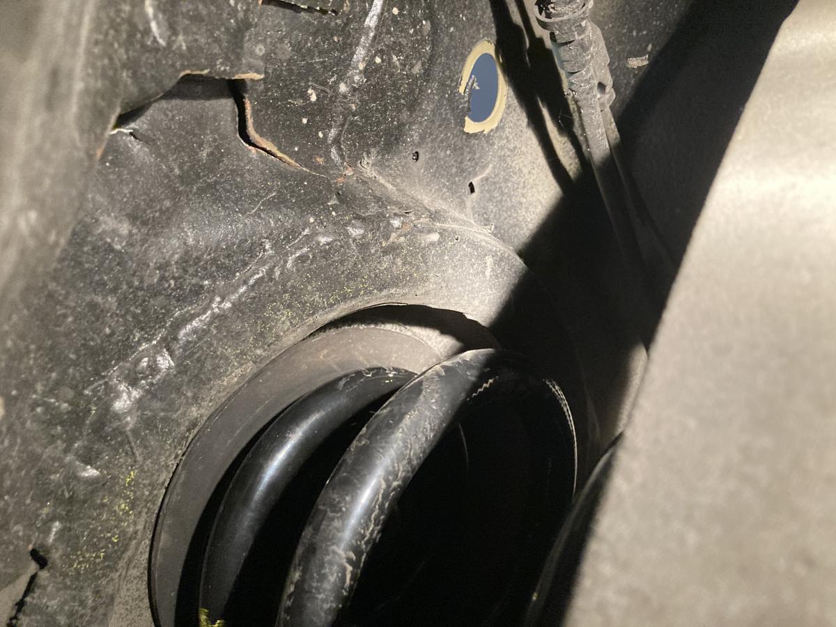

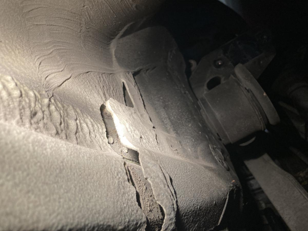

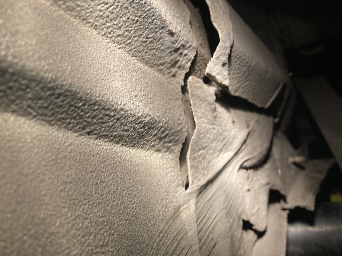

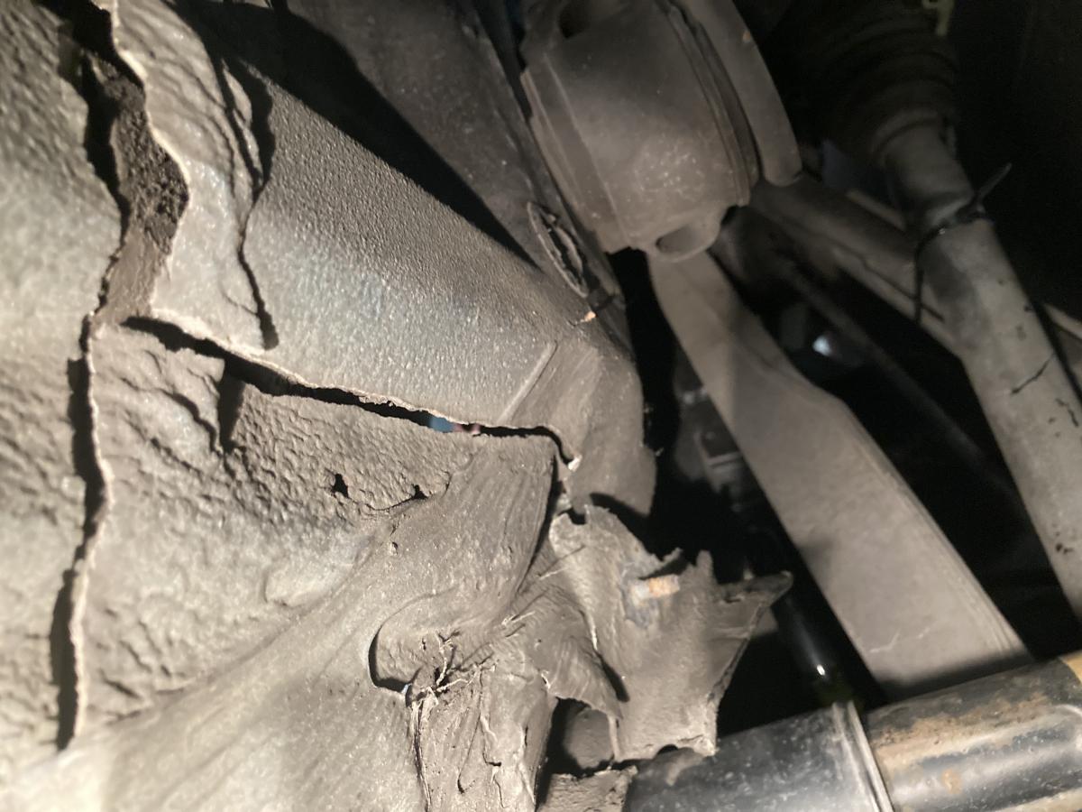

                      Long story short, previous owner went to a local shop for an inspection/quote to fix the RACP and the shop quoted him 10000$ CAD to replace the RACP and offered to buy the car for 8000$ CAD instead!! His friend than contacted me and offered me the car cause he knew I was able to fix it myself and that I would do a complete restauration of the car.
                      Car is a 2001/02 HEA package so one of the first E46 M3 in Canada.
                      The car previously had Turner plates welded. Than, when spot weld start to pop, someone tought it would be a good idea to fix it with undercoating… So problem got worst and it look like this now:
                        #56
                        Ah they probably used regular undercoating instead of the structural stuff. Easy mistake to make.
                          #57
                          I mean they shoot rattle can undercoating, just to hide or seal the panel splitting probably when it first start!

                              Replacing the RACP shouldn’t be that bad. Let say I did bigger projects in the past. Check this thread to see some previous build I made. Doing RACP is going to be easier than stitch welding a complete race car!!!
                              https://nam3forum.com/forums/forum/s...us-your-builds
                                #60
                                Really bad!!!
                                Wow! I'm interested to see how much movement on the diff when moving from stop forward and reverse in current condition, in video
