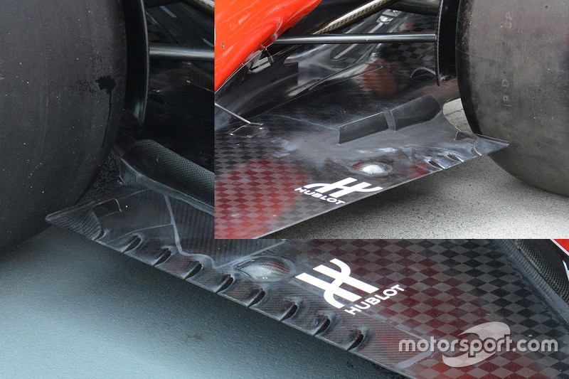

              Werd! Once the roof panel comes in, I’m making mine from a spread tow cloth. It’s the same stuff used in F1.
              F1 doesn’t use a plain 1x1. It’s actually inferior in terms of weight and performance. 1x1 has more tow intersections where a tow goes up and over or under another tow. These spots increase resin consumption which adds weight with no improvement in the performance (stiffness, strength, toughness.
              A spread tow is a higher performing option since it flattens the carbon, reduces the # of intersections and reduced resin consumption. I’ve seen a spread tow composite can be 20% lighter…haven’t verified that. But when you see carbon fiber on F1 cars…it’s a spread tow fabric.

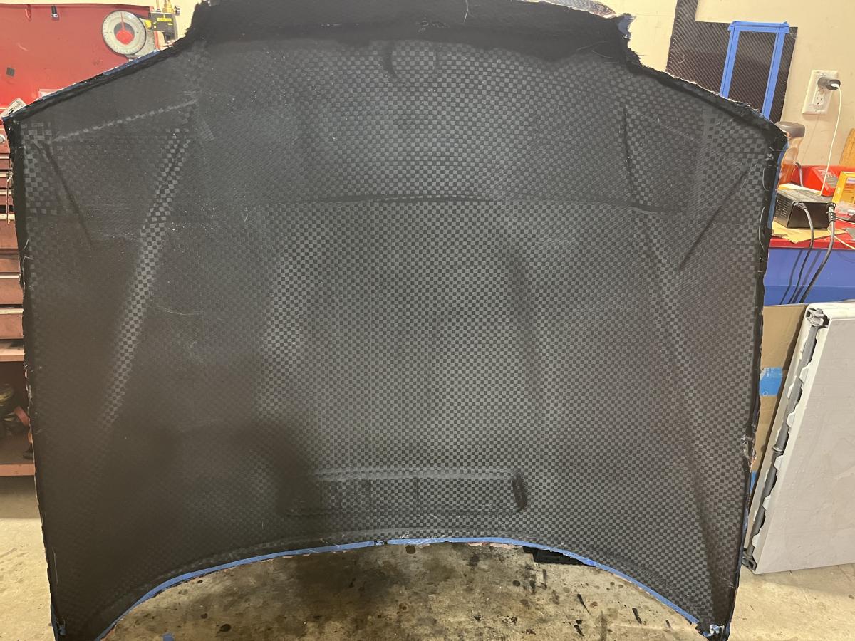

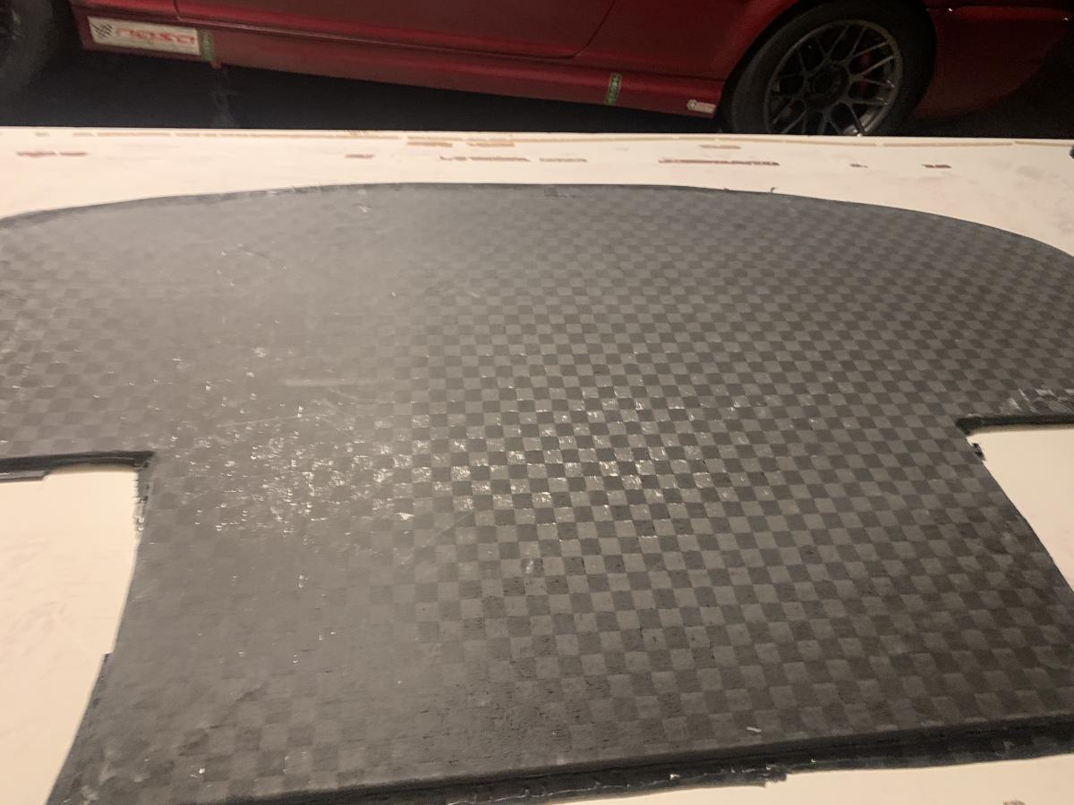

                Can you share what that pattern looks like?
                  It looks kind of like a checkerboard. Probably won’t see it except on higher end custom race cars like a Radical.
                  I have yet to use it on the gloss/cosmetic side but here are some pics…

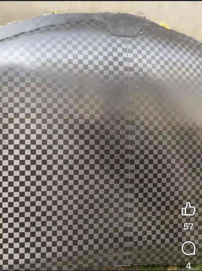

                                Here’s a really good picture. After seeing this I’m definitely doing my roof in spread tow! The seam in the middle kind of ruins the cosmetics but the rest looks fantastic! Just waiting for the damned metal roof to come in.
