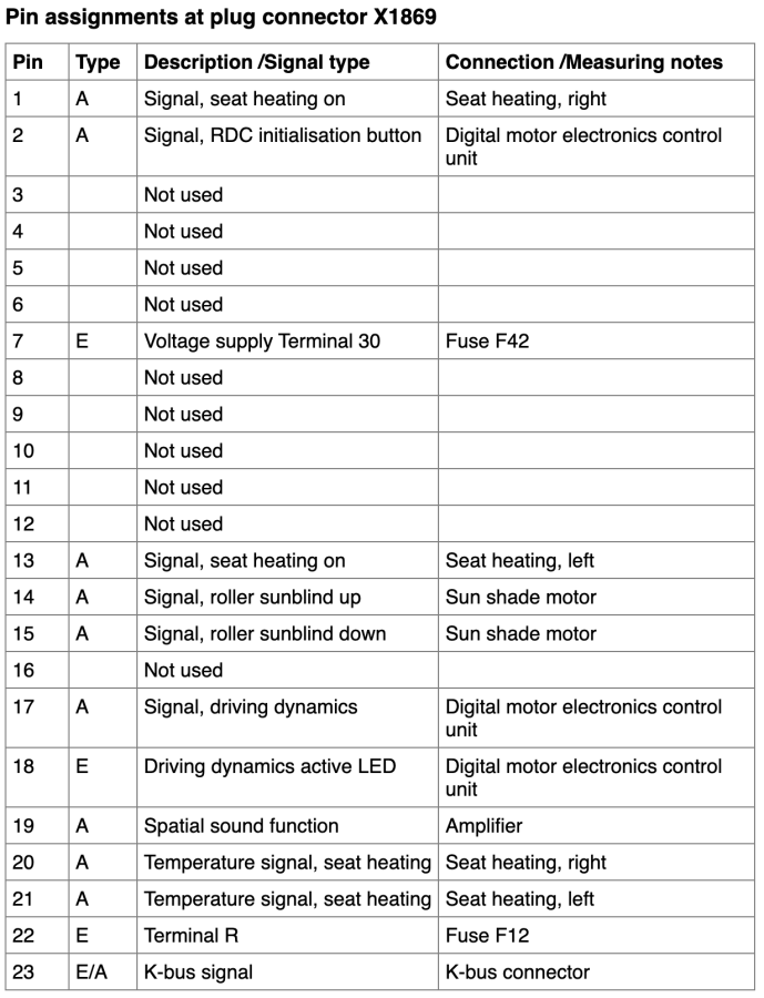

    would it be feasible to setup the i/o button on a zcp steering wheel for sport mode on a non-zcp MK20 car
    MK20 won't matter for this, sport mode is controlled by the DME (and the HW triggering mechanism is the same between non-HP and HP DMEs).
    There's a bunch of different configurations for the switch panel, so lots of wiring diagrams as well. Here's an example one with the sport button labeled (look for "driving dynamics"):
    Click image for larger version  Name:	Screenshot 2025-09-25 at 4.39.29 PM.png Views:	0 Size:	191.2 KB ID:	320627
    IIRC, the button pulls to GND and the DME reacts accordingly. If you emulate that with the ZCP button, it should just work. I would stick a multimeter on the output pin of the button (with everything connected) and see how it's set up. Then do the same on the ZCP trim.

      While completely doable, now I'm thinking this may be more complex than I want to bother with as I'm adverse to tampering with factory wires when avoidable.
      Perhaps I should try this a different way - what happens i slap this on my steering wheel, plug into the one harness female that's on there and do nothing else. I assume I just have a sole i/o button that works as it would before?

          You could build yourself a little adapter harness that taps into the switch center connector, so that you don't have to modify any factory wiring. Although, I do think the female connector is molded into the case for the switches, so you might have to get creative there. Maybe unpin the factory wire and move it over to your harness?
          Alternatively, you could tap into the DME side of things. I got some break out boards made for the X60003 DME connector a while back: https://nam3forum.com/forums/forum/m...384#post112384 You could do something similar for X60004 (where the sport mode wire runs to) and tap into that.
          The button on the ZCP trim has a wire running directly from it to a dedicated input on the ZCP MK60 that toggles M track mode on and off. Regular MK60s and MK20s do not have this extra input pin. Unfortunately, the button won't do anything if you just install it on your car without some custom wiring.

            Appreciate the info that helps a lot. I think this may not be worth the effort for a button. Quite a few times I almost purchased a zcp wheel and never thought about the fact that the button would be useless.
            Looks like it may be easier to just go with a full button delete like Avedis has shown here
