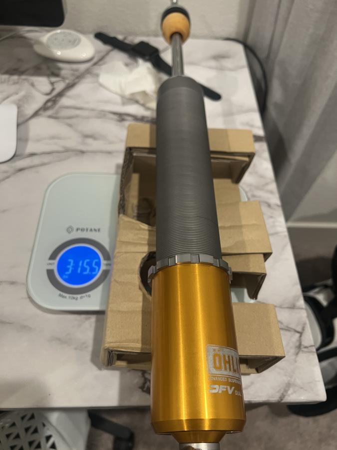

                    Ohlins:
                    ​Click image for larger version  Name:	IMG_8618.jpg Views:	0 Size:	53.7 KB ID:	276286
                    Click image for larger version  Name:	IMG_8620.jpg Views:	0 Size:	63.1 KB ID:	276287​

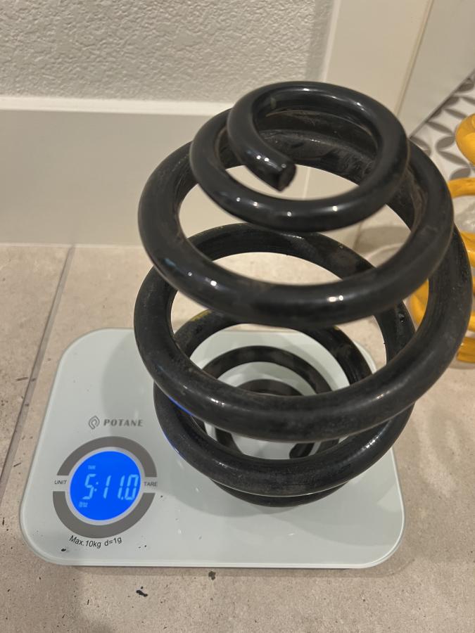

                      Stock front:

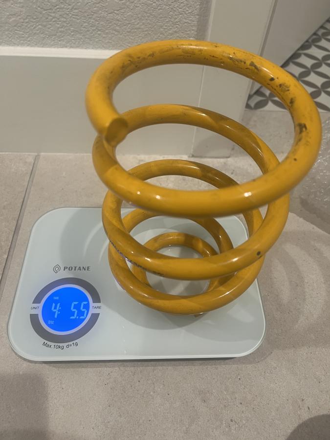

                      ​vs Ohlins front:

                      Nice to see a big decrease in weight in the rear, although there's also an adjuster added. I suppose I shall weigh that as well and edit this post.
                      The front weight is significant though. Will need to change that.

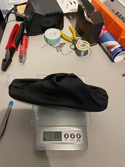

                        Leather handbrake boot: 88 grams

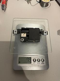

                        Bluetooth Antenna + bracket: 79 grams

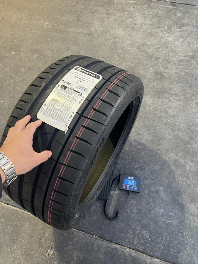

                          Anyone ever weigh tires? I was curious as to manufacturer specs and their accuracy. I just bought continental ecs 02 and grabbed some weights before mounting.
                          Front manufacturer specs:
Name:	Screen Shot 2024-11-18 at 7.17.35 PM.png
                          and the actual weight...25.3lb

                            #43
                            One burnout and it should lose that gram, easy.
                            Continental has 24.2 F and 24.5 R. Manufacturing process isn't perfect, so some minor variation in tire weight is probably expected. Something similar being discussed about bicycle tires - https://www.vitalmtb.com/forums/hub/...ight-deviation
                              #44
                              interesting insight and good point ! I should have weighed all 4. I'll have to weigh the whole wheel & tires to see the differences.
