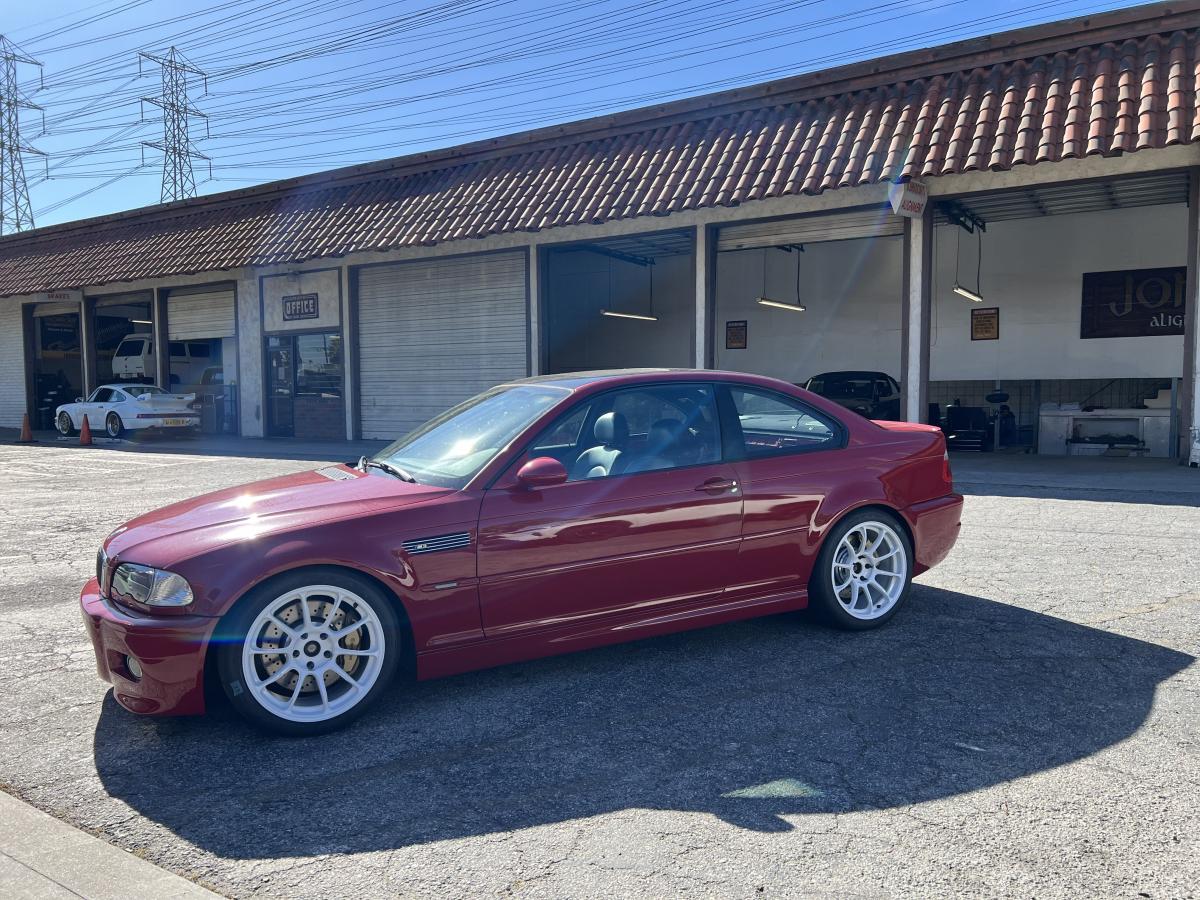

      Had my car at the alignment shop today, they set me up with a baseline of -3.5 front -2.5 rear, 0 toe all around, and also fixed a stripped RTAB with a Time-Sert. The car feels good, drives and stops straight. but it does not sound good lol. There’s something clanging around on the back end. I don’t know what it is and the guys at the shop didn’t see anything egregious. Gonna have to wait until Wednesday to put the car back on the jacks and see what it is, and to button up a bunch of odds and ends.

          Lookin good! You sure about that 0 toe in the rear? Usually, there is supposed to be some rear toe-in for stability.

              Is that Johnson's alignment by any chance? If so, I live real close to there in Redondo!

                    Yup that’s the place. I won’t be going back though. I didn’t appreciate Steve’s crotchety boomer attitude, and he didn’t listen to me when I told him things about the car and the setup over and over. He charged me almost $200 extra to align the front because I have KWs, and the top mounts are admittedly annoying to work on due to the placement of the bolts. But I installed them myself, and therefore I know it’s not that hard to drop them, adjust, and raise them back in, check and repeat.
                    I asked for a print out of the actual final alignment and he gave me a photocopy of a piece of paper where he had simply hand written -3.5, -2.5 and 0 toe in. 🤣🤦🏻‍♂️
                    I think they do good work but they clearly don’t want my money or any of my friend’s money.
                      Thanks! I prefer to start my cars with neutral toe, and drive the car for a while, see what it needs. I’ll be back in a different shop for corner balancing after I finish some other issues on the car and have the weight finalized.

                                So I got under the car, there’s nothing wrong, nothing loose, tbh I think it’s the new PowerFlex poly front diff mount making a SHIT LOAD more noise in the cabin. It’s gotta be that plus the fact that I removed the sound deadening. I did also do CMP solid subframe mounts, not sure how much a role those are playing.
                                I knew I was doing some questionable stuff, and yes I did read all the threads I could find. but I didn’t imagine it would increase the NVH THIS MUCH. I suppose I’ll have to just live with it for a while, until I feel like doing a big pain in the ass job to swap that out, but I feel kind of annoyed at myself for going against the sage advice of the e46 elders and proving them right yet again.
                                FWIW My old mount was also poly but it was way quieter. I still have the same older poly mounts on the rear of the diff cover. I had to replace the front because I ended up having to replace the entire subframe due to uncovering negligent past repairs, and the old mount couldn’t be saved.
