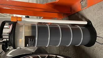

                              Your life will have changed for the better. Oil changes are an absolute breeze with this thing!
                              Well, I was surprised, I am sure I pulled everything out. Maybe 150-200ml left inside?

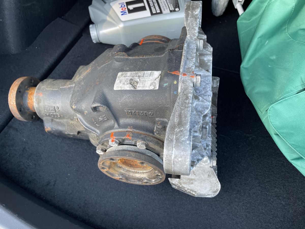

                                I also scored a used diff which will be rebuilt with my 4.1 crown and pinion and the racing diffs diffs kit. Does 350 sound like a good deal?
