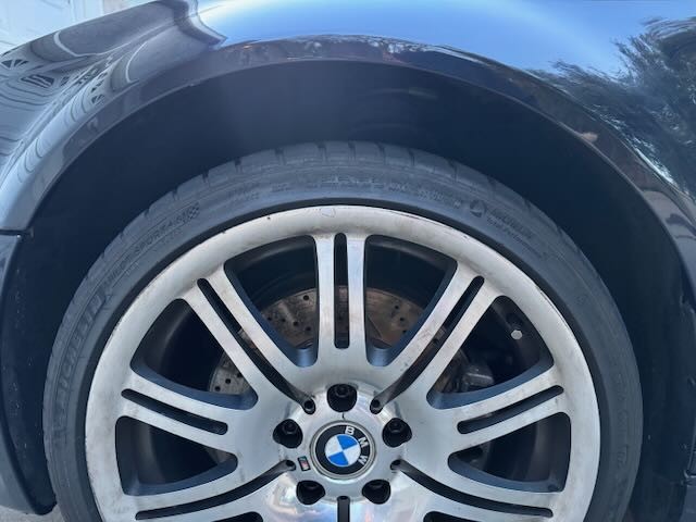

      Stock Sachs front Struts, bump stops, bearings, and spring supports done. Front is sitting a bit high at this moment ๐Ÿ˜‚
