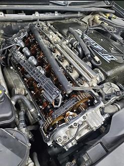

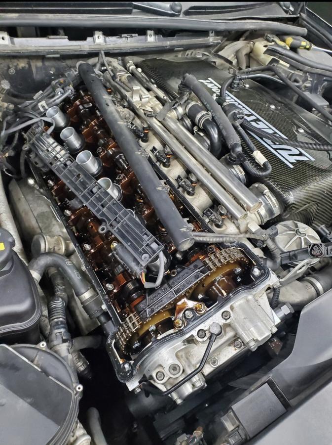

    These items next and there's a Karb trunk somewhere in the back. Busy, busy on the M3 exterior and intake.

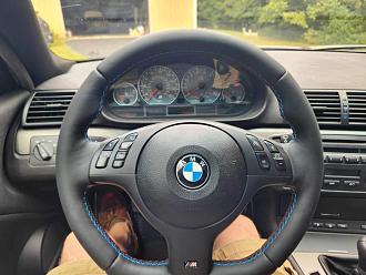

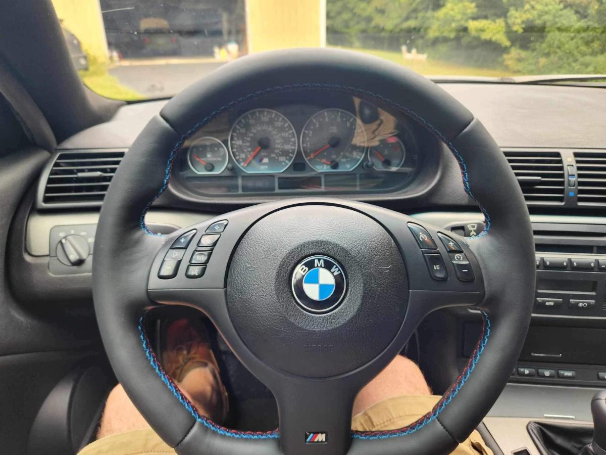

                Swapped out the steering wheel for a refurbished flat bottom wheel
                . Click image for larger version
ID:	279322 Click image for larger version

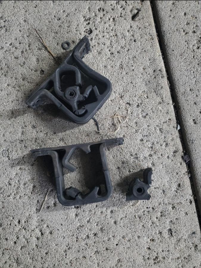

                            So 2 things: put in an elring valve cover gasket, ended up leaking after 50 miles, terrible quality. Stuck in an OEM one and now perfect. Also had the section 2 hitting the cross brace on acceleration so come to find that the muffler hangers were fudged:

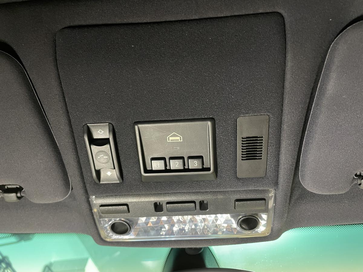

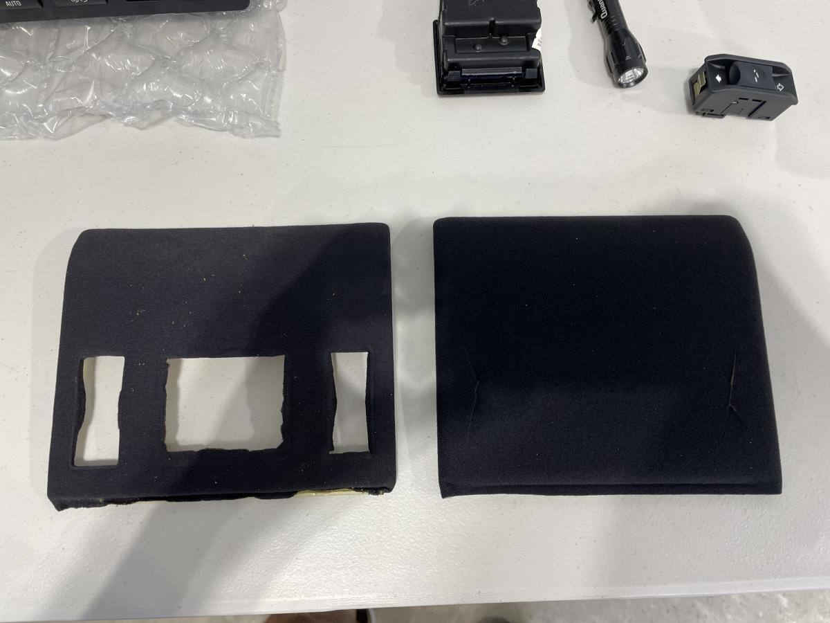

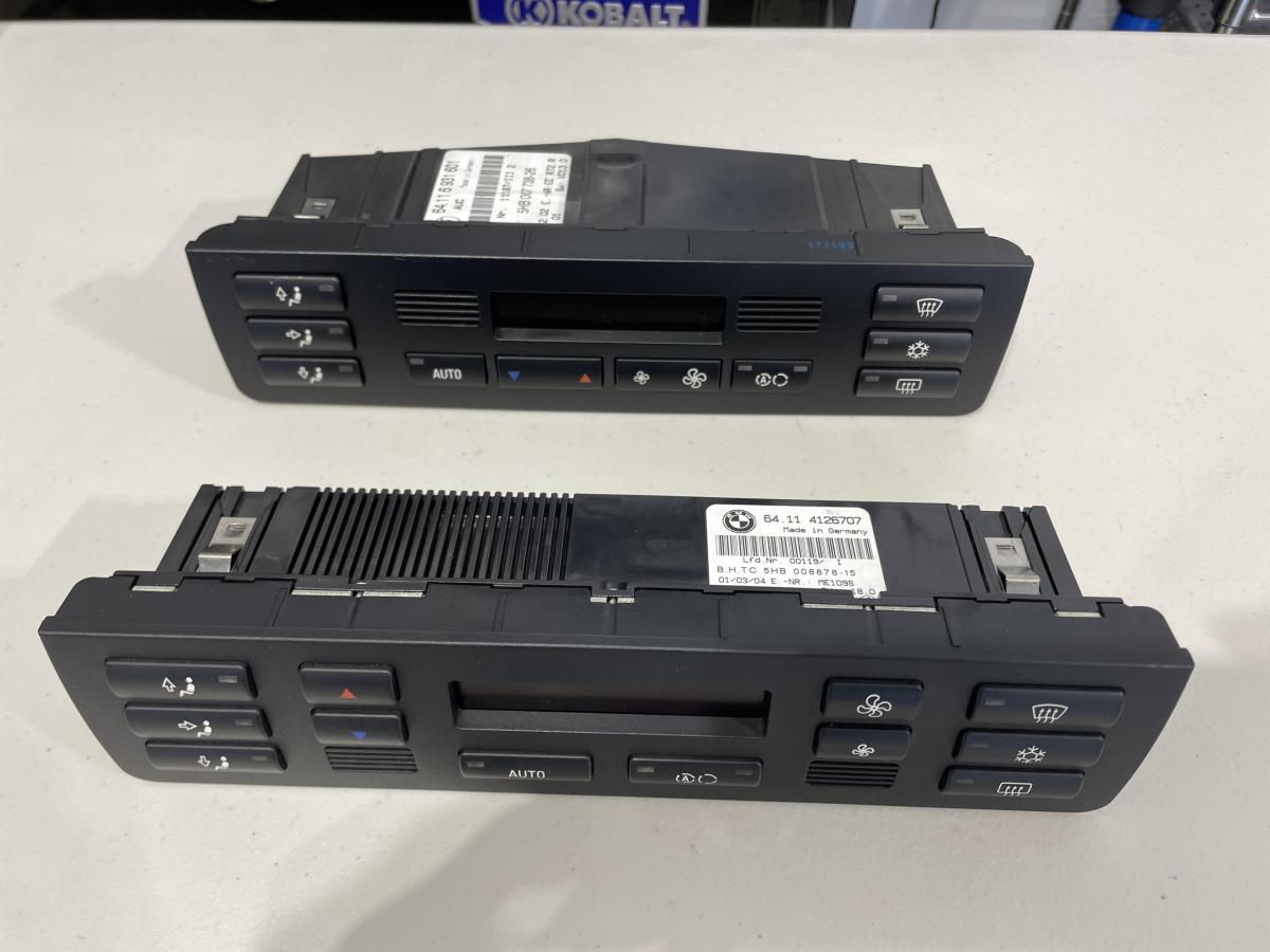

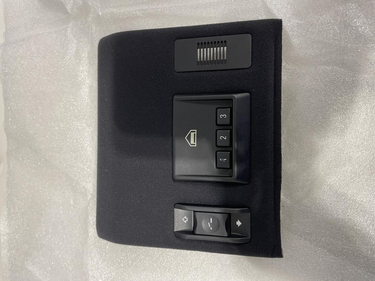

                              Two things today:
                              1] New overhead console cover after having found that during installing my -338 microphone for the BlueBus, the fabric was falling apart and the foam was basically "not foam" anymore.
                              NOTE: This panel is still super inexpensive so don't think twice about replacing it if yours is shot.

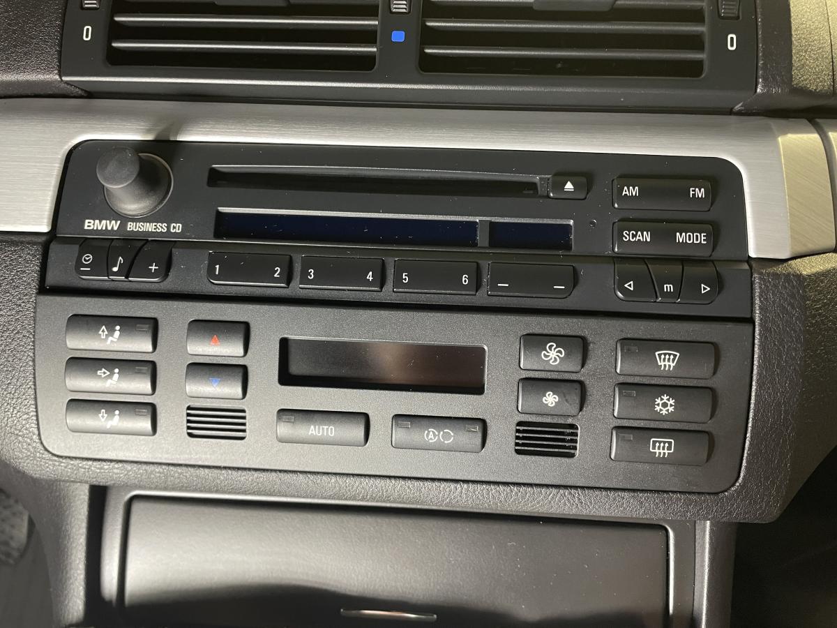

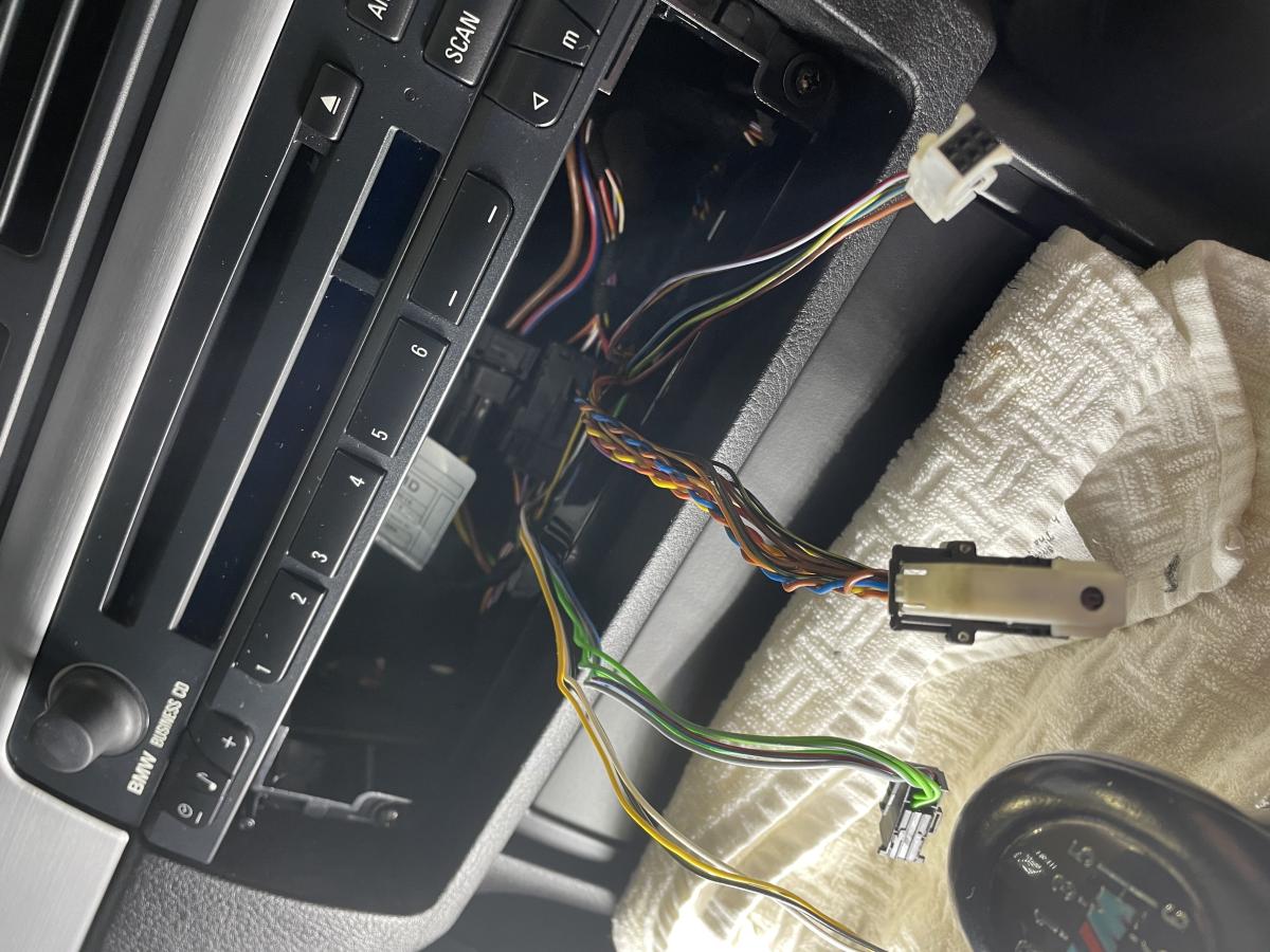

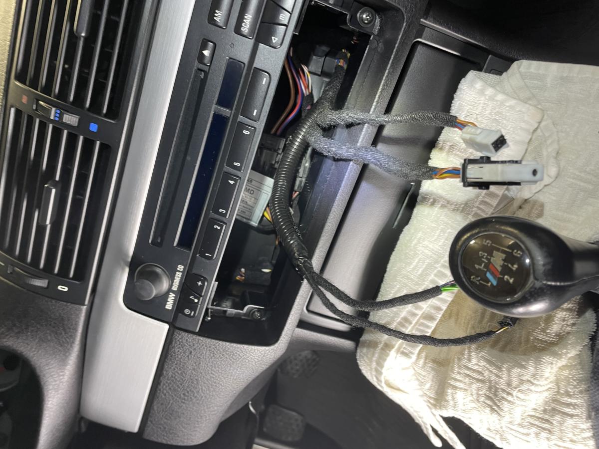

                              2] Later model IHKA unit upon Ted's (BlueBus) recommendation due to the original (older) unit randomly turning off when multi-blink turn signals are enabled using BlueBus. Also took the time to re-wrap the wiring with fresh TESA cloth tape as the original cloth tape had fallen apart (had to cheat and use some HF loom since I couldn't quite reach it all and wanted that wiring protected.
                              NOTE: I sourced my unit from eBay and while the front panel is near flawless, the temperature sensing circuit on the board was horribly filthy, so I disassembled and cleaned it, along with the little fan (I should have taken before/after pics). Anyway, for those wanting to remove the front panel of the IHKA, you need a T6 torx bit.
