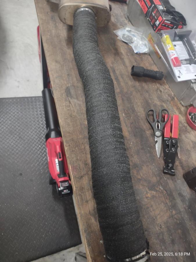

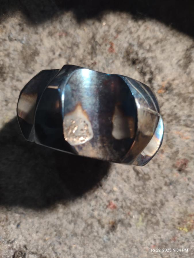

                              Refreshed (clean & regrease) the rear axles. Needed to replace the driver's side inner CV joint as it apparently overheated (nice blue tint) causing pictured damage. To help, I heat-shield wrapped the exhaust pipe which runs directly underneath the driver's side CV joint. Fingers crossed.
