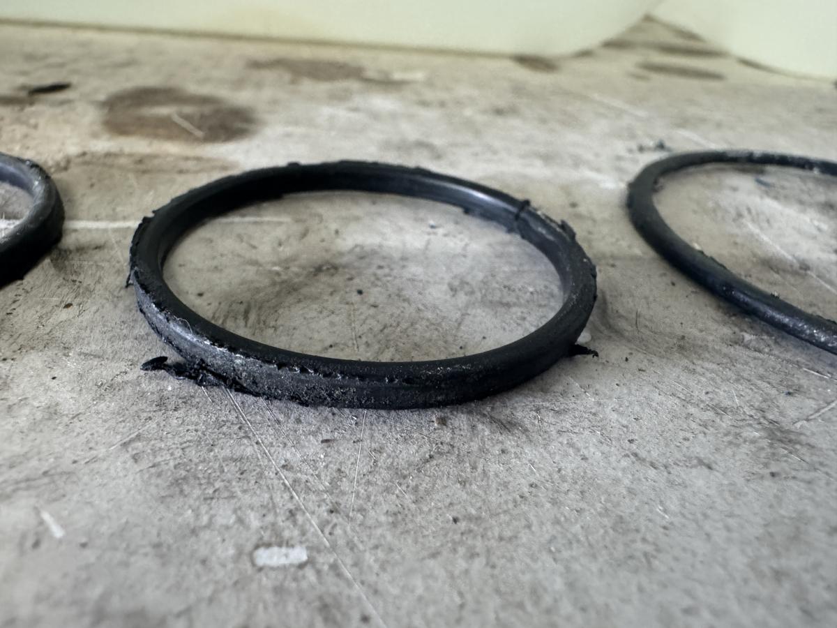

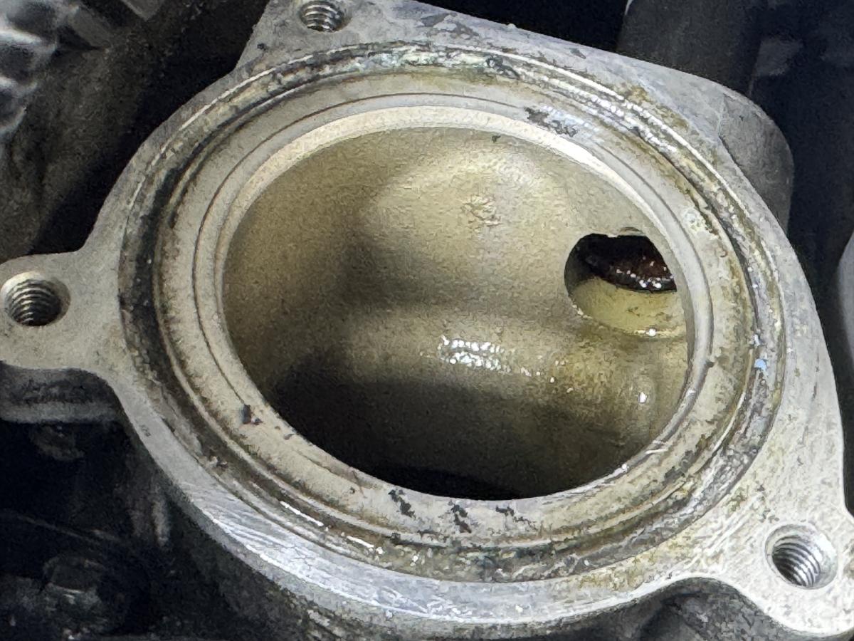

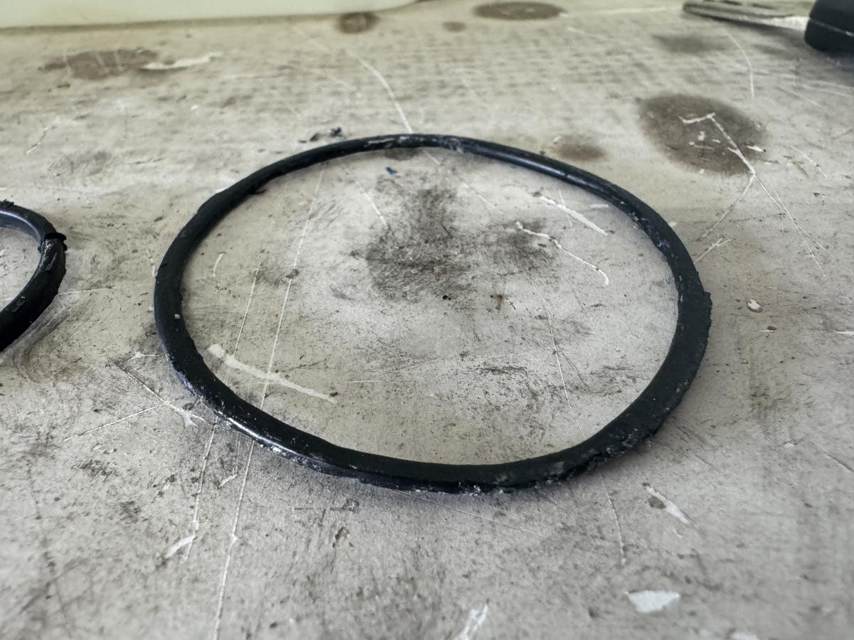

      Coolant flush, thermostat, gaskets, and coolant hoses replaced.

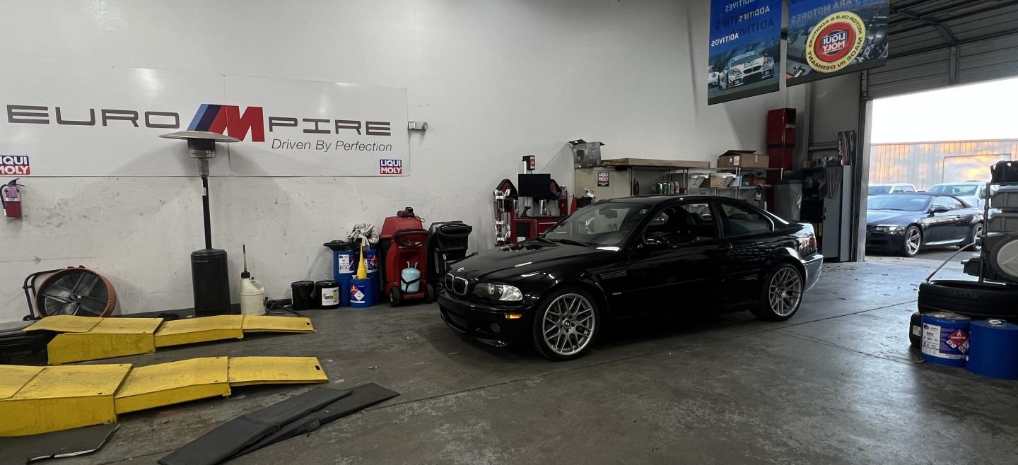

            After a year of meticulous planning and research, the car finally arrived at the shop for RACP reinforcement and major suspension overhaul.
            Many thanks to Matt at Eurompire in Charlotte, NC for all of the coordination and efforts the last few months. he’s been great to work with!

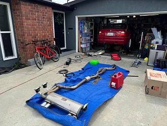

                    Some context: I did a big refresh, modify, and RACP repair over a year ago, but we had to move abruptly so I never really got the car done. I got it just done enough to move, then life happened, and now after a year long time based art project / paint torture test, I have some time and motivation to pick things back up.
                    Dropped the exhaust and got the driveshaft out today. I ended up with a concerning clunk after the whole rear end job, and today I believe I have found the culprit. The CV joint on the end of the driveshaft seems to be toast. I’m going to clean it out and check to make sure but maybe you guys can chime in. Trying to get a sanity check about this amount of movement / play. (I did find some little metal shavings / remnants of some sort in there as well which I feel is a pretty tell tale sign that shit’s fucked. Also, crucially, the gasket that’s supposed to be there, wasn’t.)

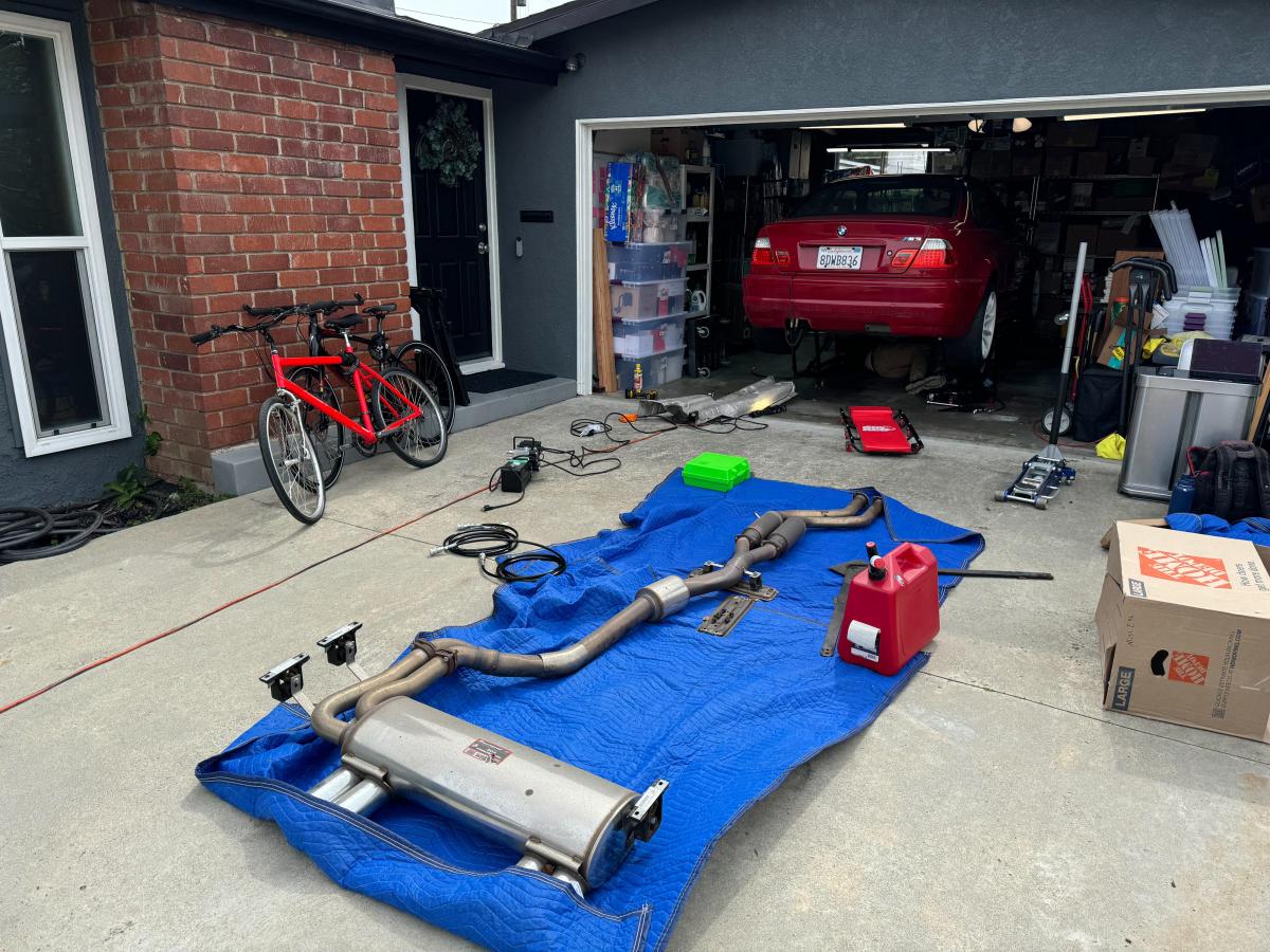

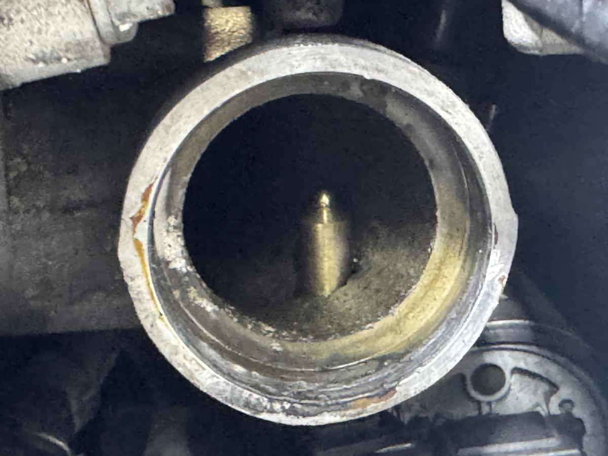

                      If you remove the snap ring you can clean up all the grease with a towel and have a better look at any potential damage. If that truly is a metal chunk it isn't a good sign. If it looks and moves fine you can order a new boot with grease but normally it is supposed to move more freely.

                        I’m going to open it up and take a look, tbh I don’t really know how much movement it’s supposed to have. I’ve never handled a healthy one.

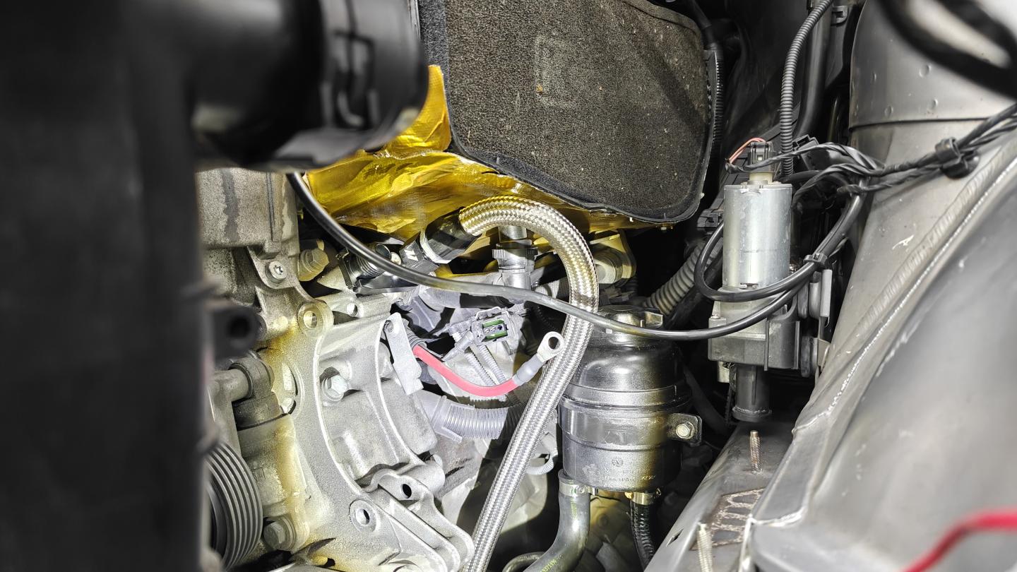

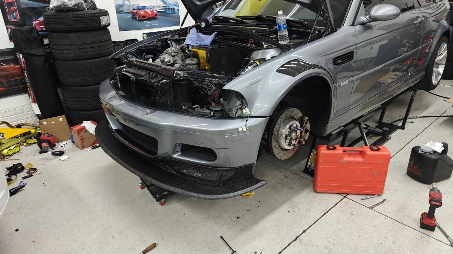

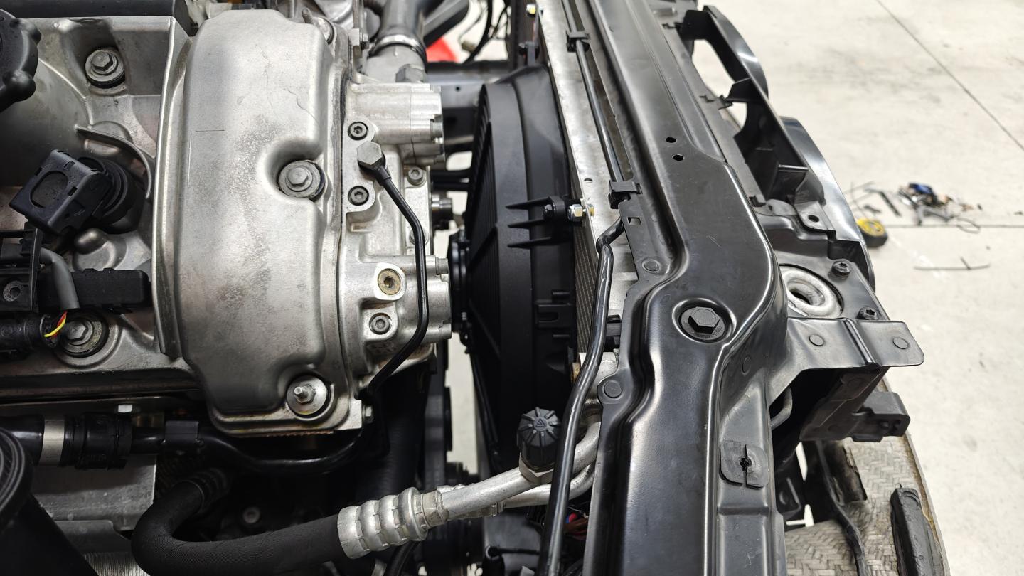

                            It's been a process the last few weeks and I'm almost done. The rogue oil cooler required the ac condenser to be shortened thanks to dsm metal it appears to not be leaking 🤞. The new mishimoto oil lines also came in handy as the custom one I had built wasn't going to fit under the csl intake. Thankfully mishimoto makes a clamp for their oil lines and I was able to use the stock mounting location on the back of the power steering pump with some modification.
                            The new spal fan was pretty straight forward
                            As with my ZHP the new AAF brake cooling required modification to the ac dryer lines but that typical and the lower fender liners.
                            The splitter and lip were also quite a chore as they don't really line up well with the bumper. Some fender washers for backing and two men pushing to sandwich the lip and bumper while setting the rivets did the trick.
                            Hopefully today I get the oil lines done and get to start the beast!
