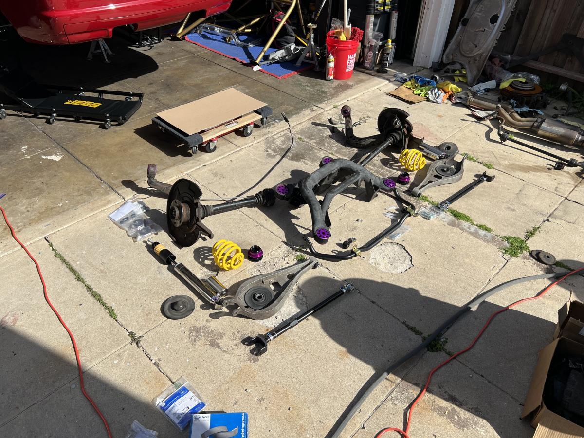

      Got the rear end and a lot of the suspension in yesterday.

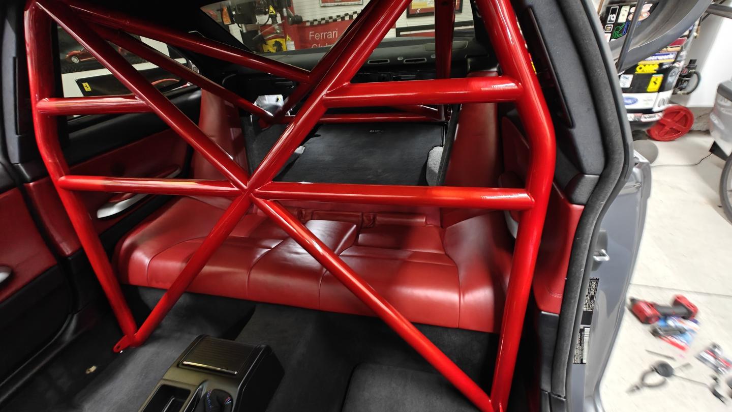

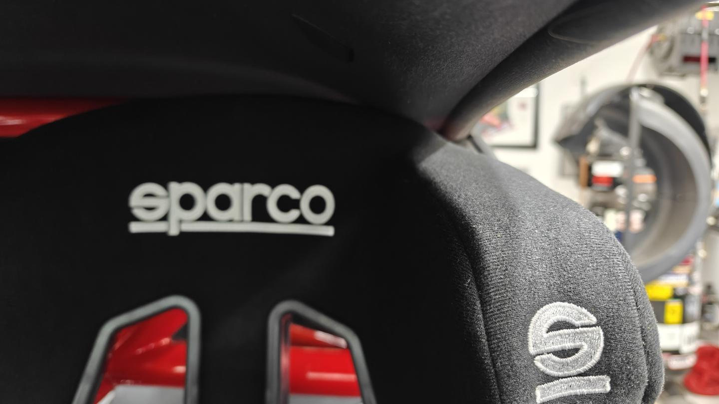

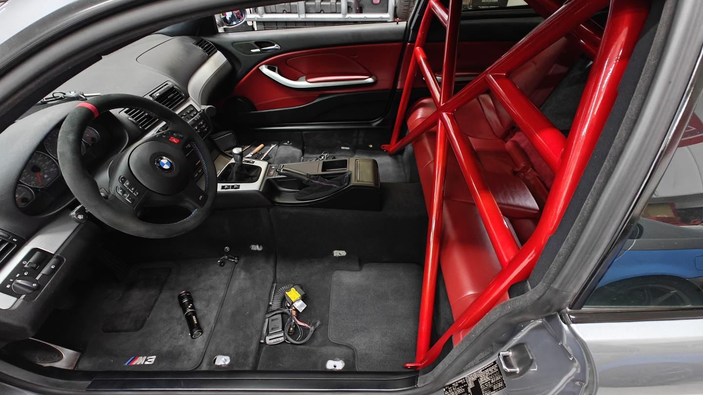

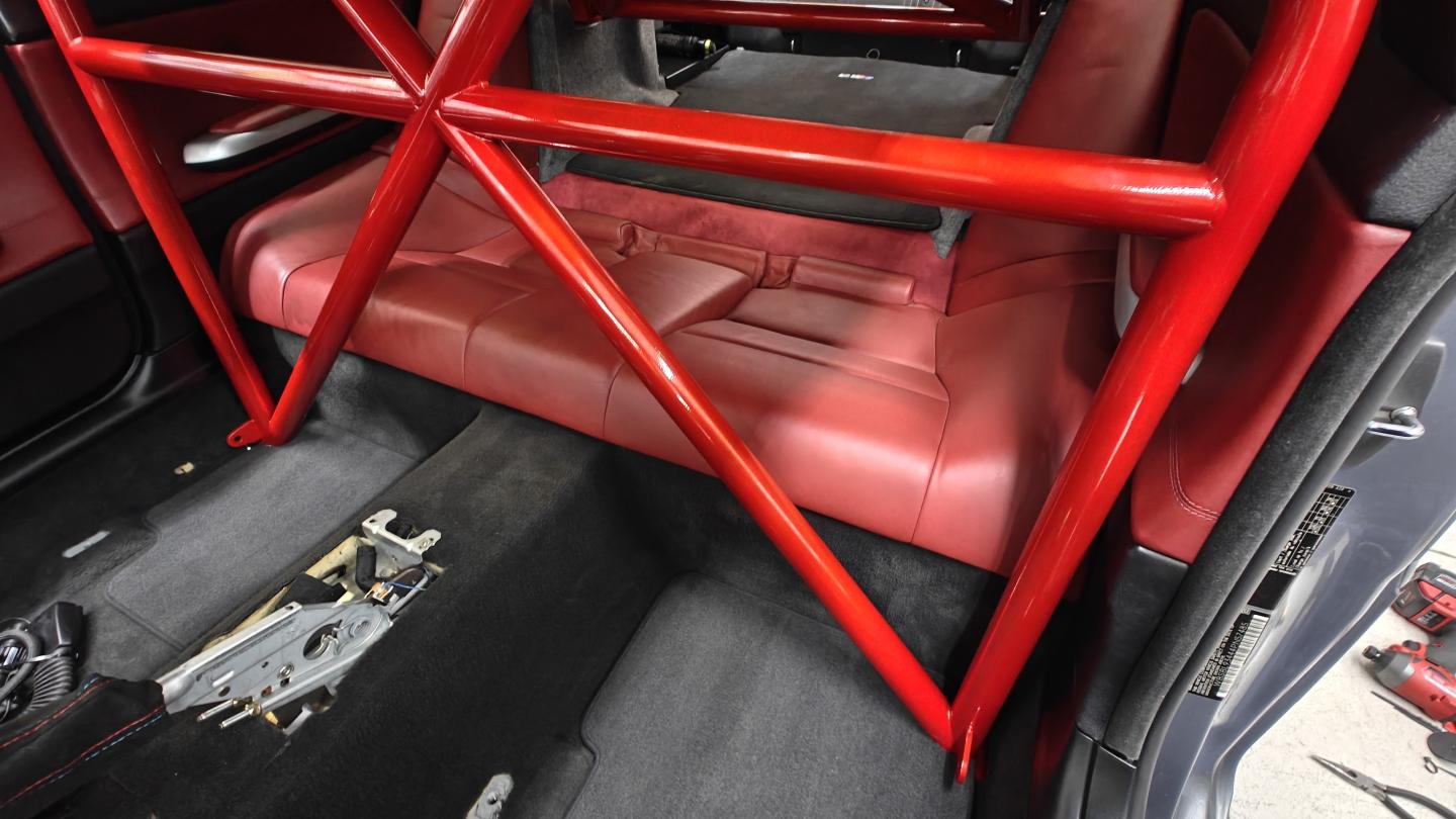

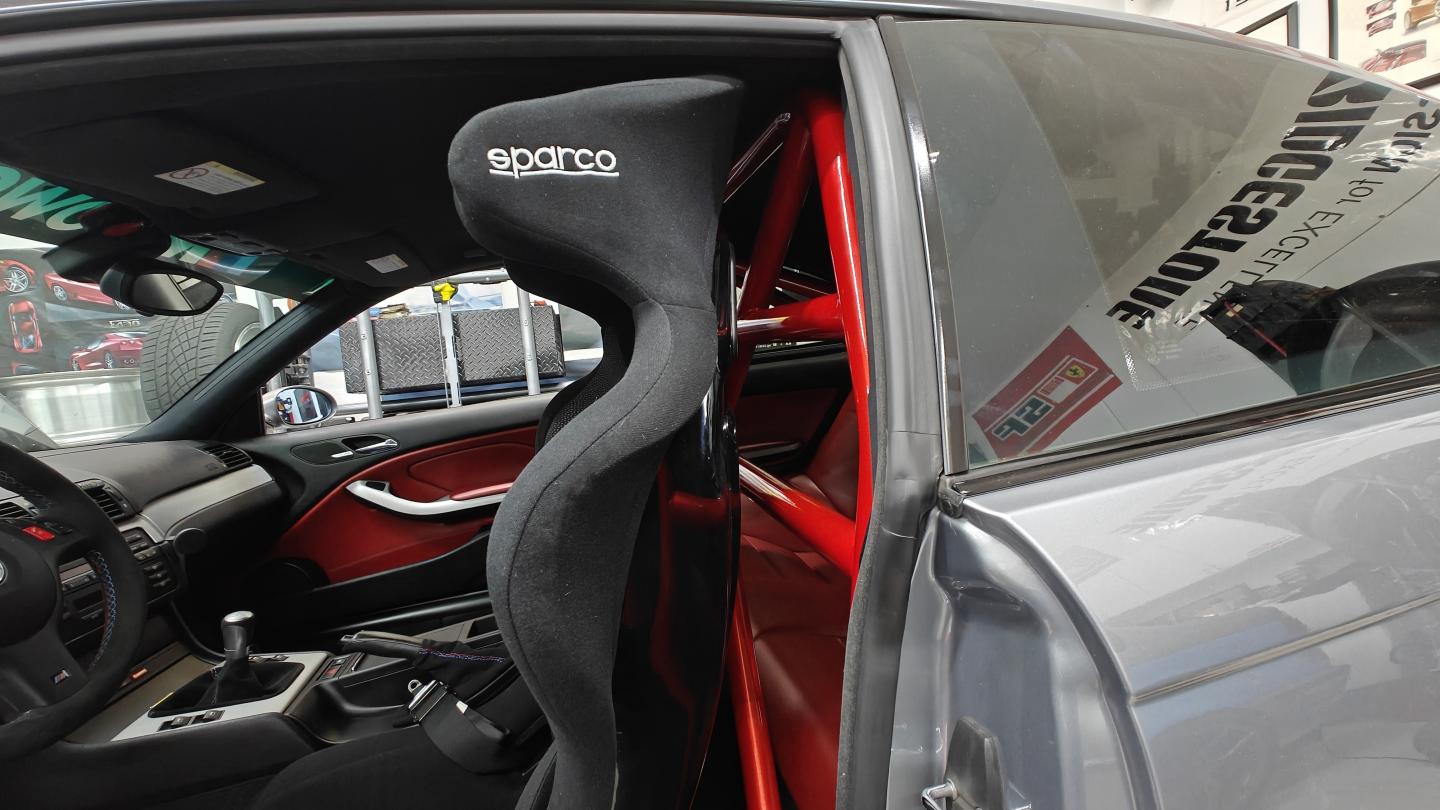

          Finally got the Fall Line Motorsports bar back from iND and put it in the car!

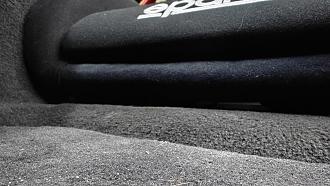

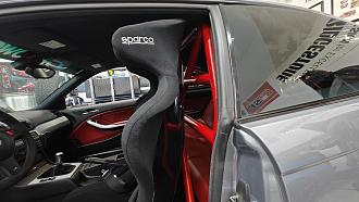

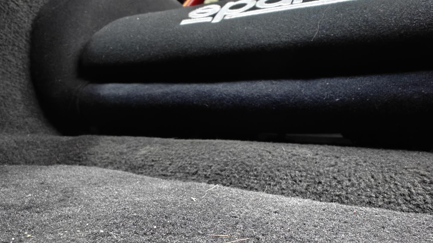

            To say the sparco pilot barely fits would be an understatement! This is with it as low as it will go on the Mounts, obviously no slider, and with the euro headliner without the bump. Tall guys have it rough, still don't wish I was shorter though 🤣
              Wernd if you wanna trade cars mine has an extra few inches not running a headliner.
                Does it mount bolted to the floor or to the seatbelt mounting points?
                '01 M3, Imola/black
                  Three holes drilled into the car each side. It's an exact fit so some of the seam sealer BMW has at the joints needs to be razor bladed and removed. For instance where the b Pilar meets the floor or the back seat panel meets the floor. At least mine did for the bar to sit all the way down on the floor.

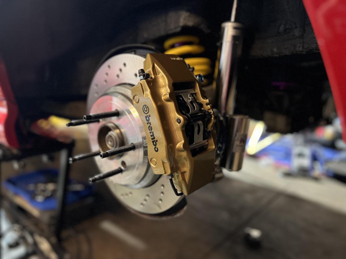

                    Rear brakes are all in, driveshaft back in, dangerously close to being drivable 😳

                    Things that are left are basically heat shields, put the exhaust back on, bleed the brakes, and then do the final torque on everything at the right load. Then I just need to throw a seat in it and creep over to the new house lol. Luckily it’s literally 2 minutes down the road.

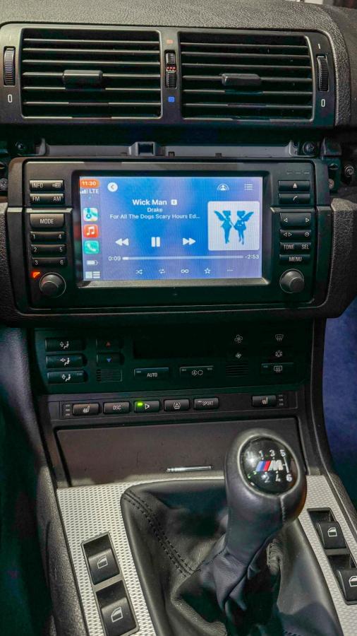

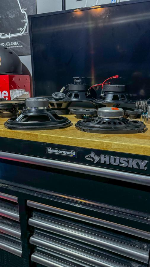

                                Yes, there is a way! I just completed upgrading the stock AMP, HK sub speakers, and all remaining HK speakers. I aslo integrated full touch screen carplay to the oem navigation HU.
                                So there is a stage 2 oem amp upgrade available that boosts the stock amp to 50 watts. You have to send the stock amp out to the UK so they can modify it. Kicker makes direct replacement speakers that drop into the HK sub basket and uses the exact same connections as factory. All of this is essentially plug-n-play drop in and there is a significant upgrade in sound.
                                Kicker vs OEM HK Sub Speaker
                                Click image for larger version  Name:	IMG_5550_jpg.jpg Views:	0 Size:	69.5 KB ID:	255767
                                OEM Navi HU with touchscreen & fullscreen carplay.
                                Click image for larger version  Name:	IMG_5610_jpg.jpg Views:	0 Size:	75.6 KB ID:	255768
                                Kicker Speakers inside the oem HK sub basket...
                                Click image for larger version  Name:	IMG_5556_jpg.jpg Views:	0 Size:	103.8 KB ID:	255766
