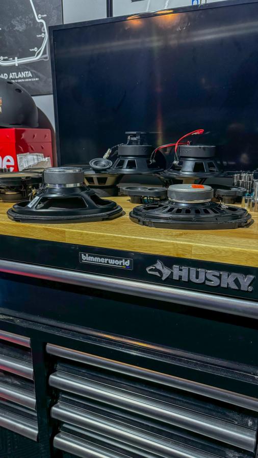

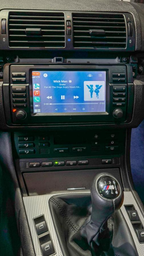

    Yes, there is a way! I just completed upgrading the stock AMP, HK sub speakers, and all remaining HK speakers. I aslo integrated full touch screen carplay to the oem navigation HU.

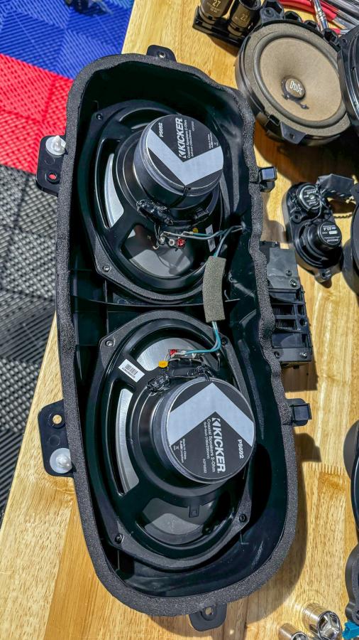

    So there is a stage 2 oem amp upgrade available that boosts the stock amp to 50 watts. You have to send the stock amp out to the UK so they can modify it. Kicker makes direct replacement speakers that drop into the HK sub basket and uses the exact same connections as factory. All of this is essentially plug-n-play drop in and there is a significant upgrade in sound.
    Kicker vs OEM HK Sub Speaker

    OEM Navi HU with touchscreen & fullscreen carplay.

    Kicker Speakers inside the oem HK sub basket...

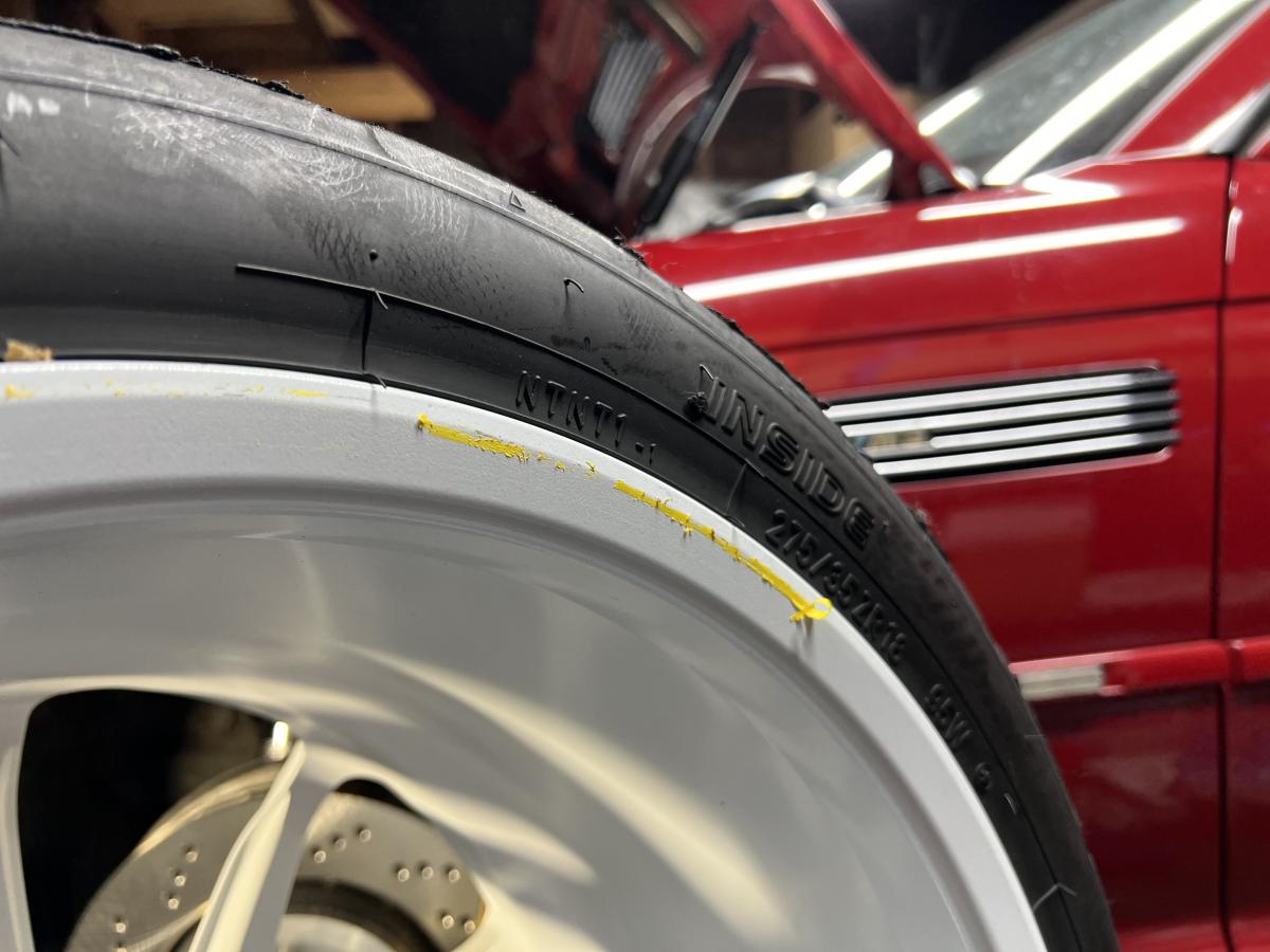

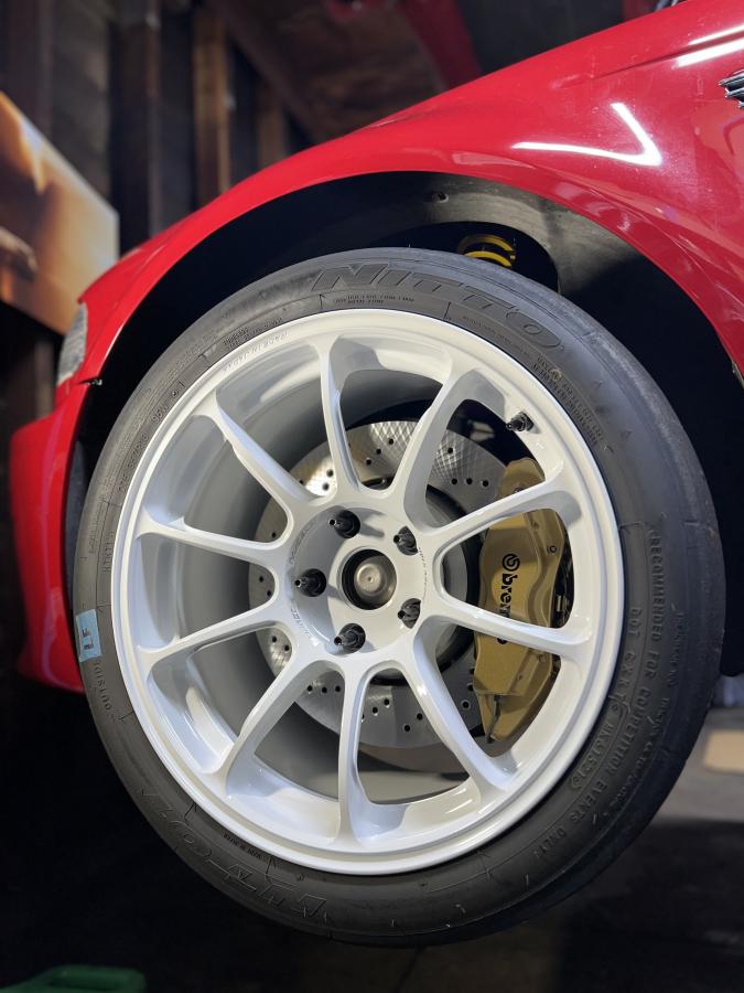

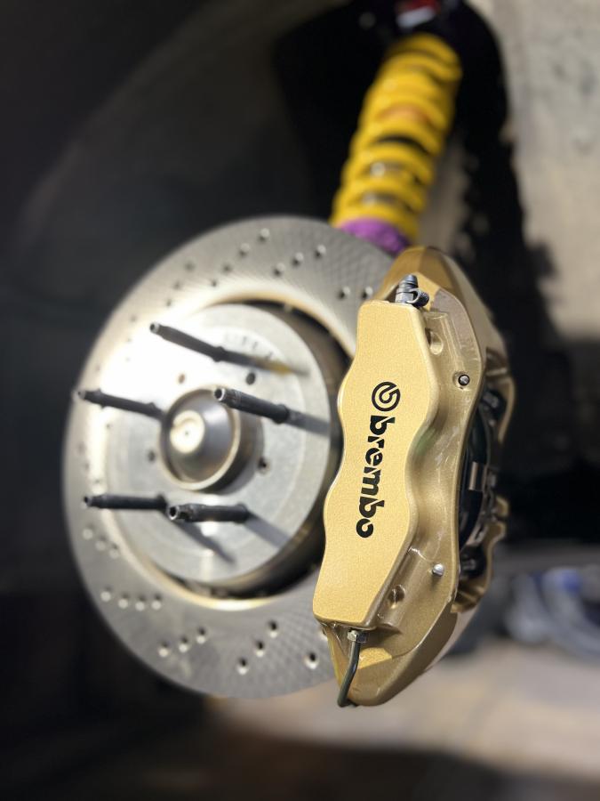

        KW Clubsport, 18x10 ET25 Volk ZE40, 275 NT01 scrubs, new tie rods, new control arms, BimmerWorld TrackCABs delrin LCA bushings, DB9 calipers, ZCP rotors, HEL lines, Hotchkis sway, Hawk DTC-60 pads which I’ll probably change soon, and Racing Brake titanium shims and high temp boots, PFC fluid inbound
        Somewhat ambiguous side note about fitment with this size of everything. It rubbed on the spring at first, but I raised it to what is probably a more realistic ride height, and now it clears. I’m going to have to drive around a bit to let it settle before getting the car corner balanced, that way I’ll know if I’m in the ballpark or if I’ll need a very small spacer.
        Click image for larger version Name:	IMG_0924.jpg Views:	0 Size:	99.0 KB ID:	254716
        edit: forgot to add, long Motorsport Hardware wheels studs. Awesome that they have these at FCP, new set once or twice a year. Boom. Also loving the hex key installation, just sayin, way less of a pain in the ass than the two nut method.
