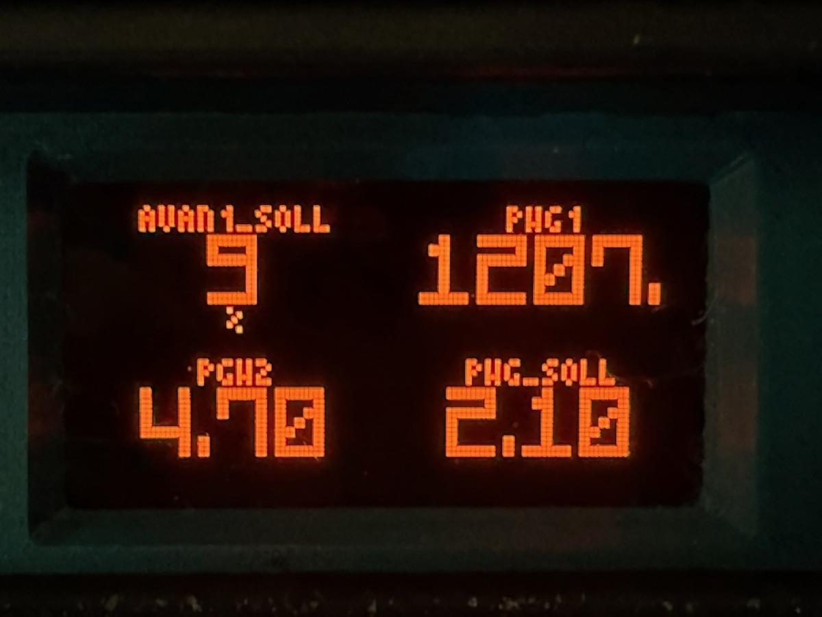

                      Boom! AVAN1_SOLL (target exhaust vanos angle), which is a Slave-only variable, logged at 100Hz over CAN

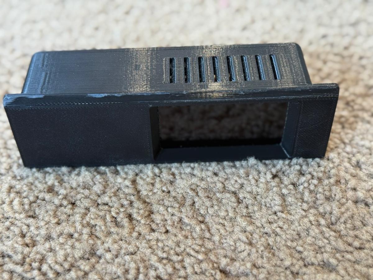

                        Life continues to be busy, have managed to make some progress in a few places.

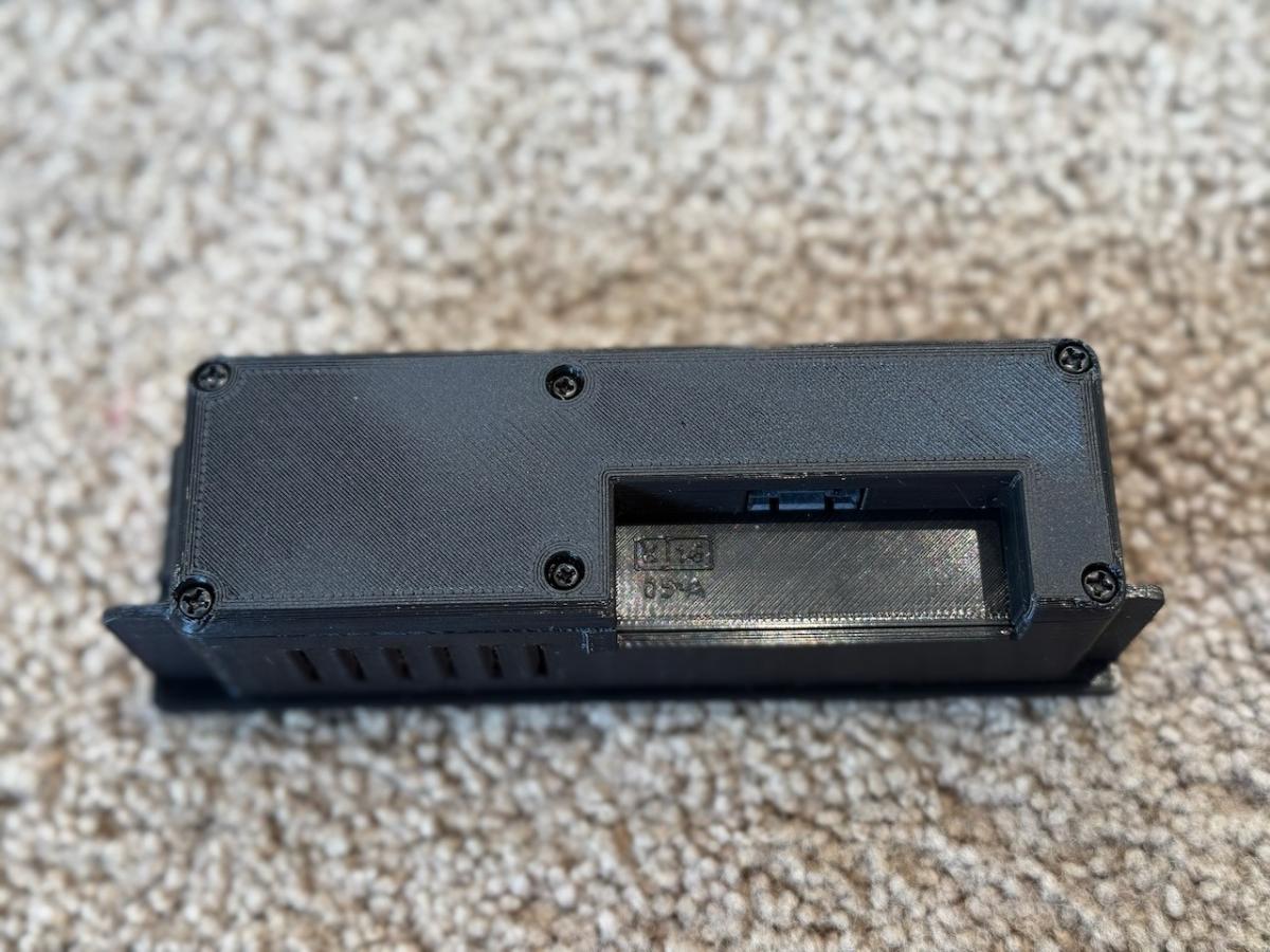

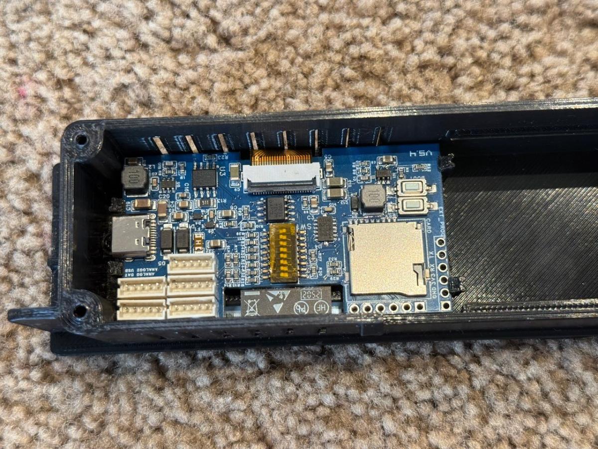

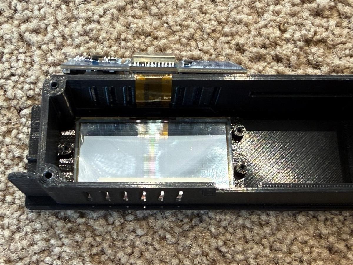

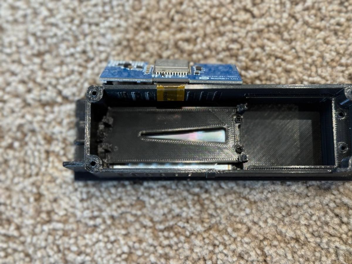

                        I've finalised the design of the Gauge.S enclosure and done a final test assembly (see photos below). I have the final prints too ready to be sanded and painted.

                        I've also been putting the dev version of Community Patch V2 to full use. I've been doing more work on understanding the behaviours of the cylinder air mass calculations specific to the CSL and looking into a couple of interesting curiosities. I've been maxing out the 3 custom CAN messages as well as pulling across slave-only parameters. A lot of this investigation I'm doing would be pretty much impossible without the flexibility of being able to pull, at high data rate, the specific variables I need.
                        I also received my second-hand E86 front triangulation braces that I ordered while I saw them for cheap. Looking forward to getting heinzboehmer's front triangulation brace together and installed when I get the chance!

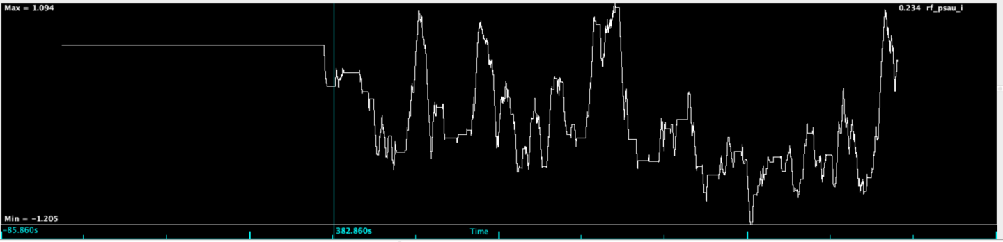

                          I've previously hypothesised that in normal operation the integrator doesn't bounce off its limits anyway, I just haven't actually got around to posting any evidence of this. So here we go
                          This is a normal drive home from work. rf_psau_i integrator is always applied to final RF, but the integrator is only updated once engine temp reaches 80 degrees, hence the straight line at the start of the log.
                          What we can see more generally though is that once the TMOT condition is reached the integrator is very active. We can also see that it hasn't got anywhere near its +-2.5 limits, sticking between +1.094 and -1.205.

                          I thought another way to understand how much of the time the MAP sensor is actively correcting RF would be to look for the percentage of time it's changing. So here we go:
                          Once TMOT=80 is reached in the log above there are 78,859 records captured at approximately 100Hz frequency.
                          Of the 78,859 records, 41,655 of them have an rf_psau_i value that differs in value from 10 records (100ms) earlier. By this measure the MAP integrator is active approximately 52.8% of my drive home. If we extend the measure to look where it differs in value from 100 records (1 second) earlier, the figure rises to 64.4%.
                          In short - for round town and highway commuting the MAP sensor is going to have a significant effect :-)
