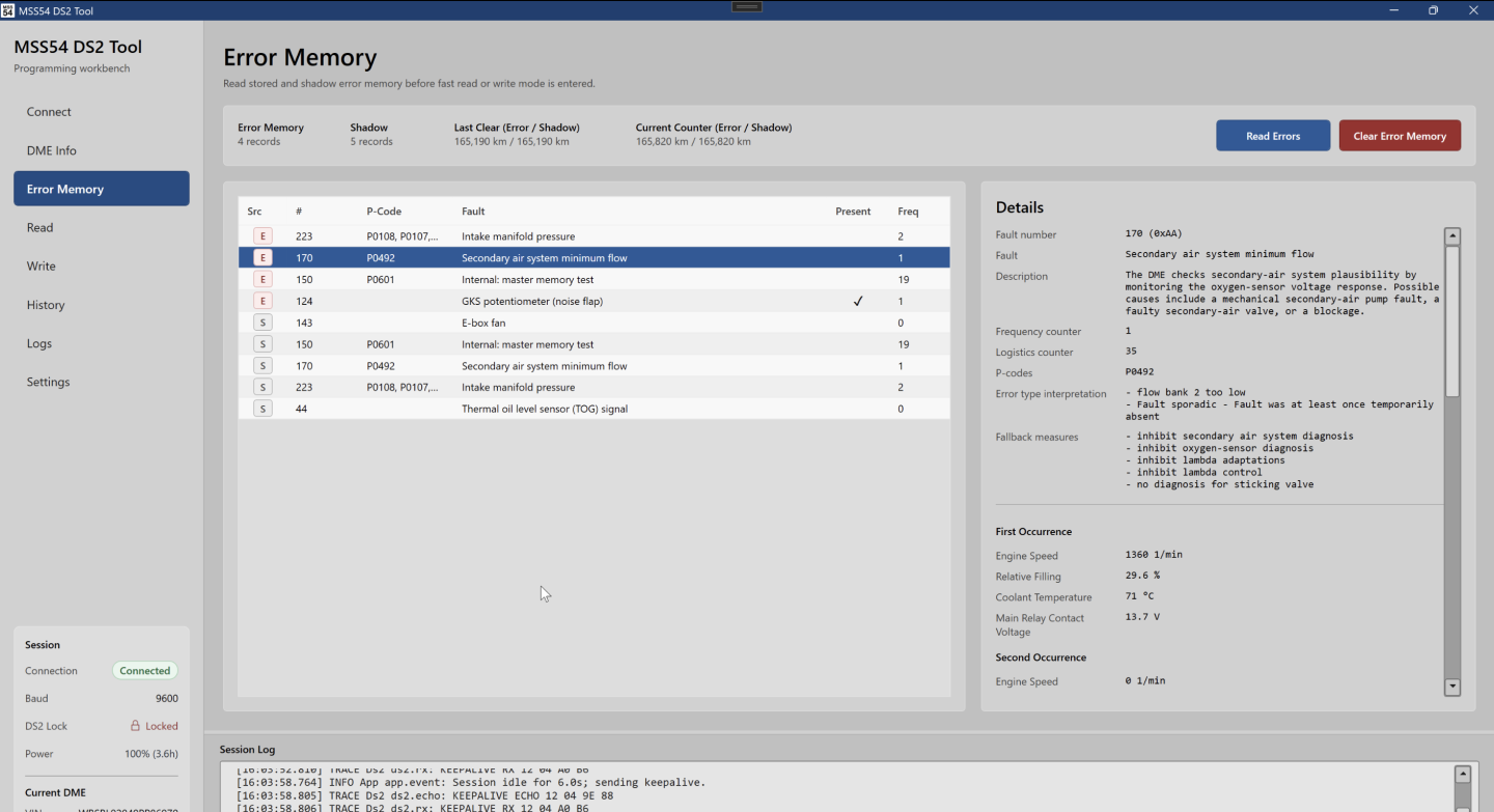

                Reading/clearing error memory proved surprisingly easy to build out. I started with a quick PoC cause I was interested and it was so successful I just finished it.

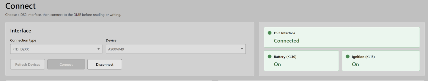

                Also added in support for sensing the KL30 and KL15 lines cause why not.

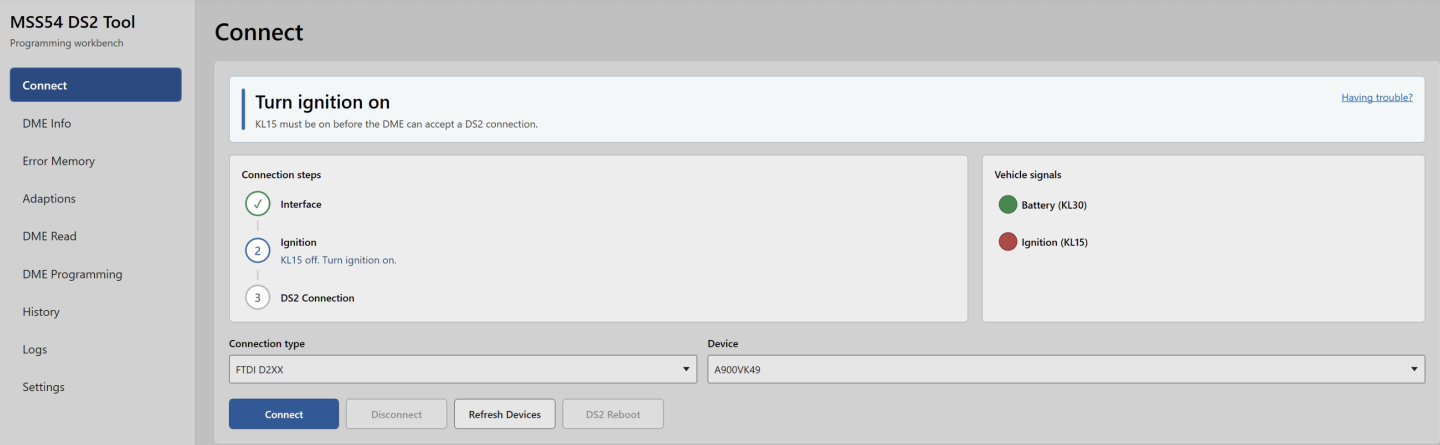

                      Re-worked connection screen to help guide users through the connection process. Essentially plug in your cable, turn ignition on. The app will detect ignition when it's active and automatically connect and begin the query process.

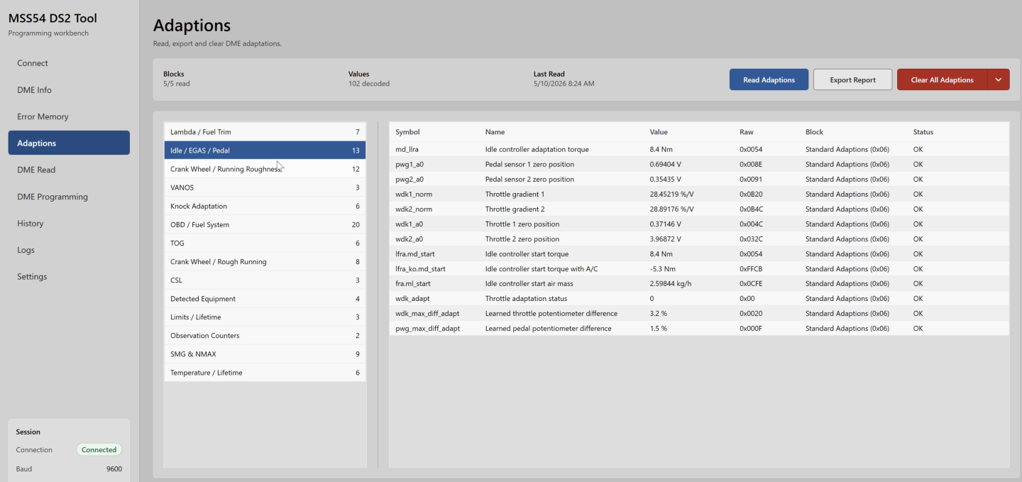

                      Ability to read and reset adaptions is now implemented:

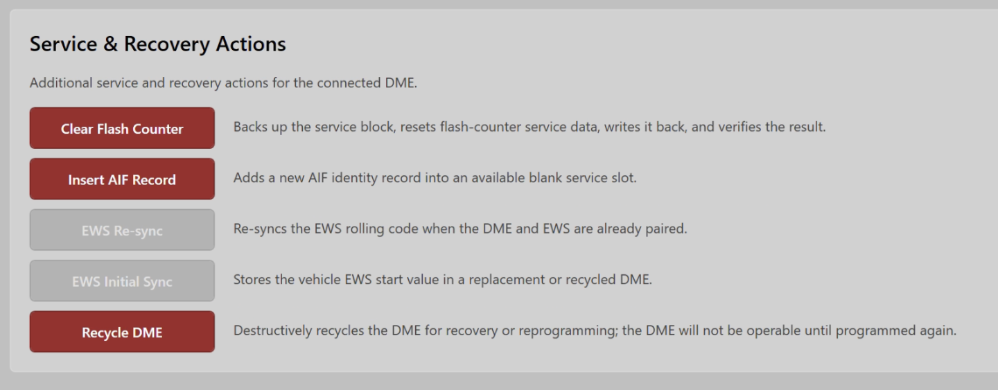

                      And Recycle DME (virginisation), EWS Re-sync and EWS Initial Sync are now implemented, but untested. George is planning to test the Recycle DME and EWS Initial Sync features when he gets a chance.
