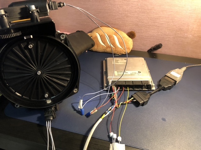

                  What argument should be put in adept_geaeuschklappe of tool32 for csl flap opening test?
                  I want to do a flap test before installing the carbon airbox. The MSS54HP is equipped with H-bridge and cap, and flash with fullbinary of terra. I made the environment for dme bench test, and I heard that flap test is possible with tool32 so I want to try it, but I don't know if I should put in the agument. Please let me know if anyone knows.
                    #39
                    Doesn't need an argument as far as I recall. You might need to run it twice
                      #40
                      Thank you for your reply! I've run it twice without an argument, but there's no response. There seems to be a problem with my h-bridge or connection.

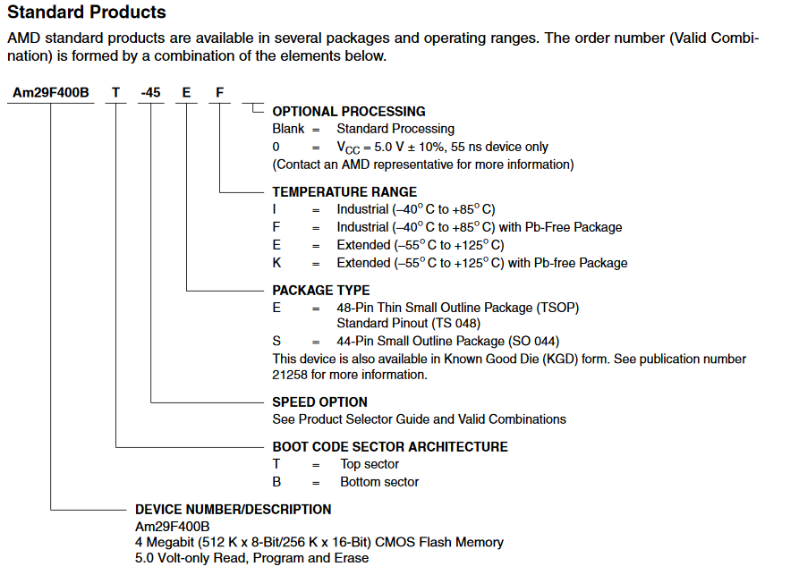

                          Here is some good info too on the EEPROMs if you are going to order one and want to know what all the numbers/letters mean
Name:	Screenshot_2020-07-22 am29f400b_21505e8 book - AM29F400B_EOL_21505e8-9219 pdf.png
ID:	44758 Click image for larger version
Name:	Screenshot_2020-07-22 am29f400b_21505e8 book - AM29F400B_EOL_21505e8-9219 pdf(1).png
