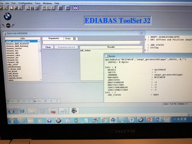

              After watching your test video, I realized one thing. In the result window of your Tool32 adapt_geraeuschklappe, there is UBATTCRRENT=1 UBATTHISTORY=1 IGNITIONCURRENT=1 IGNITIONHISTORY=1, and my tool32 is -1 as an attached photo.
              What does this mean? Could this be the reason why the flap test is not working?

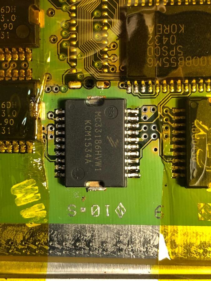

                where did you get your H bridge chip from?
                i had the same problem as you when I purchased BOSCH 30348 1549 on ebay i asked other people on here where they get their BOSCH 30348 variants that DID work but no one answered me so i ended up just opening an MS45.1 DME and ti had a compatible MC33186DH Chip.
                i see yours is actually MC33186HVw1, where did you get that chip from?
                  #53
                  I bought MC33186HVW1 in Rochester Electronics. I think it is a reliable provider.

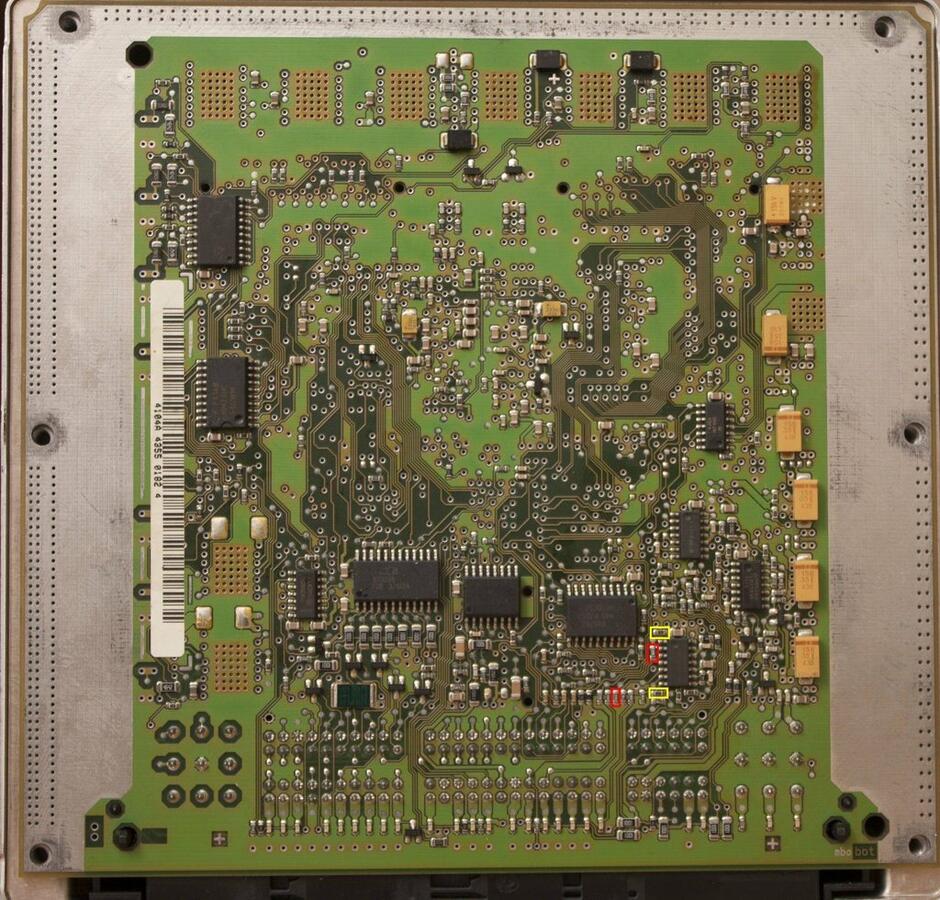

                    FYI I replaced the yellow resistors on my MSS54 with some 10kohm resistors rated for 250mw (mfr # ERJ-UP3D1002V) for my MSS54HP conversion and was getting about double the current running through my DME when powered and it would not enter BDM mode. I went back to the stock resistors and all was good. For anyone doing this conversion, I would leave the yellow resistors alone.
                    Click image for larger version  Name:	map_resistors.jpg Views:	0 Size:	185.2 KB ID:	48688

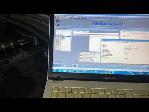

                          Finally, I was able to operate the flap.
                          Thank you very much to the members. Especially to heinzboehmer and NZ_M3.

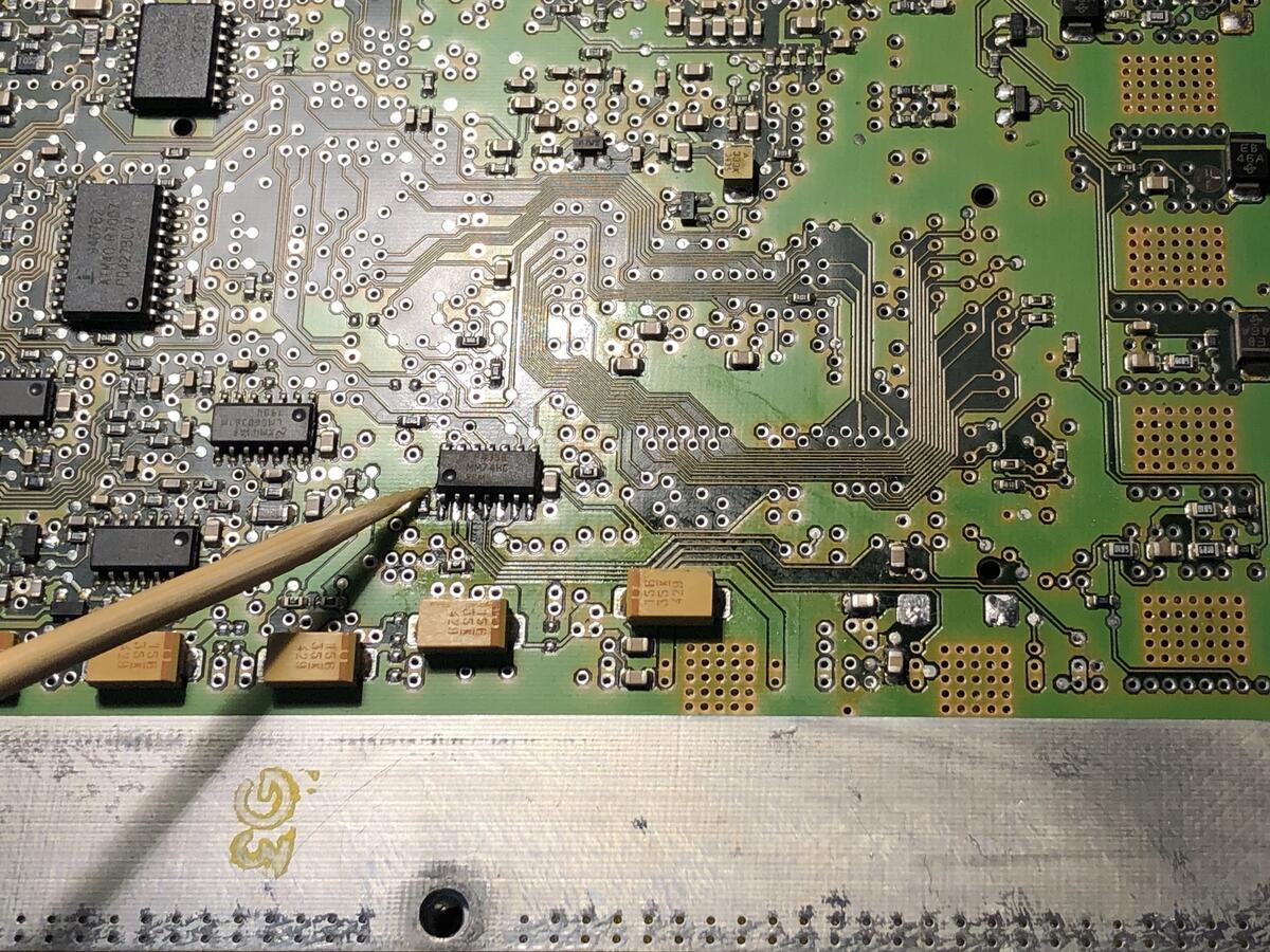

                          What I did was to change 1.H-bridge (MC33186VW2) and to change 2.XOR gate (MM74HCH86M) chip and solder them again.
                          First, I got a new H-bridge from win-source.net and tested it on DME, and as soon as I turned on the ACC power of the car, the flap motor started to run continuously. At this time, when I did the "adapt_geraeuschlappe" test with tool32, the motor stopped once and moved again continuously.
                          I thought something was wrong, so I checked the connection to the DME circuit. The problem was that there was a Vbat voltage on the input because the number 3(input) and number 4 (Vbat) of the h-bridge chip pad were connected. After investigating the cause of this, there was a problem with the XOR gate chip (attached photo) connected to the Hbridge, although I don't know when it broke down.
                          I didn't have the spare parts of the chip right away, so I took it from another DME I had and swapped it to a DME for CSL clone.
                          The results are as shown in the video below.
                          If the flap is not working as well as in my case, it will be helpful to check the connectivity of the chip and check the surrounding circuit issue as well.
