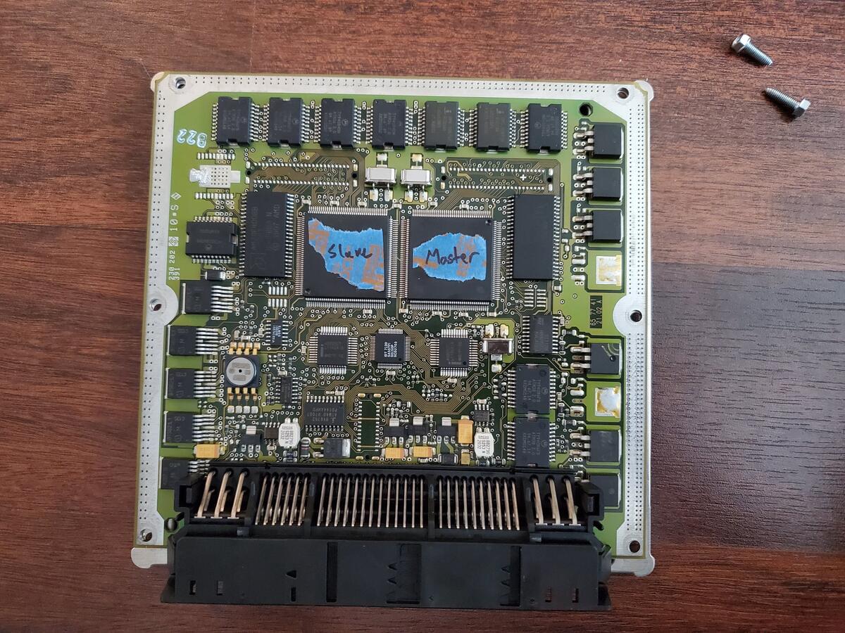

            This is the correct way to do it. Make sure you're flashing the first half onto the master and the second half onto the slave. For reference:
              Thanks mate, anyway still no go. Im dont know what Im doing wrong. Anyway I noticed that everytime I try to turn on the ecu it changes the data a bit. When I compare backup data with data I just download from the ecu it differs in few bits. That makes me think If the backup is correct as I cannot be sure right now. Do you think you can check if I split the data correctly? Even when its very simple task, Im being sceptic hehe. Thank you

                Yup, it looks to be split just fine. Have you tried communicating with the DME via OBD? Might let you know if it's behaving correctly or not.
