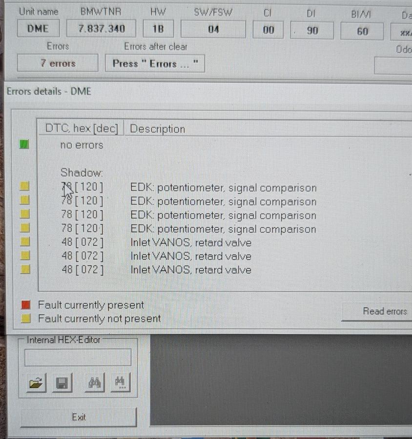

                        I also had these Shadow codes. I never saw a check engine light but I decided to check codes today and saw these Shadow codes. Inlet Vanos retard valve errors

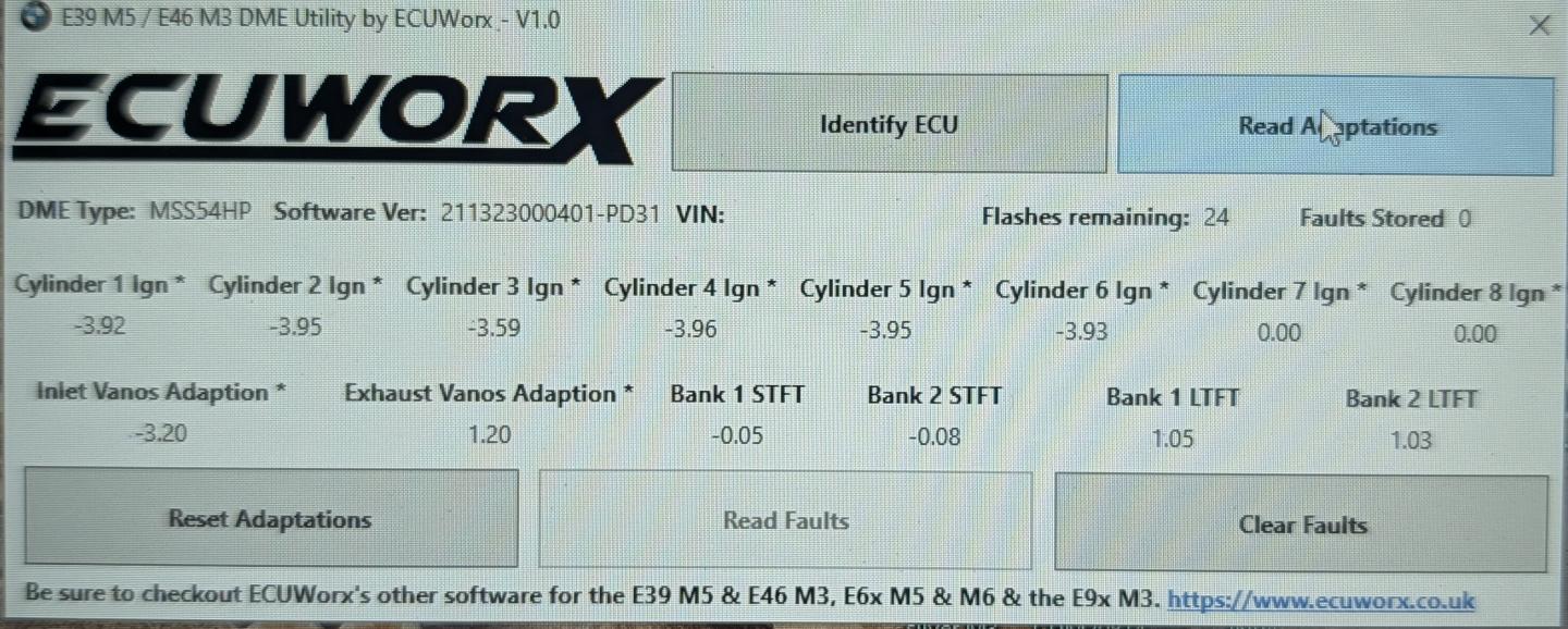

                              pinging sounds more like cumbustion is not OK. Would check fuel trims and knock adaption too.
                                This is what my adaptations currently are using ecuworx
                                Click image for larger version  Name:	PXL_20241023_115725134.jpg Views:	0 Size:	173.5 KB ID:	282043
                                This is my first and 2nd vanos test run back to back oil temp was normal and i just came back from daycare drop off driving for 45 min with some spirited driving in between after dropping kids off of course.
