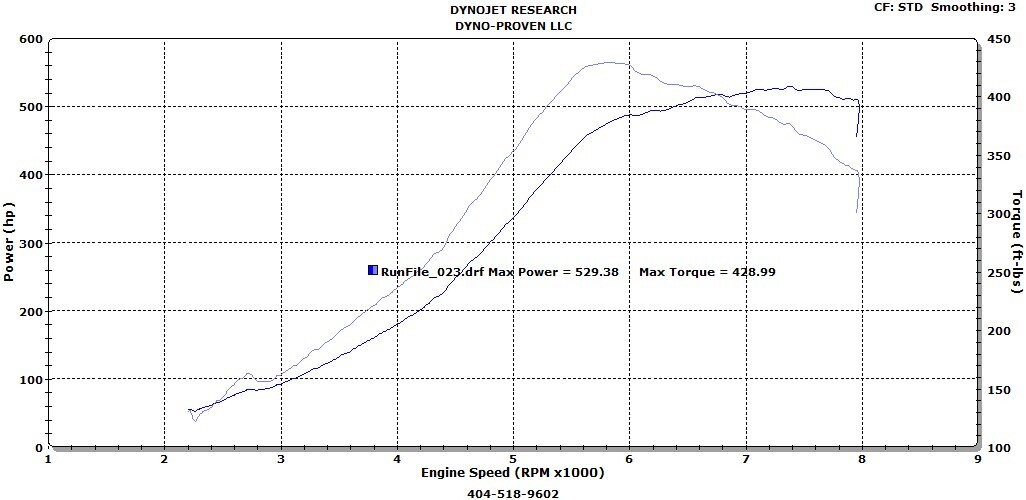

          Finally got to the dyno for some fine tuning on my turbo S54.
          at around 11-11.5 psi it made a final number of 529 hp and 428 tq on stock internals stock clutch and e85 AFRs were in the mid 11's
          tuning done by HTE on stock DME MSS54HP
          Some videos too
          before anyone says anything, i didnt catch that the dyno HP and TQ were not scaled equally thus the numbers will not cross at 5252 but the numbers are accurate.

          Amazing power and great tune from hassan .
          Did you test 60-130 times ?

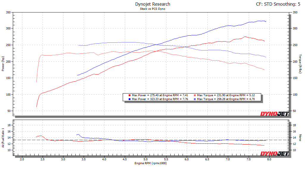

            Dyno graph comparing the fully stock run to the CSL/SSV1/PCS dyno run:

            315 max WHP, 252 max WTQ
            Gained 46 whp/25 wtq and both the power curve and AFRs are looking much better than they did stock.
            I didn't realize the dyno had been set to STD correction (pretty sure it was set to SAE the previous times I was there), so I left thinking the car made 323 whp. It was honestly a bit disappointing to come home and see 315 whp when I loaded up the dyno runs. Oh well, I'm not really trying to set any records and the car feels awesome, so I'm satisfied. Plus, it's not like 315 whp means the car is slow. Maybe I'll do cams someday, but for now, I think my power chasing has come to an end.
            And just because I can, here's the same run with STD correction. Goes to show how little absolute numbers actually mean:
            Click image for larger version  Name:	Stock vs PCS Dyno - STD.png Views:	0 Size:	36.4 KB ID:	140187

              Gain of 42whp/25tq, that must be nice
              This is a good comparison and the car made 62whp more than stock - https://nam3forum.com/forums/forum/m...-numbers/page2
              His engine has 30k miles less and the SS-dual section 2 with muffler, so that's probably worth ~15-20whp. As you said, your current power level is solid.
                Looks like that car's power increased by 19.8%. My gain was 17.2%, so not super far off. If I manage to find 7 whp (better fuel, colder temps, rest of the SS exhaust, etc.), I should be able to bump my percentage gain up to 19.8%. The screen won't show 348 whp, but I can at least same the gain was the same
                No, but in reality this is plenty of power. Certainly more than what I need. From now on, I'll be putting money towards track days to try and work on that driver mod instead of trying to chase power.
                  Heinz, I still believe your car is about 10hp down on power for what it's worth though you don't care.
                    Yeah maybe. Maintenance is up to date, so I'm fine with it. If there's anything wrong with it, then it's probably something internal to the engine. I'll do a rebuild when it's necessary, but I'm happy with it for now.
                    Maybe next time I drive down to LA, I'll throw it on EAS's dyno, just to see what it makes on that lol
                      You'll probably dyno 2-3 more on theirs since they have the fans but then it's warmer here so might cost you a couple as well.

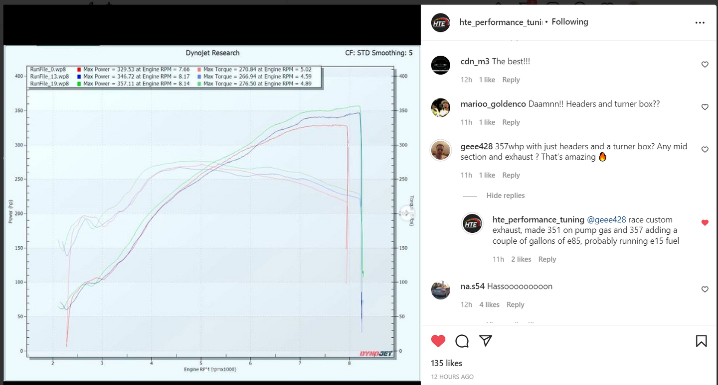

                                Has anyone seen what HassanEido posted today on Instagram? This must be a Wednesday car for sure aka factory freak!
