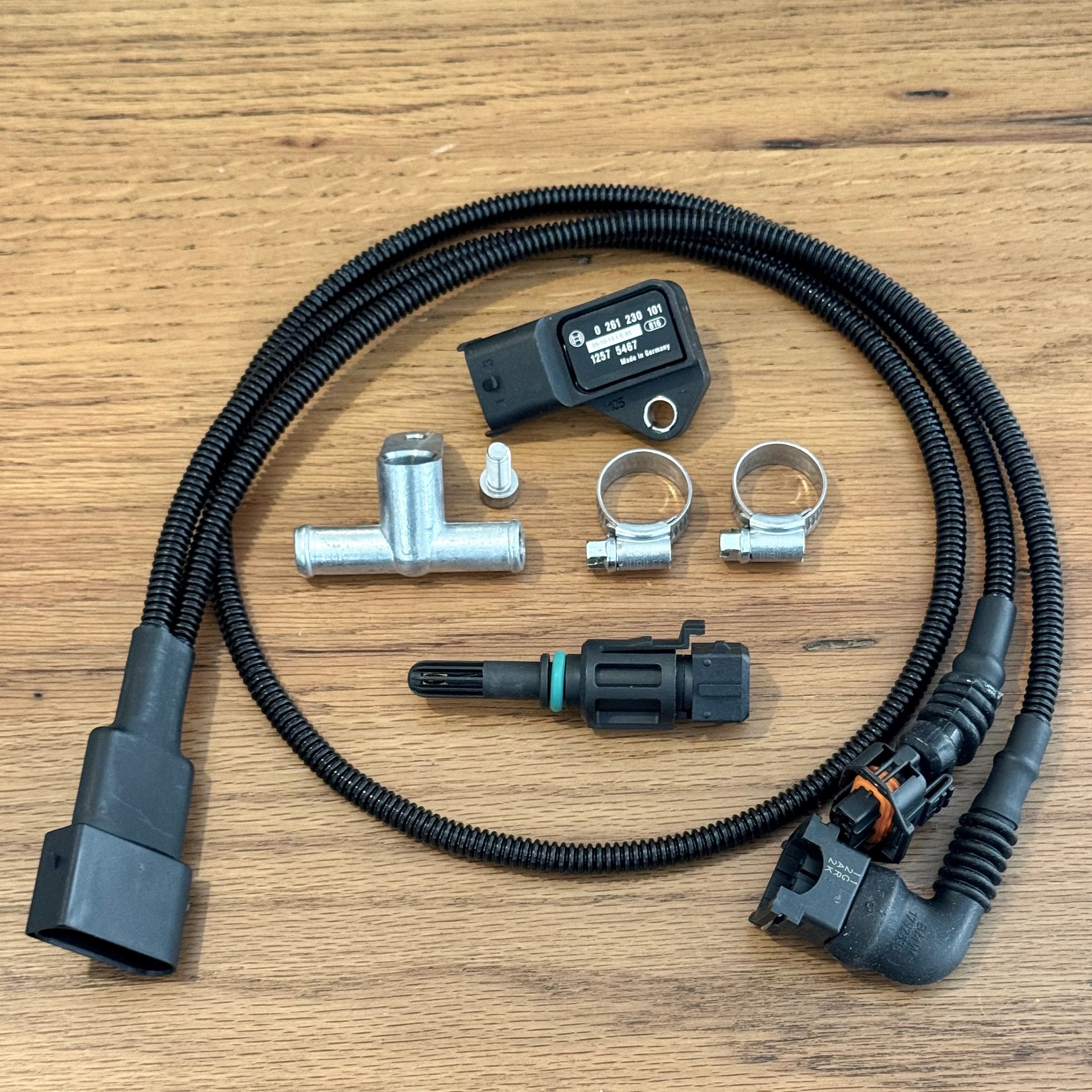

                FYI, I contacted Auto3Design recently as well and they are going to build and sell a harness based on the diagram in this thread. I asked them to size it for an air rail mounted MAP sensor. The link should be available this weekend, and the harnesses should be ready next week. Will be interested to see how it looks. . . . I'll likely give it a try as I gather parts for an airbox install.

                    Will do! And great work again to you and karter figuring this out. I told them I bet they’ll sell a lot of these because this seems like the new go-to solution for a CSL airbox install with MAP.

                      Looks like a pretty slick solution. You can select your airbox type and if you are using the OEM air rail, in which case they will size the harness accordingly for a clean install. And you can opt to exclude the sensors if you already have them. I'll give it a try and post some pics.
