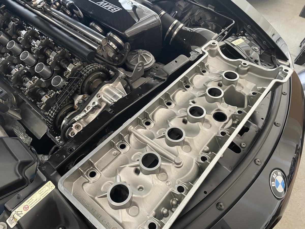

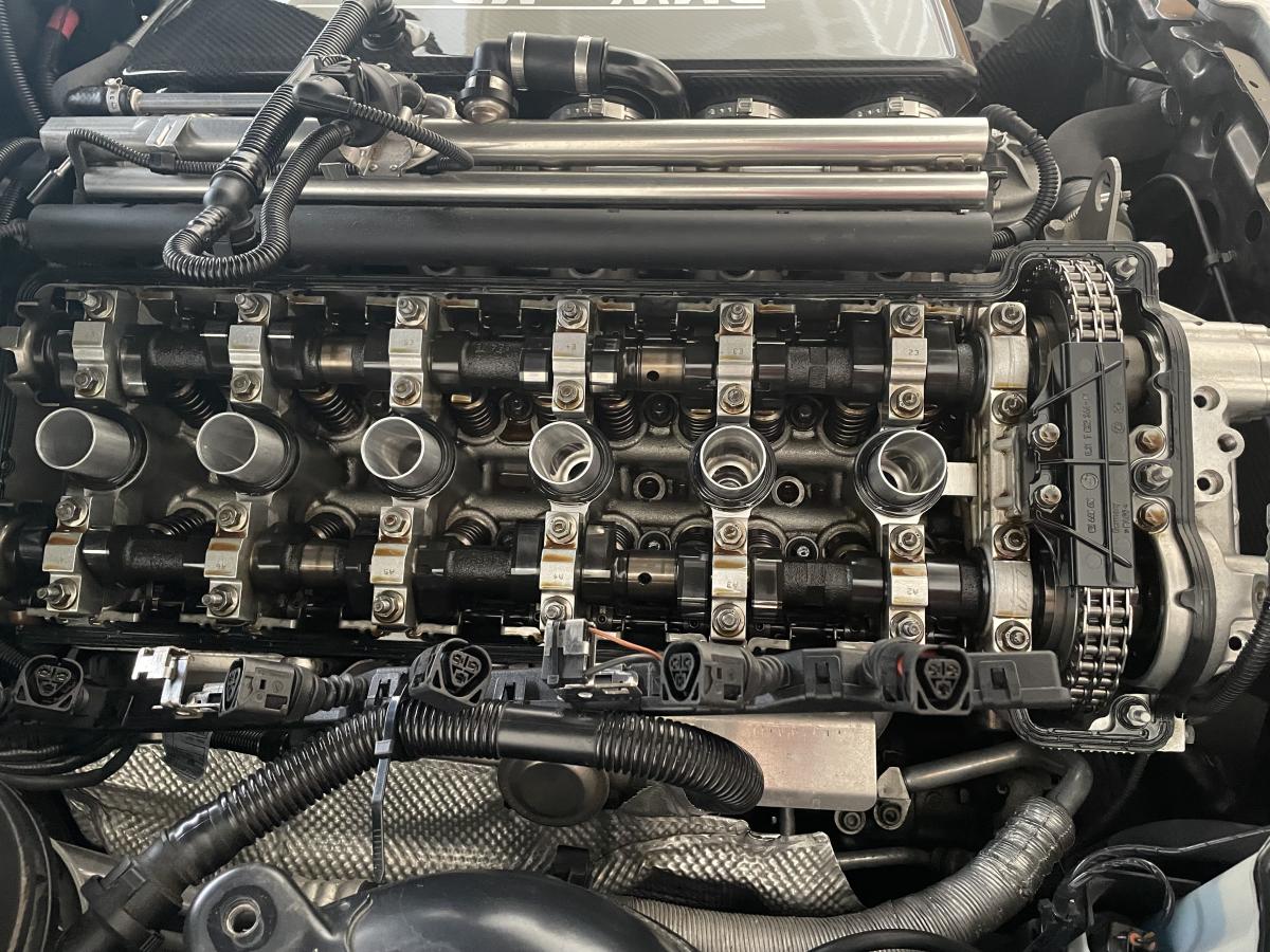

              I started some VANOS work. Mainly I am switching back to the correct diaphragm springs for the S54. I am still debating if I install my VANOS as is or bite the bullet and get the Beisan hub.
              very clean inside
                    very clean inside

                    If your hub is not damaged, just get the disc with the correct diameter bore and save the rest.
                    Only need a new hub if the old one is damaged.
