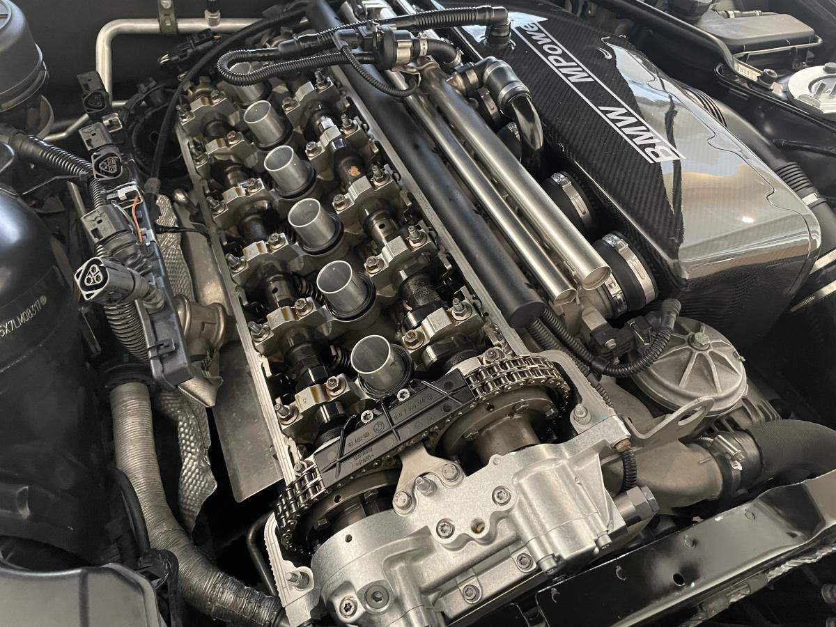

        Finally had some time to perform a valve adjustment, check the VANOS hubs, new spark plugs, new coils, new valve cover.
        Is this oil stain normal for 75K miles? These plugs look toasted.
          what is your oil change interval and with which oil
            I just bought this car as my second M3, so this is my first time servicing the vehicle. I’m assuming there hasn’t been an oil change performed for over 5K miles and the valve cover was leaking (which prompted the valve adjustment and valve cover replacement since I was already in there).
            I’ll check the service documents but looks like they stopped keeping paperwork records around 60K. Owned by a few dealerships between 40K and 45K, then father and son combo owners for the last 30K.
                    Varnish is not driven by total miles, rather by OCI. Change oil more regularly, if the varnish is already built up then you need to wipe it off as not even flushes will remove it.
                      David
                      OK, it looks very dark. Like driving with Castrol... I do an oil service every 7,000 - 10,000 km and mine is much lighter.
                      Especially if you drive a lot of short distances, it's more likely to be under 10,000 km.​
                        Yes, looks low quality and probably hasn’t been changed in well over 10,000 km. Once I get the appropriate valve shims (nearly all of them were out of spec) I’ll flush the oil and run a cleaning agent for about 2,500 km and then change the oil again.

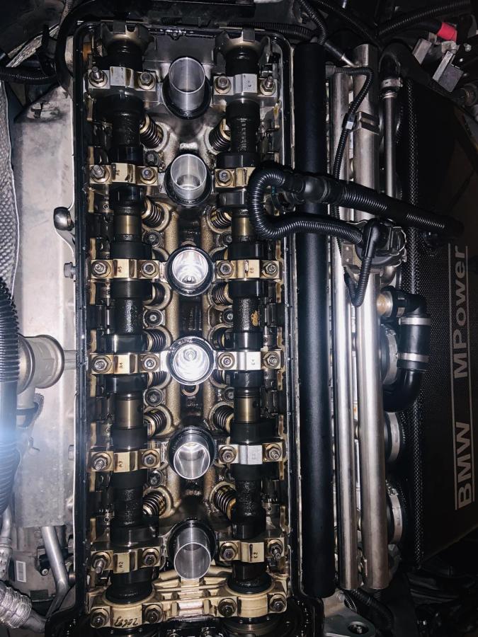

                          This is mine at 43k miles (before) and at 53k (after). Just oil changes every year, which is about 2-3k max.
                          Before
                          Click image for larger version  Name:	IMG_9931.jpg Views:	0 Size:	123.4 KB ID:	275357
                          After
                          Click image for larger version  Name:	IMG_0934.jpg Views:	0 Size:	293.9 KB ID:	275356
                            So clean that it looks dry 😮
                              Before
                              After
                              What’s your oil of choice? I run Liquid Moly 10W/60 in the black M3 so will likely do the same with this one. I’m of course going to send an oil sample to Blackstone to see what unknown damage might be lingering and also… what type of oil has been used in the last 15-20K miles.
