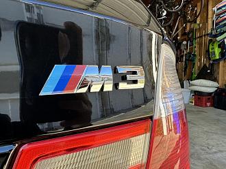

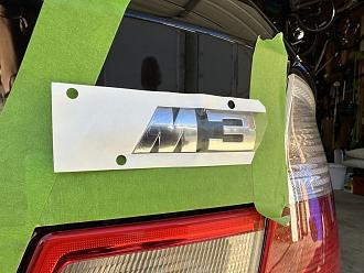

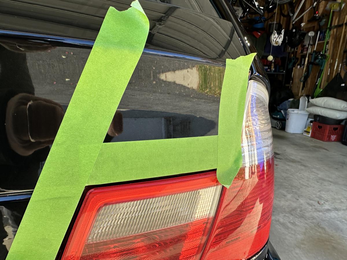

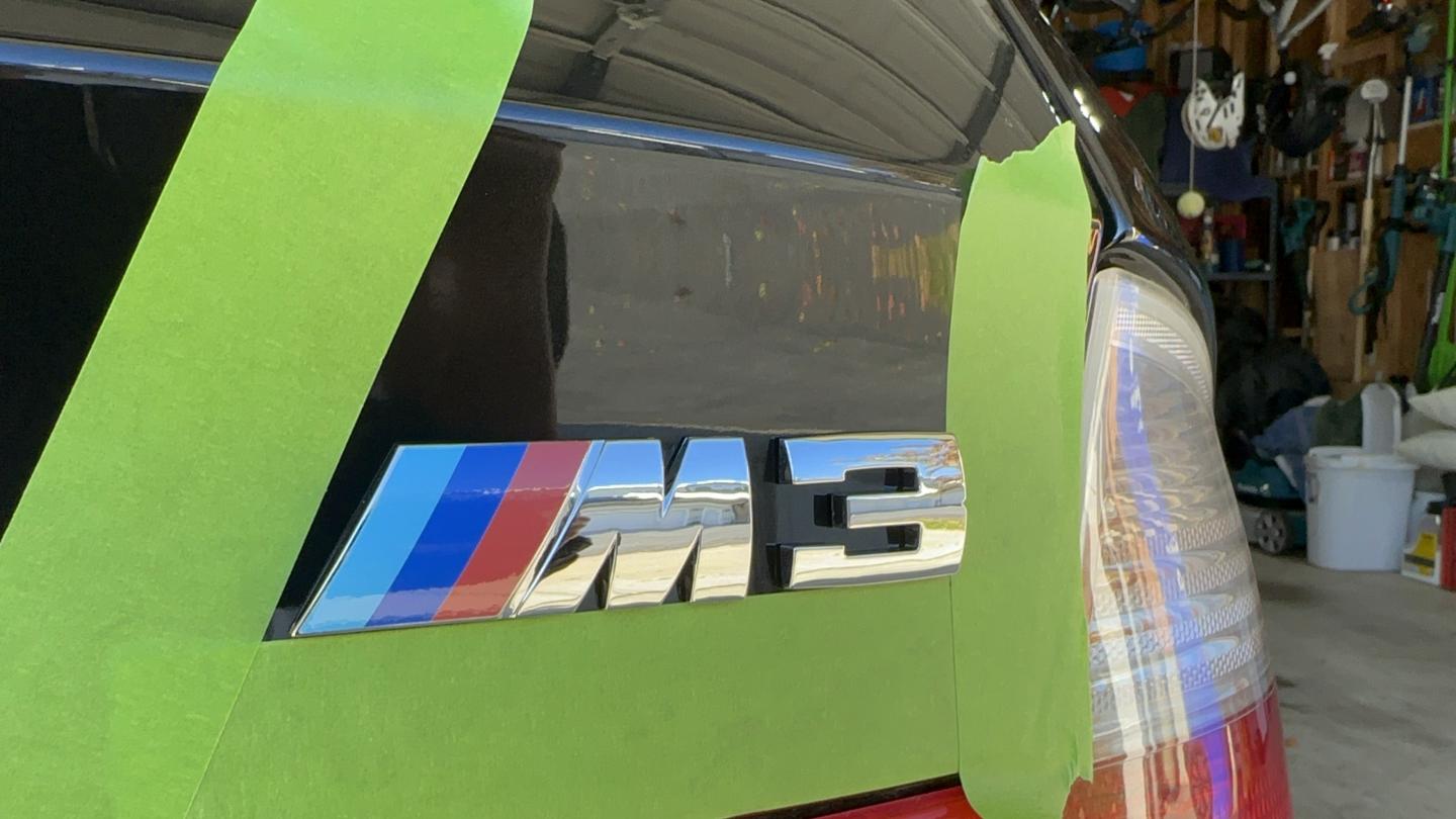

    I did a thing...
    Bring on the haters LOL

          Look more like a 332is than an M3
          Seriously, beautiful build. One day I will build one!

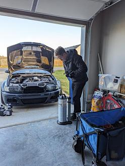

              Sucked her dry and filled her back up with new oil and filter.

                  I was thinking of doing that to mine but I have it just blanked at the moment !
                    You have a conversion too? Have pics or build thread?

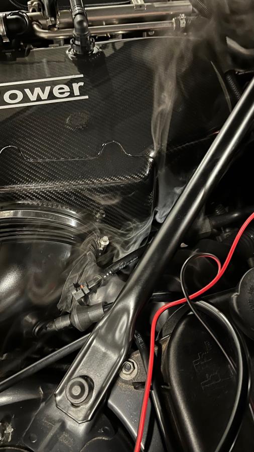

                        I leak tested my Karb box and need to be sealed.

                        The warranty process did not work out too well for me so I will seal it myself.

                              How did you seal it? Thx
                              Sent from my Pixel 7 Pro using Tapatalk
                              I used loctite 9460 and apply a bead all around the seam of the two airbox halves and spread it to ensure all gaps were sealed. I will smoke test it on the weekend to confirm it worked. The epoxy I used has has. 72 hour cure time.
