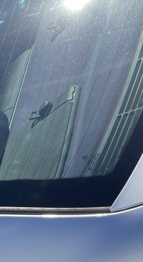

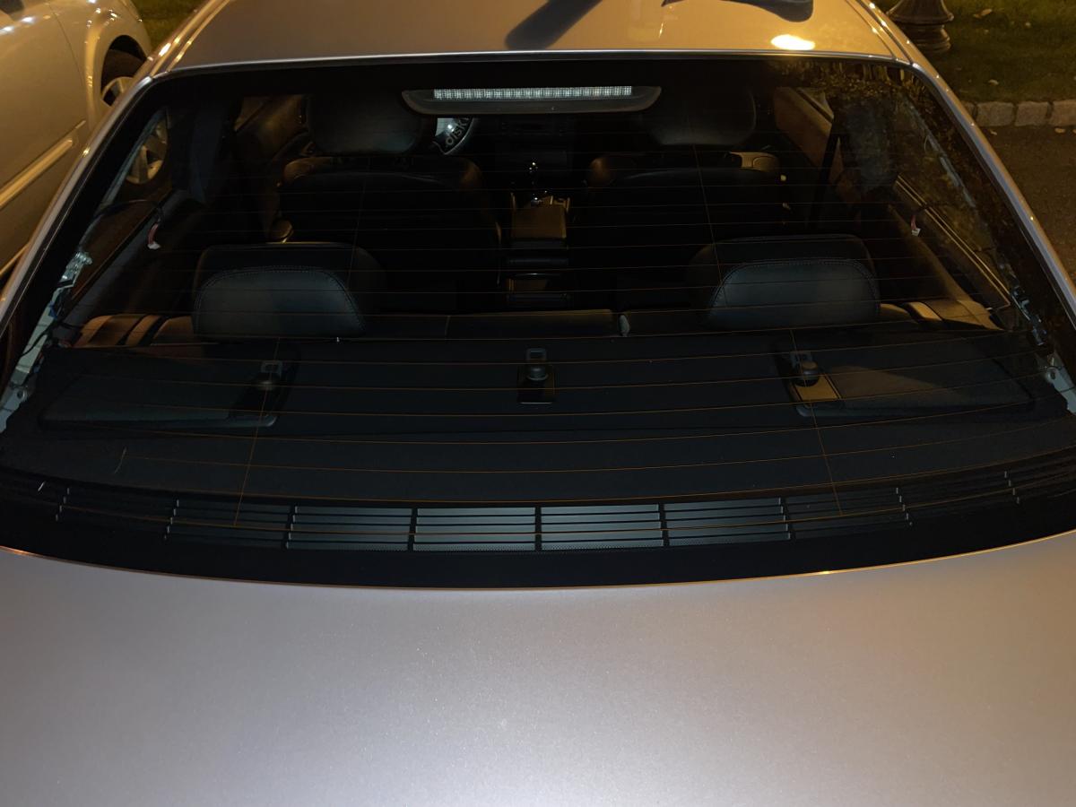

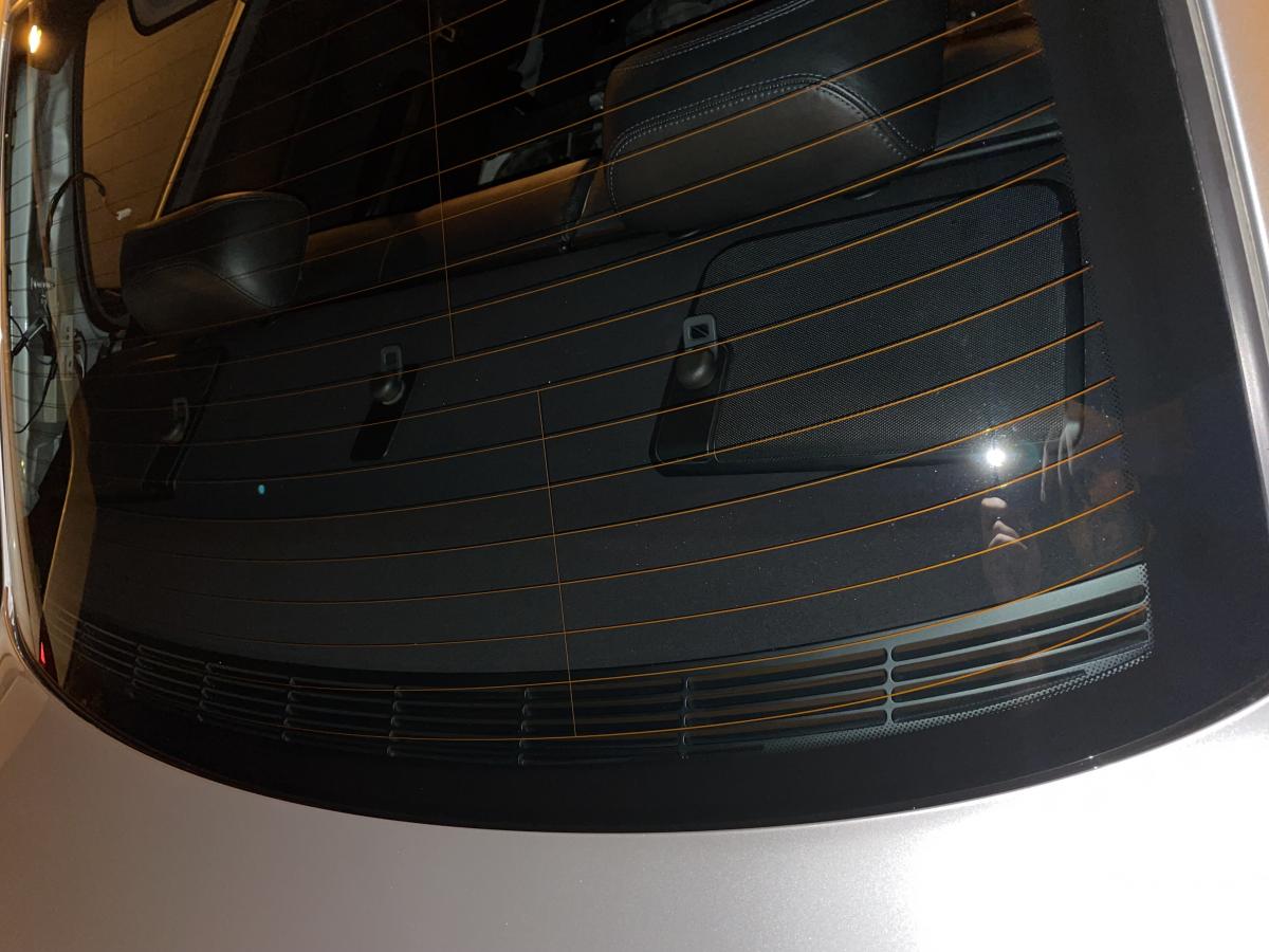

            Name of the fabric dye I used for the parcel shelf. Not the best picture but here’s how it looked beforehand.Click image for larger version  Name:	IMG_6676.jpg Views:	0 Size:	53.2 KB ID:	240885
              Looks great (The after picture)
              Did you dye the shelf without removing it?
                That’s what I thought. Looks great… new actually.
                maw
                  Thank you!…I saw someone do it once without removing it using index cards and a brush but I ended removing it and using a spray bottle. Plus I wanted to clean the vent (was dusty) and fully clean the rear glass. The job isn’t too hard, just gotta watch out when taking the C pillars off and the rear seat bolsters because the plastic mounting points might break. Otherwise, could be done on a day off.

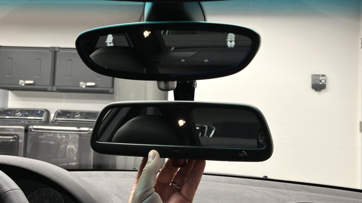

                          Z4 manual dimming rearview mirror. When it comes to this car, I like simple.
