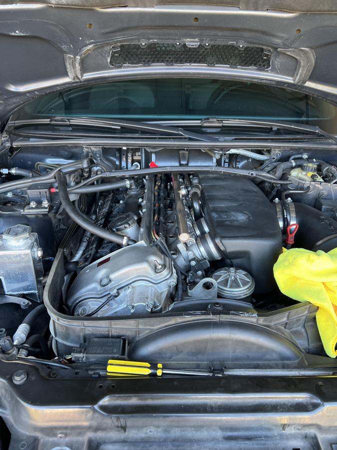

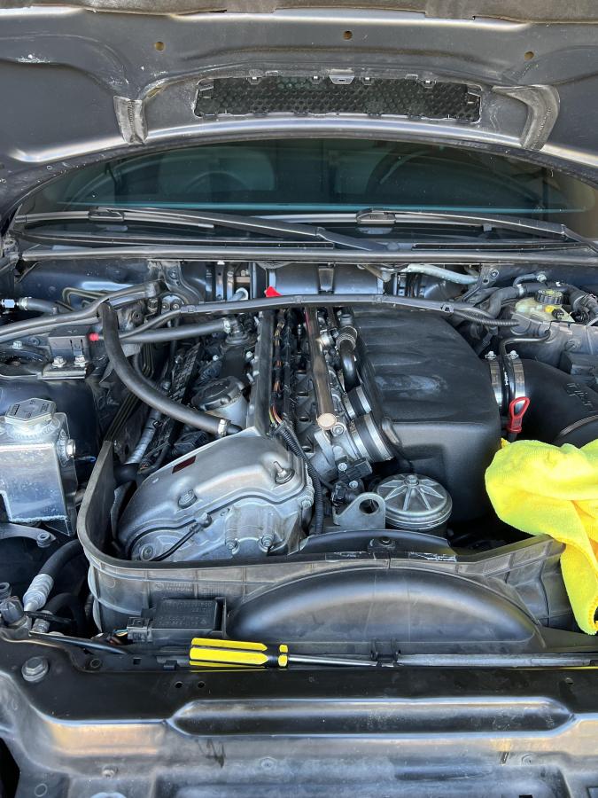

          pulled out the injectors to get them cleaned. getting the air and fuel rail out seemed impossible until i realized you could get the false bulkhead out
          also noticed that the air rail has a few dents in it. unsure when those happened and if it would even affect anything.

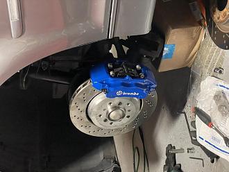

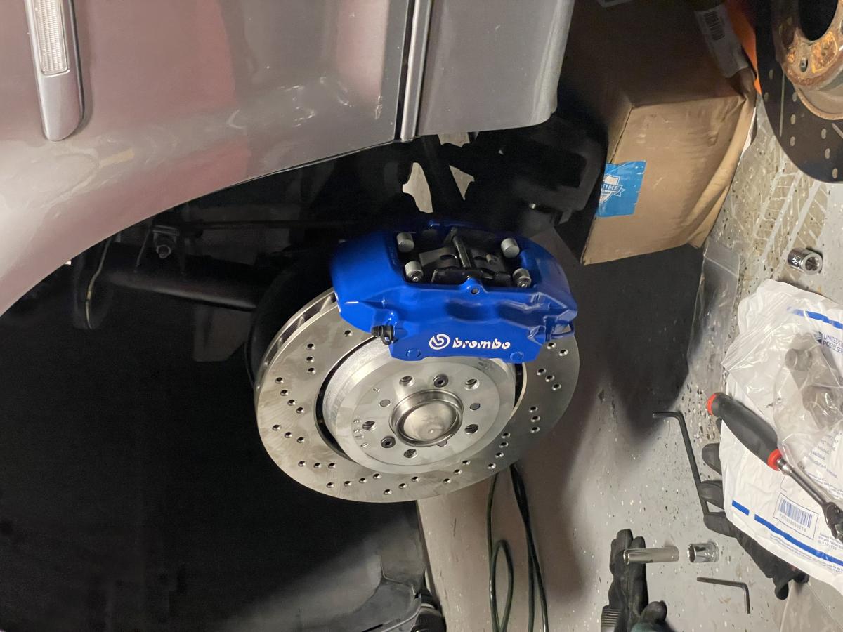

            Click image for larger version  Name:	A229A2B5-4097-4DA3-8EA3-D8D7E4F0E5DD.jpg Views:	0 Size:	115.8 KB ID:	180653 Changed the front wheel hub assy’s. Changed to csl rotors & Finally put the 996 brakes on the fronts. Installed the driver side axle, only to realize there’s a nick on the shaft before the threads that is stripping my axle nut 🥲 so I gotta file that down tomorrow.
            (dk why it posted pic like that)
            Also changed the rear wheel bearings, repacked the grease/changed the axle boots, and put on new brake shoes.

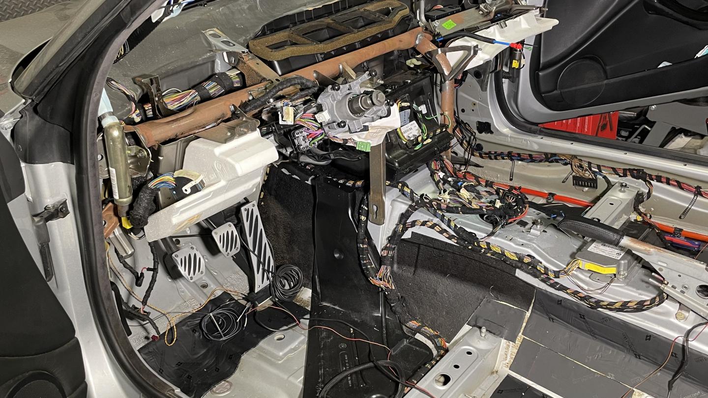

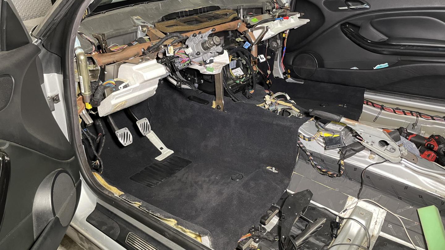

                Just finished installing the front carpet, five days short of five years after my car got floodwater inside which forced me to cut out the original carpet. ❤️

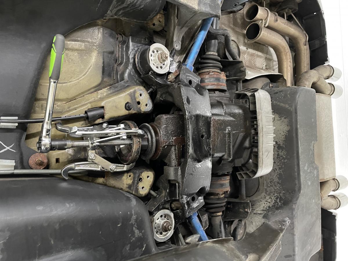

ID:	183395 Installed new pinion seal on my differential.
