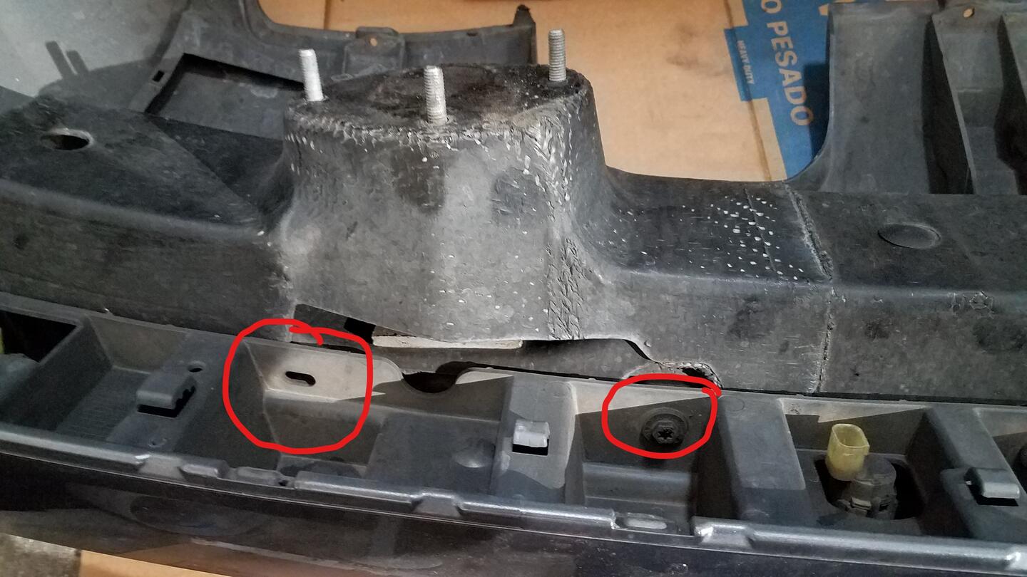

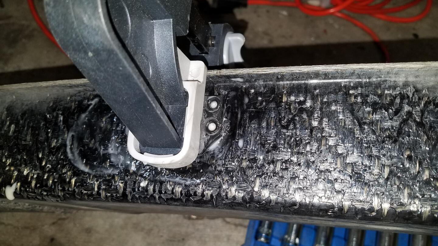

    Side note, I also did some bumper repairs after some loser in a POS minivan swiped my rear bumper and took off. Sheered a couple foam support screws and caused two brackets bonded to the support to come off. Bumper still doesn't sit perfect (probably because they caused the foam to breakup inside but better than before.

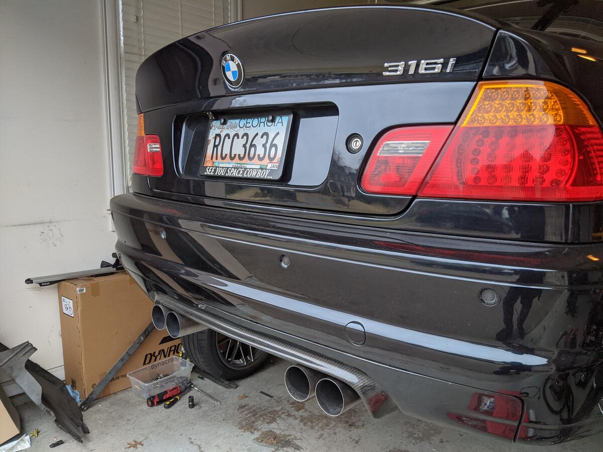

                  Got rid of the scratched up black paint on the tips of my Dinan muffler and made them polished stainless instead.
                    I know it's not a new idea, but love the rear emblem. Something about your placement and emblem choice on the CSL trunk just looks awesome.

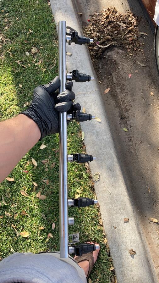

                                New Injectors and fog light delete (Hard motorsport brake ducts). Dremel worked quite well to the point it almost looks oem
