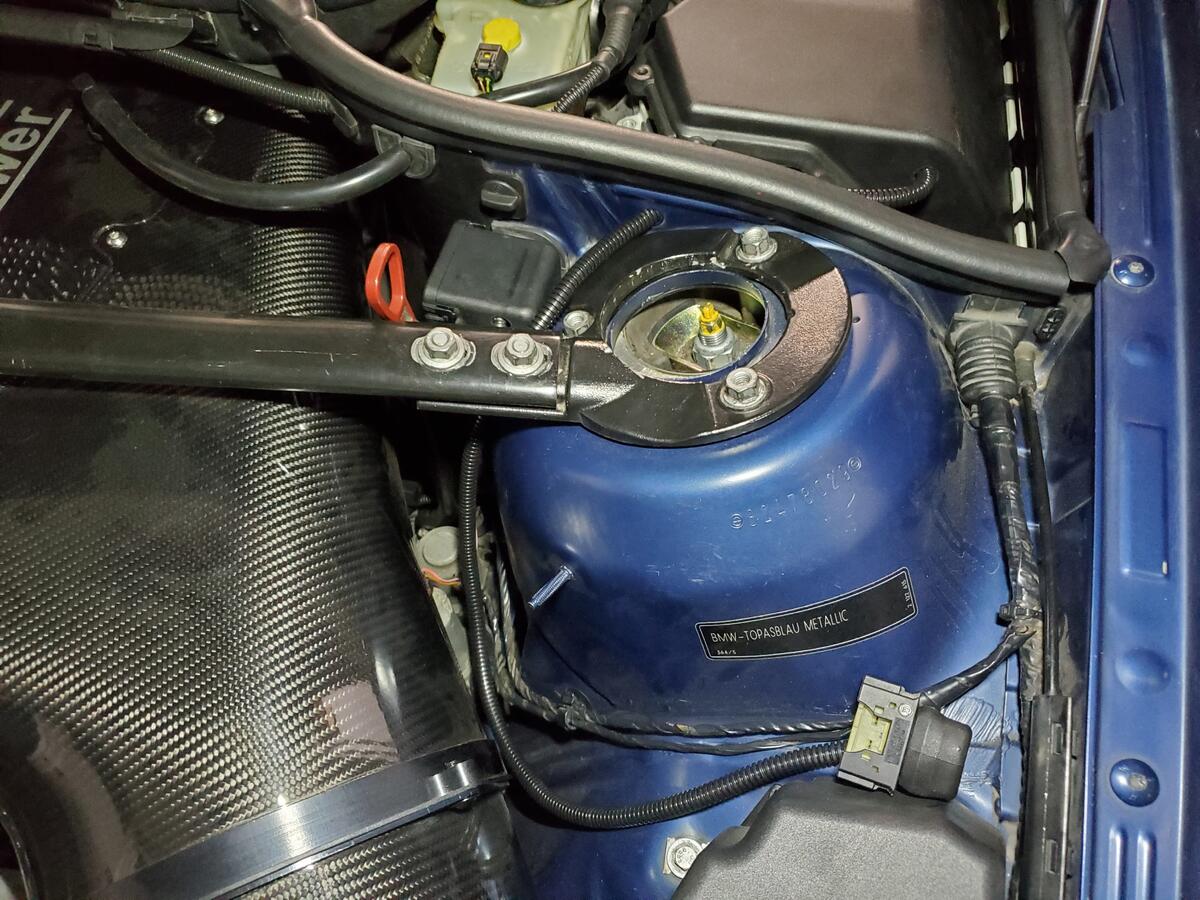

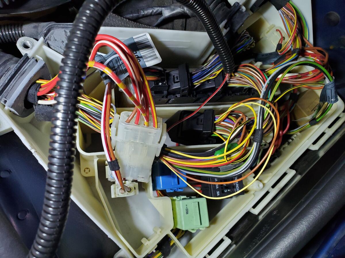

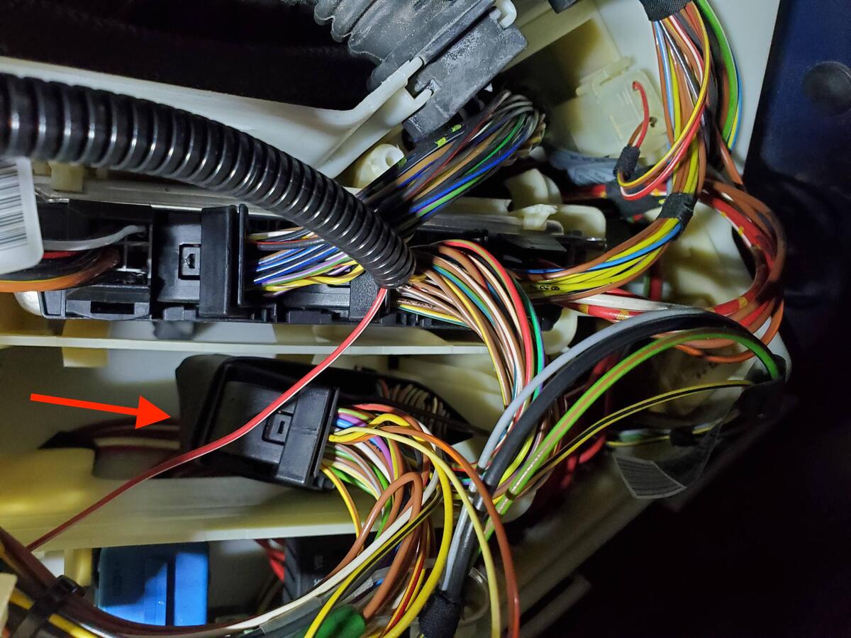

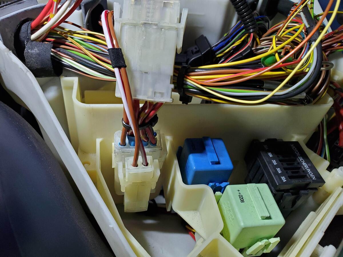

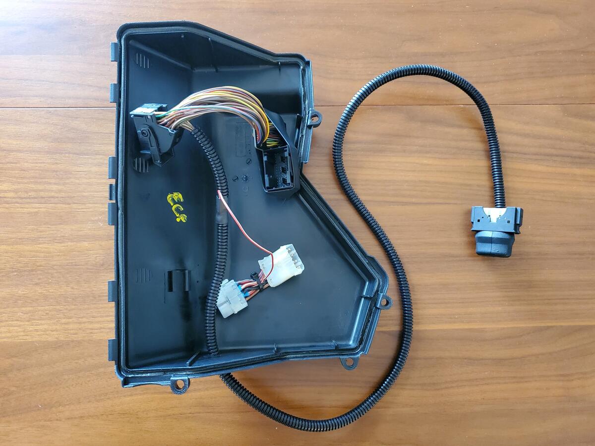

    My car needs to get smogged soon and it won't pass with the CSL intake, so I'll be swapping the stock airbox back in. Decided I didn't want to deal with moving the wires that run to the DME around, so I built myself a harness. Plugs into the DME and one of the power connectors in the ebox. It deals with all the necessary wire shuffling so that the DME no longer sees the MAP and IAT and instead sees the MAF. Also bought a used DME cover to drill through in an effort to make it look at stock as possible.
    Click image for larger version  Name:	20210625_120626.jpg Views:	0 Size:	131.6 KB ID:	112124
    Installed:
    Click image for larger version  Name:	20210624_194422.jpg Views:	0 Size:	180.4 KB ID:	112125
    Close up of where the harness taps into the power connector:
    Click image for larger version  Name:	20210624_194427.jpg Views:	0 Size:	145.5 KB ID:	112126
    Close up of where the harness taps into the DME X60003 connector:
    Click image for larger version  Name:	20210624_194434.jpg Views:	0 Size:	154.1 KB ID:	112127
    Everything installed on the car (minus the stock intake of course):
    Click image for larger version  Name:	20210624_195155.jpg Views:	0 Size:	182.6 KB ID:	112128
    Happy with how it turned out and it should make swapping intakes a super simple task.

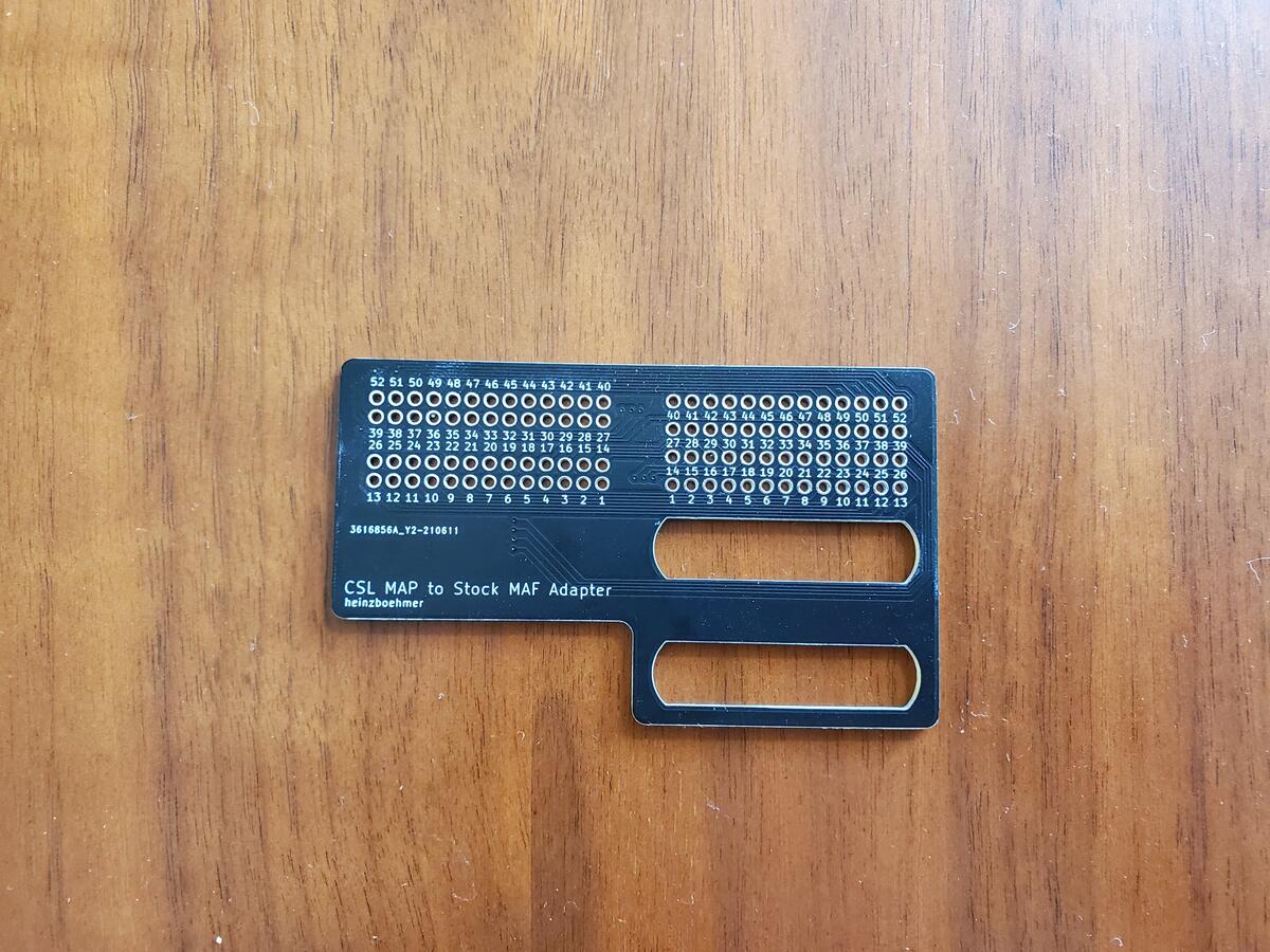

    P.S. I had a breakout board for the X60003 female connector made and the fab house had a minimum order quantity of 5. So if anyone wants one, hit me up. Here's a pic:
    Click image for larger version  Name:	20210625_123746.jpeg Views:	0 Size:	181.9 KB ID:	112129

      That's a great job there. Always appreciate a OE-like solution to a problem. There's something about doing it like you did that makes it oh so much better.

        You get those mqs terminals heinz?
          Or just know a guy
          Yup! Just not new lol
          Bought a pigtail on eBay just for the male X60003 connector and it came with a surprising amount of wire, both in terms of length and in terms of number of wires. I ended up just reusing using those. The MAF terminals I just grabbed from my MAF connector. I thought I had done away with it, but I found it in my old parts box.
          The biggest pain (and the part I'm least happy with) was the power connector. I could not find any place online that had them in stock, so I had to resort to getting one from a junkyard. There was only one E46 in the whole place and of course it was already terribly scavenged. Found the connector, but it's cracked in a couple spots and the wires are waaay too short. I'll probably end up redoing that bit in the future, assuming I can find a connector that's in better shape.
