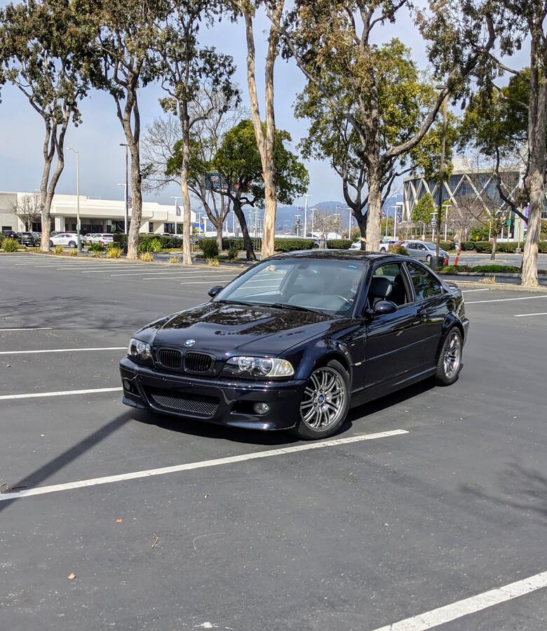

                        Just dropped off my car to Performance Technique for this list of parts going in,
                        VinceBar Epoxy and Rivet kit
                        Turner underside reinforcement plates
                        CMP Subframe Bushings
                        CMP RTABs
                        Turner Rear Camber Arms
                        Hotchkis Front Sway Bar
                        ST XTA Coilovers
                        All OE/OEM bushings, bearings, diff cover, and rubber front and rear
                        This is number 2 of the big 3 once the work is completed. Last is a Blackstone Labs test once I do the oil change, that will determine if I jump on rod bearings immediately, or give me time to collect some parts. Cams, Karb airbox, and a tune is in the near future. Getting my build journal updated here. Click image for larger version
