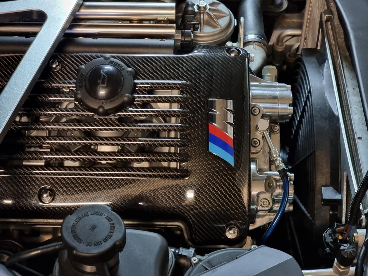

      Karbonius vented engine cover and Mishimoto electric fan:
Name:	Engine Cover & Electric Fan.jpg
      Pure perfection bro!

              poss did karb send you the necessary hardware or a replacement piece?
              Karb FedEx'd me 6 12mm washers and instructed me that they go topside ( when the picture on their website appears to show metal fittings bottom side)
              The studs are 10mm, so 12mm washers don't fit nicely either. The holes in the cover are more like 14-15mm. I have no idea why they would make them so large for a 10mm stud if there isn't an insert/sleeve
              Not overly-impressed given the price of the cover. Will try to find a better fitting washer at the hardware store...
