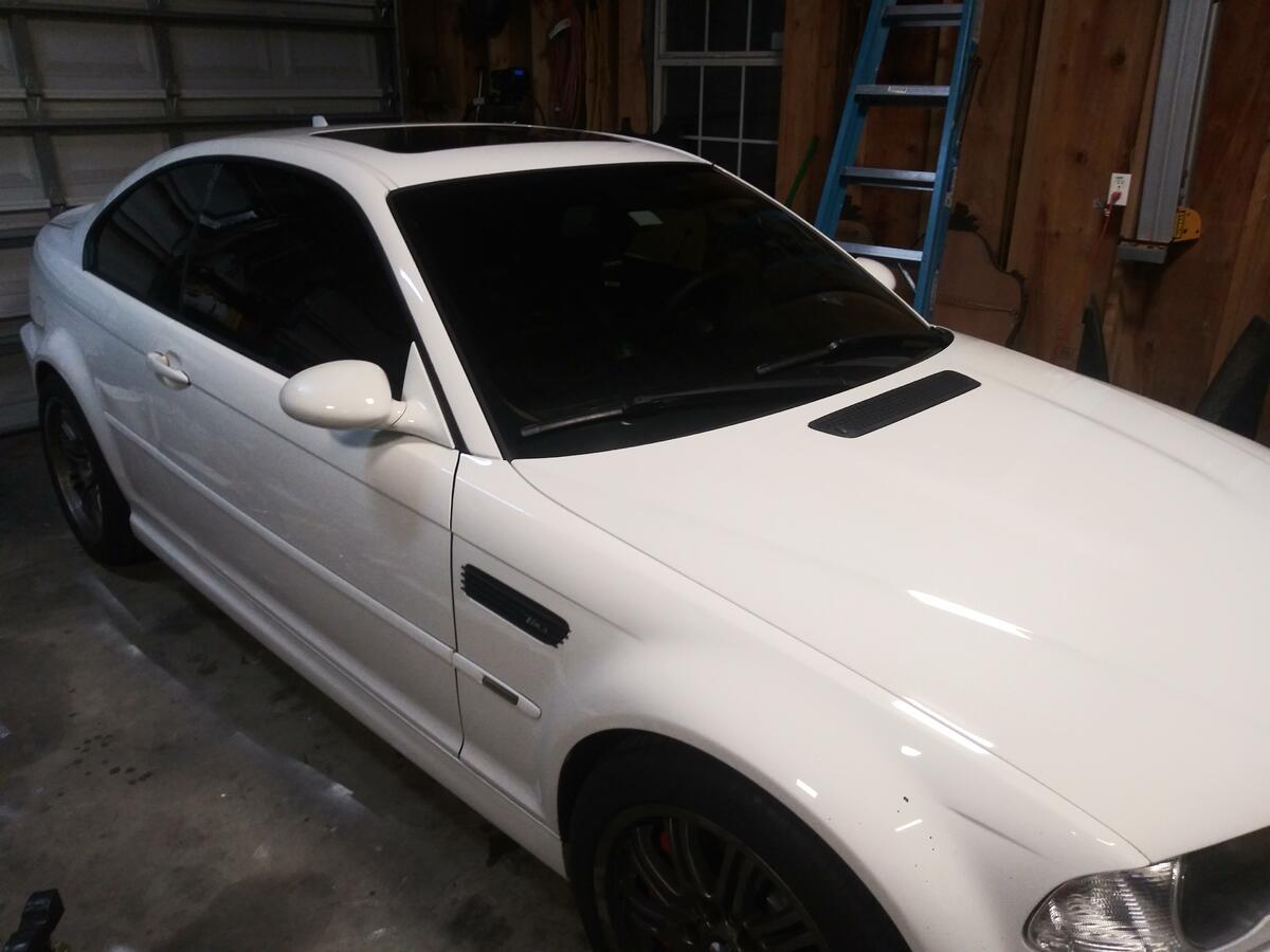

    Took this garbage(it's Chinese like the virus) off today and put the stock intake back on. I also ditched the Dinan strut bar because it got stuck in the strut tower holes. Top quality piece right there for over $400. I hate Dinan. Went back to stock strut bar which was installed after I lowered the car.
    Did a water pump and thermostat.
    Put on the B6s with Eibachs

    Added a couple layers of BMW wax. It went from disgusting to shiny and smooth.

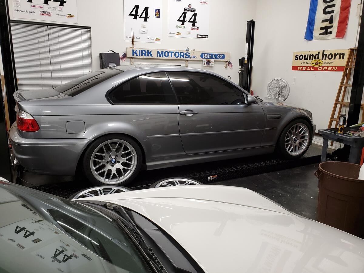

          Ssv1 headers finished as well as some Sportline 8s wheels w/ PS4's. The Ssv1s made my car a bit faster and notably louder going from Euro headers/cats to Ss headers/cats, digging them so far.

            Bro you should have doe the wheels later! You got 2 big go mods. The headers are great, but 20lb 18" wheels vs stock 19s is massive too!
            Looks great too, I love them!
              Looks Good Brian! 🤙

                I drove the car with the headers first tonight, I just got the wheels on about 20 min ago so tomorrow I'll see how they perform, can't wait!
                Thanks for the info on those wheels by the way, it was you who steered me that direction.
                Also with the Ssv1/sec 1. I had to remove the heat shield off of my Sec 2. or it was touching right where the sway bar mounts up as well as the driver's side output flange which was a bit disconcerting. I used a few washers on the two rectangular chasis/exhaust braces and it helped Sec. 2 clear enough to where I can push up on it hard from underneath the car and it does not contact anything.
