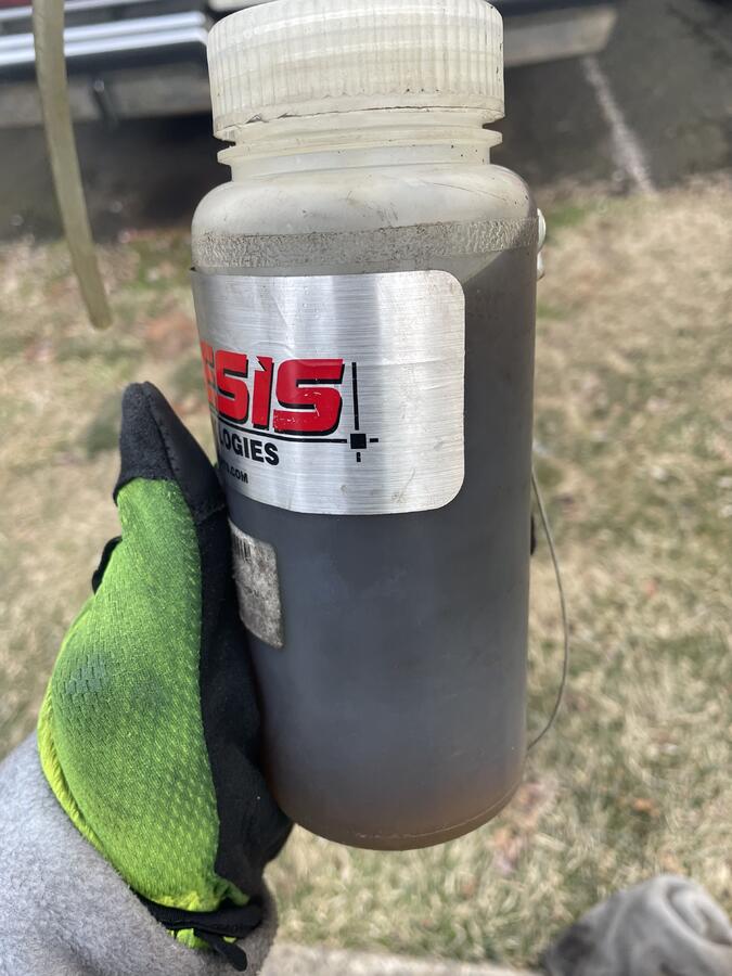

    Maple syrup anyone? #brakefluid

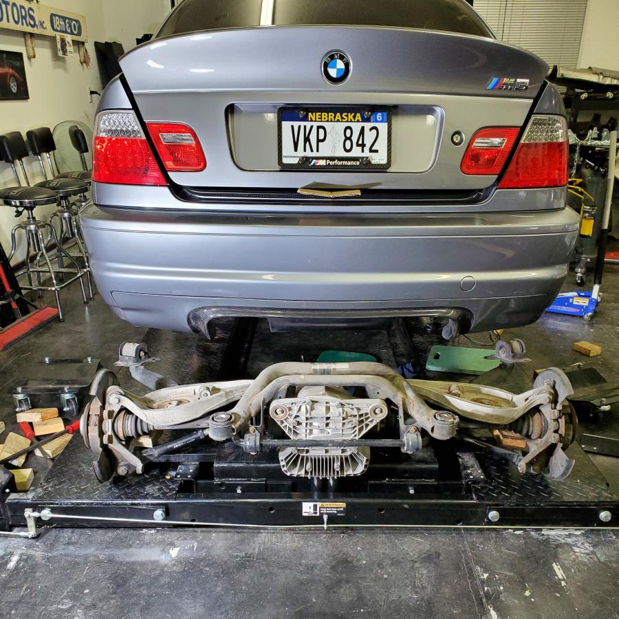

        Dropped the rear subframe of the track car for a bushing/bearing refresh. Also going to upgrade the diff. I’m getting good at this, out and disassembled in 4 hours 👍.

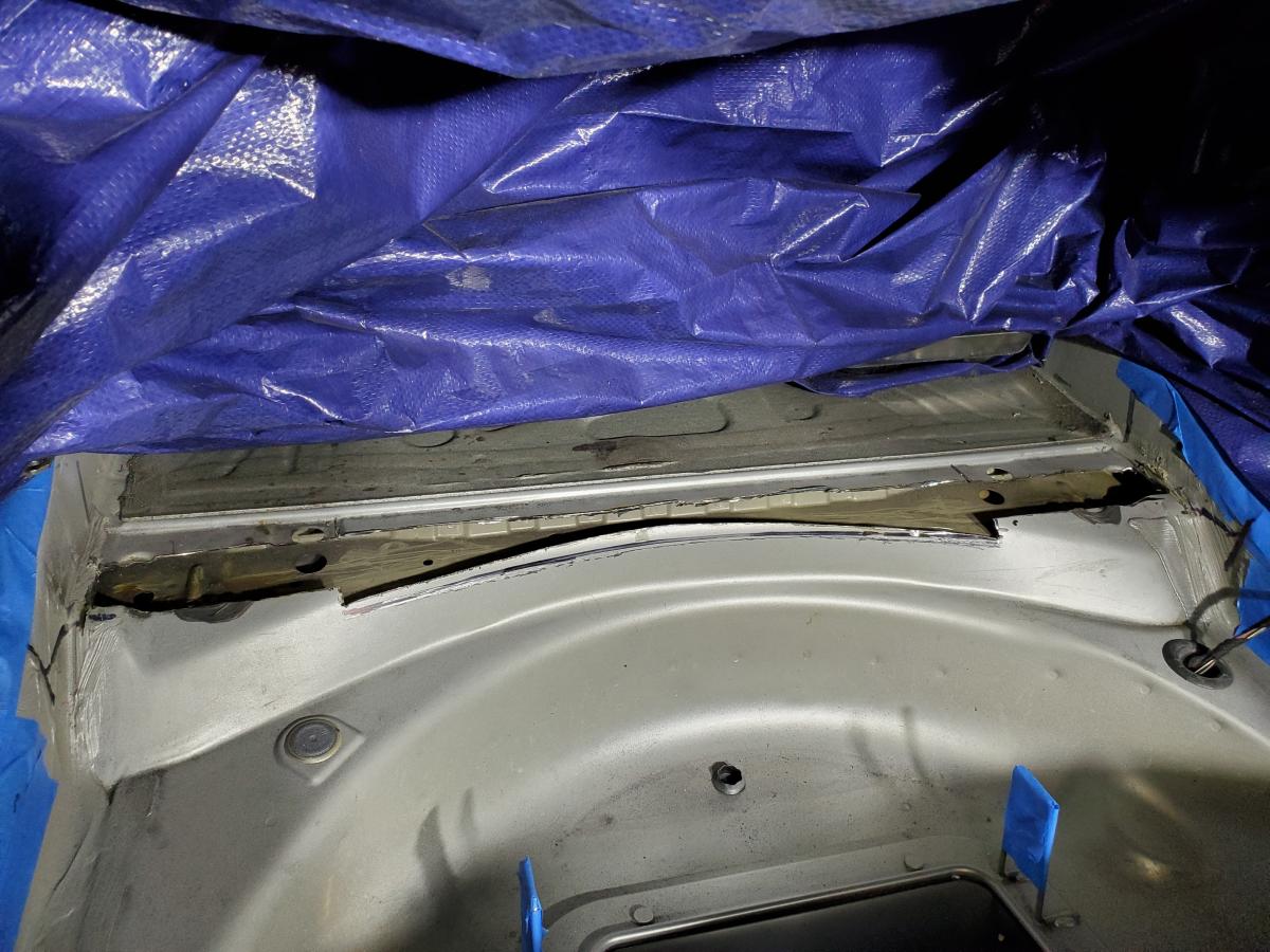

          Learned that my RACP has been replaced once before.
          I don’t know why the photo is upside down.

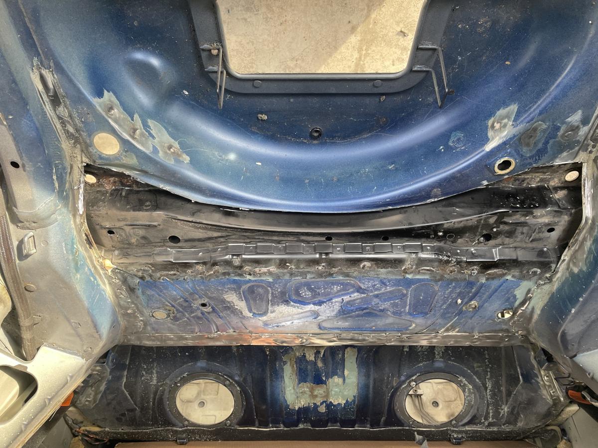

            Reinforced racp, no cracks.

              Pulled the rear end for topside reinforcement, CMP subframe bushes/Turner monoball RTABs and OEM everything else.
              Wondering if I want to remove the pinion nut on diff. or not so I can replace that seal as well. I don't want to mess it up..

                It’s easy enough to get the pinion nut off and back on again with an impact driver or wrench. Just paint mark it before removing so you can get it back to the right spot. This may not be the most orthodox method…
                Seal installation was fairly easy.
