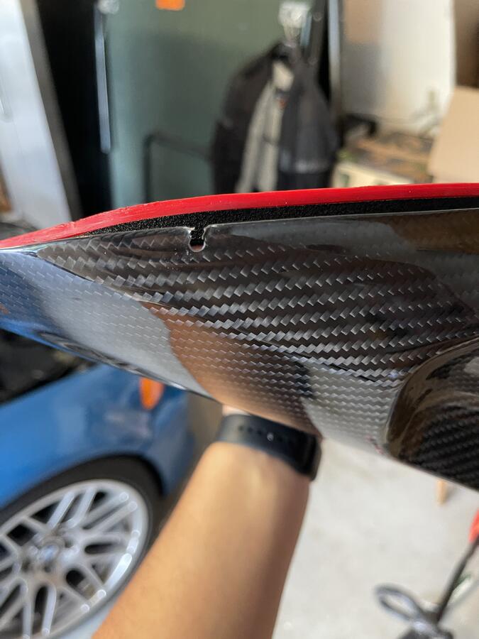

    I have this same issue, and so have a few other forum members. I took photos and videos and sent them to TMS Customer service. It’s covered under warranty and I’m waiting for my new replacement to arrive to send mine back. Seriously contemplating just selling the replacement and ordering a Karb just for the fit and finish alone, even if the wait time is another 6-8 weeks.

      Ah duh, the filter being sandwiched is applying the pressure on the pins. Looks like they just rushed it through at the end of the design phase, drilled some holes close to the edge without any kind of reinforcement, and let 'er fly.
          I wonder how other airboxes mount their filters then. IMO I think four Allen screws on top and bottom would be the easiest way to secure the box without sacrificing the structural integrity
            The other boxes have sufficient meat and distance to edge from the holes. You'd never be able to get to the bottom ones, that's why it's pinned. Bottom edges meet, pivots on the pins to secure the filter, and 4 allens affix the top.
