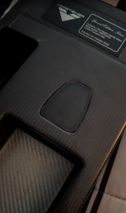

              Here is a little blockoff for the CSL center console mirror control switch.
Name:	CSL console.jpg
