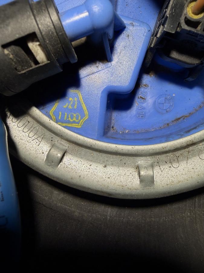

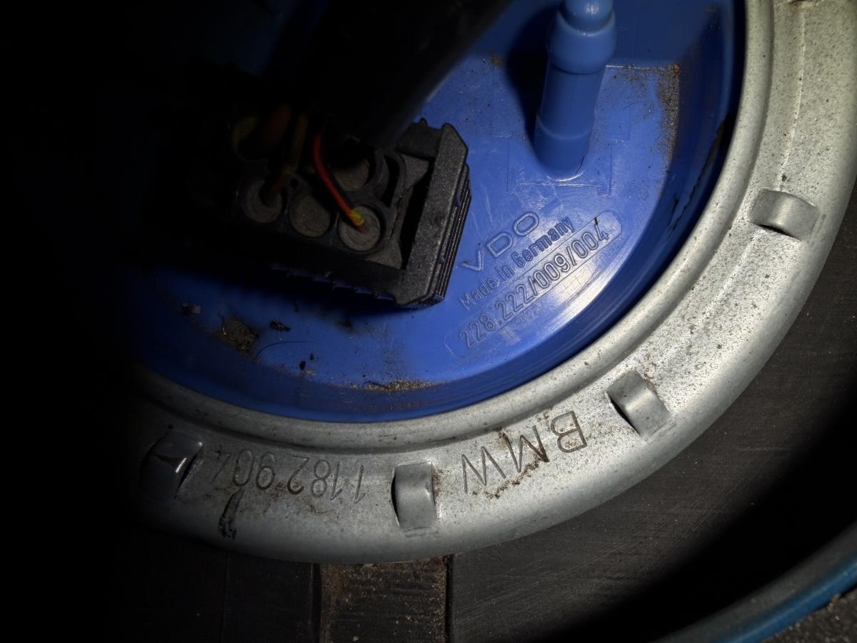

              Can anyone tell what manufacturer date my pump is? Grok thinks it's a 2019 year

                Stamp shows 11.00, so November 2000
                Under the electrical connector, it should have the week of the year and the year.
                Not really in AI's wheelhouse.

                    Yikes. I had a feeling it was wrong. Thanks
