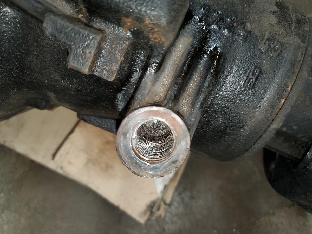

                Now I'm installing a vincebar so I decided to fix it correctly. The mount in the diff was absolutely destroyed:
                Click image for larger version  Name:	20201102_192625.jpg Views:	0 Size:	140.0 KB ID:	66352
                Not sure if I messed up the timesert install (quite likely since I did everything without a drill press) or if the insert just wasn't strong enough and gave up.

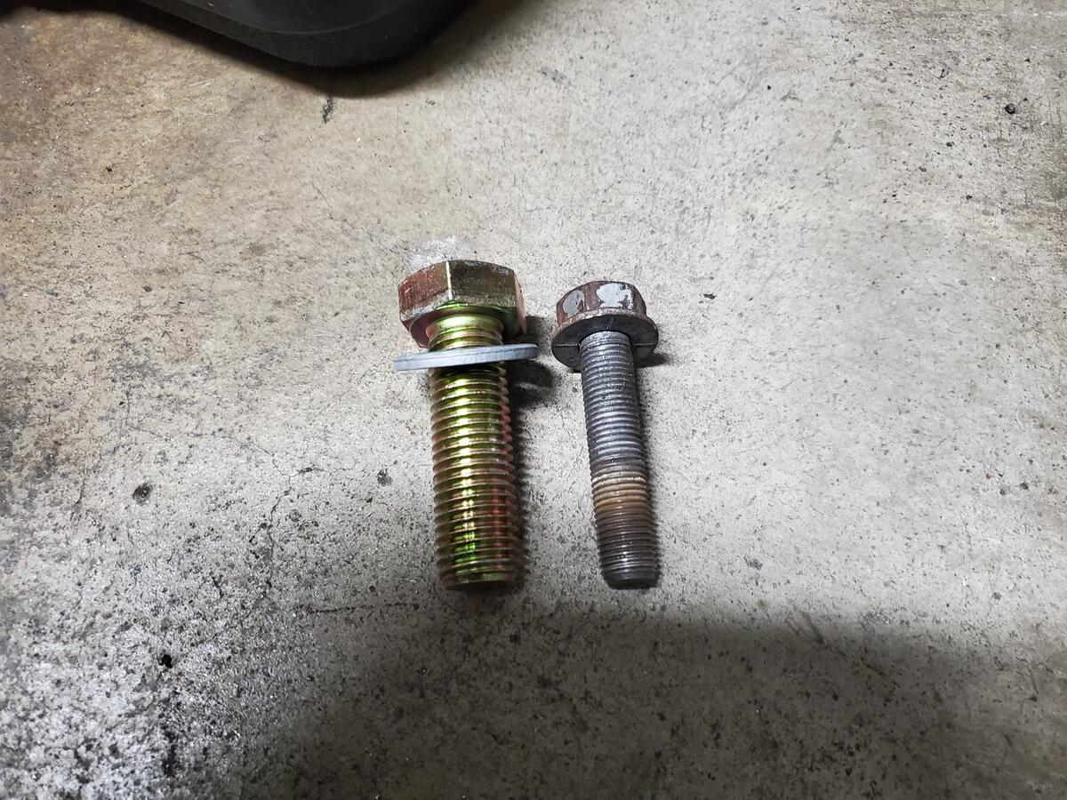

                The old destroyed hole measured in at 17mm at its widest point, so the smallest bolt I could get in there was an M20. Decided on an M20x2.5 which makes the stock bolt look like a toy lol:
                Click image for larger version  Name:	20201106_180012.jpg Views:	0 Size:	224.7 KB ID:	66353

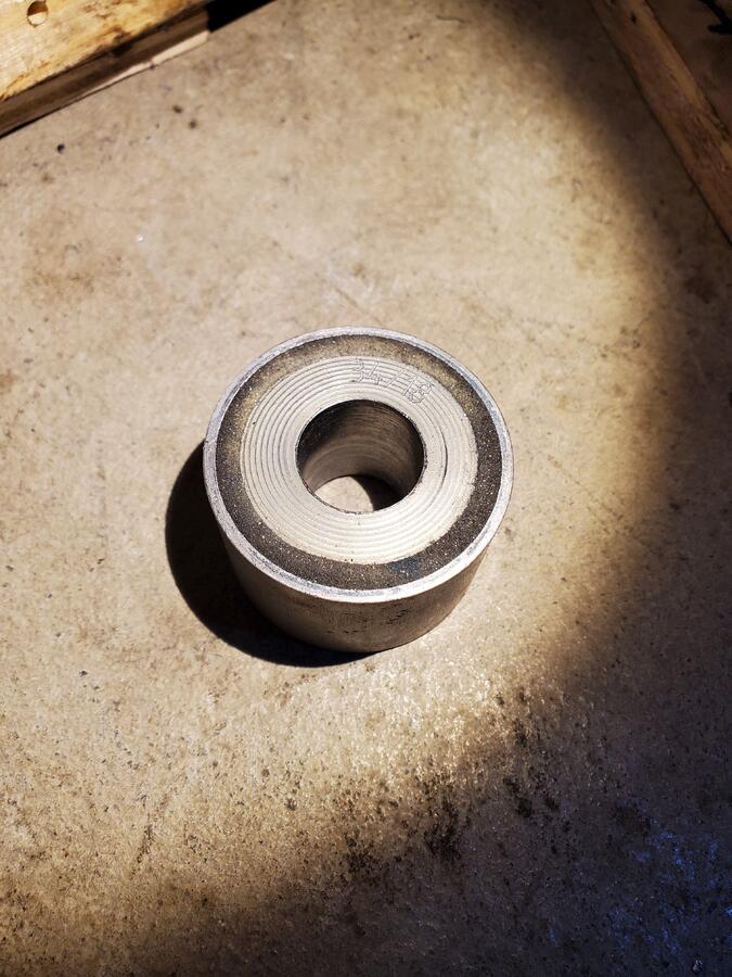

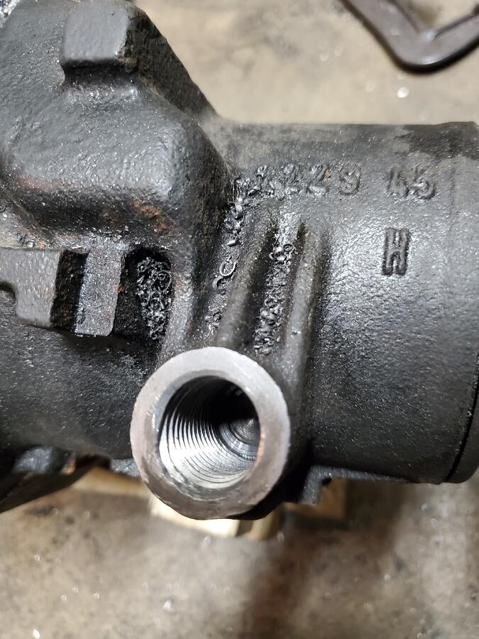

                โ€‹โ€‹โ€‹โ€‹โ€‹โ€‹Drilled and tapped the diff and bought a new diff bushing to drill for the M20 bolt:
                Click image for larger version  Name:	20201107_181428.jpg Views:	0 Size:	107.4 KB ID:	66354Click image for larger version  Name:	20201107_181342.jpg Views:	0 Size:	94.1 KB ID:	66355

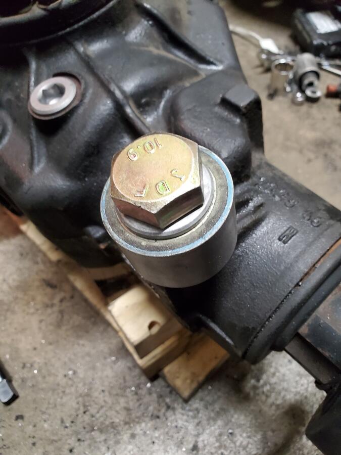

                Click image for larger version  Name:	20201107_181601.jpg Views:	0 Size:	70.1 KB ID:	66356โ€‹โ€‹โ€‹โ€‹
                Plan on torquing the bolt to 285 Nm to achieve the same clamping force as the original bolt. Hoping this fix lasts forever.
