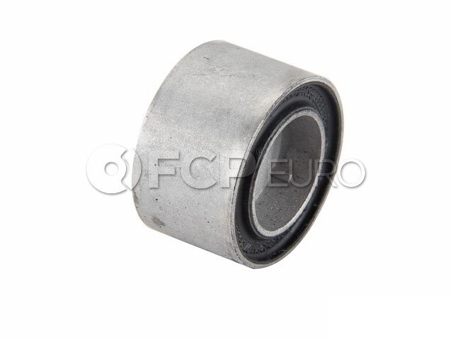

    I thought E36 was foam too, but I don't know if people were assuming it's a different (weaker) compound or what. From memory, it is a yellow-ish color where the E46 is more red, or at least the old/worn out ones I see are reddish color.
    Looks like rubber to me:

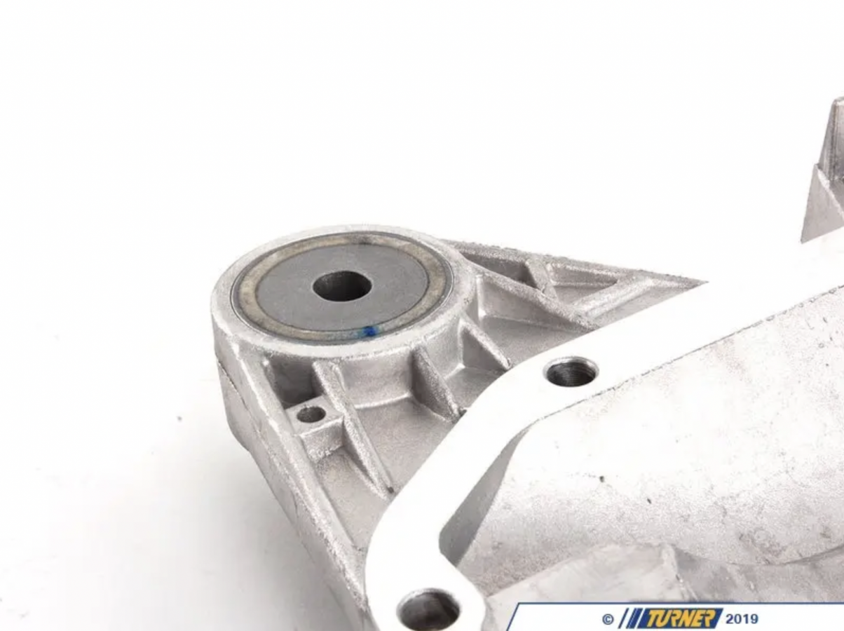

    Also, the new E46 M3 diff covers seem to have the yellowish bushing:

    But looks like the bushings on older covers are red: https://www.youtube.com/watch?v=fcOohpFKZZE Maybe they just get like that with age/heat?
      That's what I'm thinking, same with the bumpstops. I've seen them go from gold to black to red I think..
      That E36 bushing does look like rubber. Maybe that's why they're "weaker?" The foam is so thin on the E46 bushings, yet it dampens quite well for such a stout driveline. The rubber might start out ok, but might fatigue sooner? It's just vibrations and heat though, no twisting (like rear shock/rtab).
      Probably a non-starter for those of us that do 500-2k miles per year.
        I can't believe how many people pay ~$220 more to replace the entire diff cover over e36 bushings when 99% of people wouldn't be able to notice the difference.

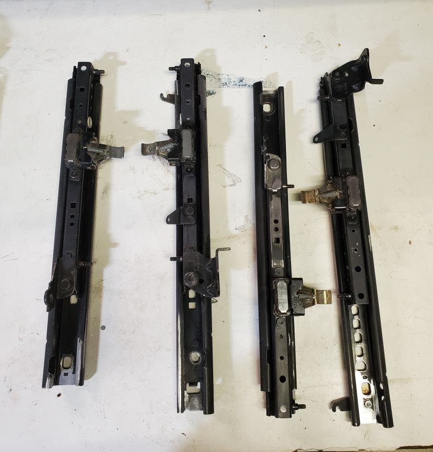

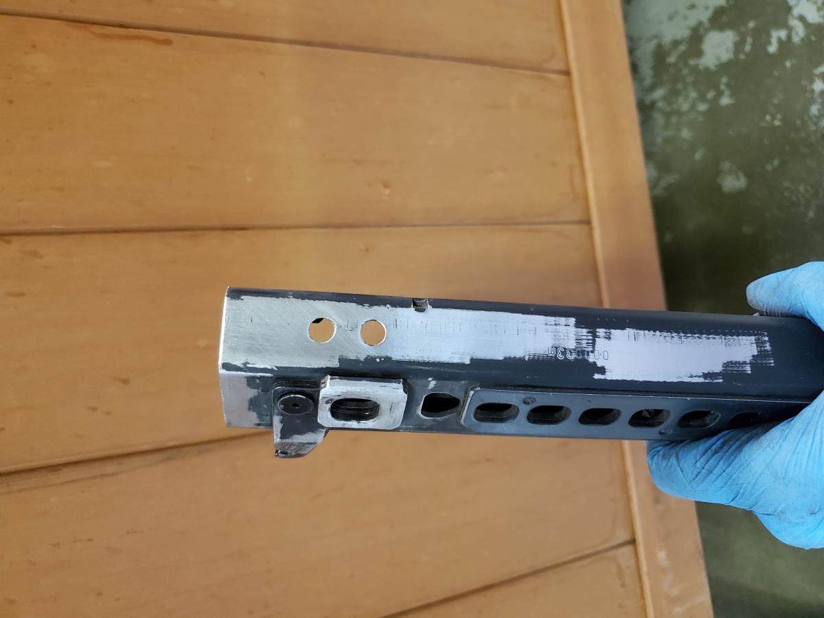

                Cleaning up a set of rusty/gritty manual seat rails from a sedan.

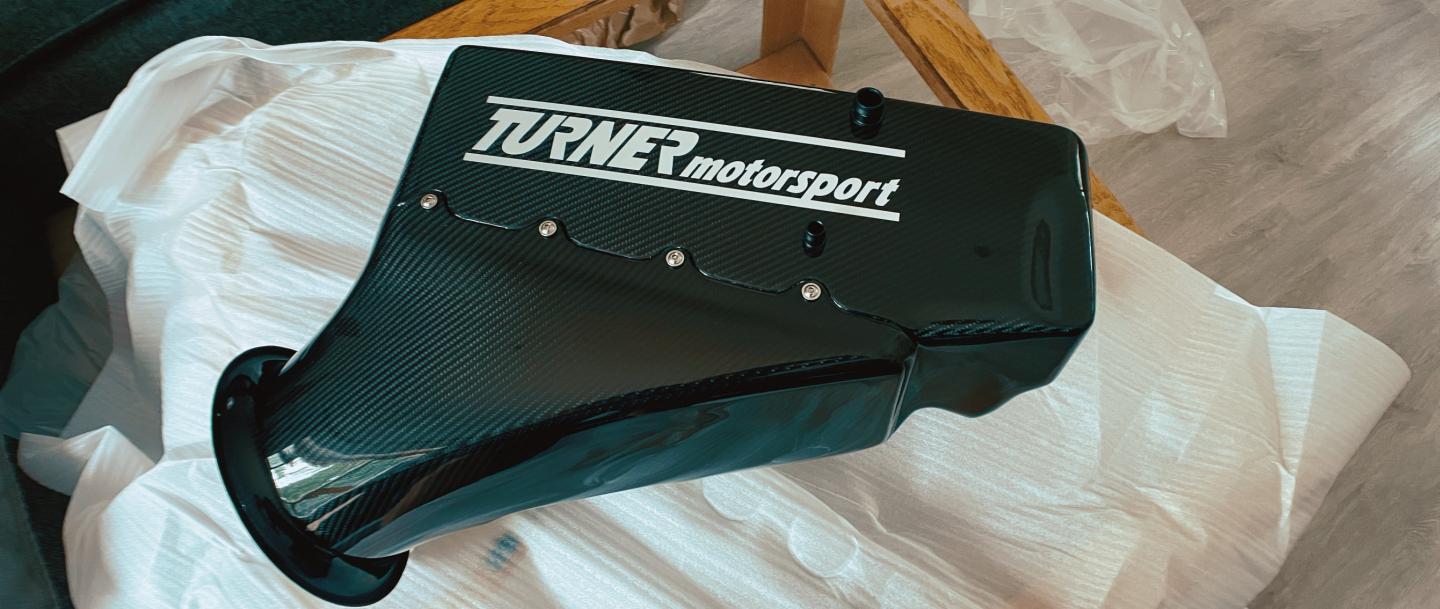

                    Bought SS twin tube Sec 2
                      Just arrived from Turner.
                      Will install in the new year when I am back at home. Away for the holidays.

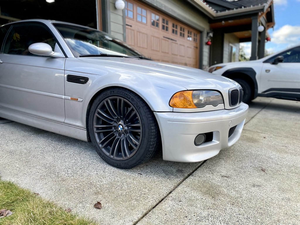

                        Put ambers on for the winter a while back. Doesn't look like it but the car is filthy.

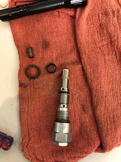

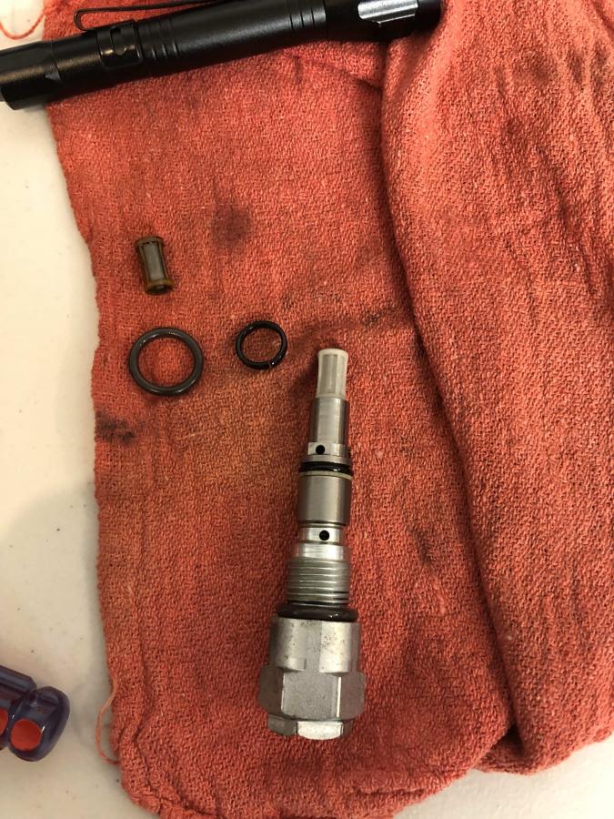

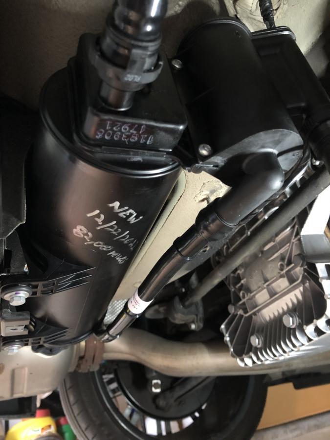

                          Replaced my charcoal canister, VANOS filter, and fixed a broken clip inside the passenger door that keeps the window regulator cable in place (I was getting a terrible rattle with the window up over bumps). At 82k I guess the VANOS filter "looked" ok, but the smaller O-ring looked and felt like the leaking CPV O-ring I pulled out over the summer. Good to get them changed out.

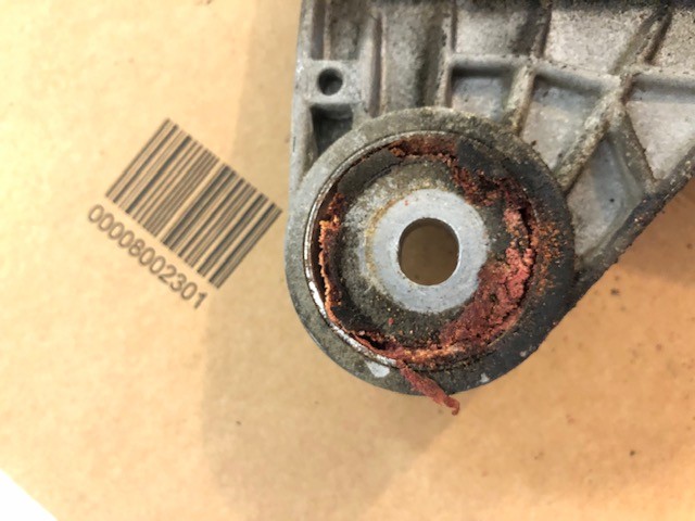

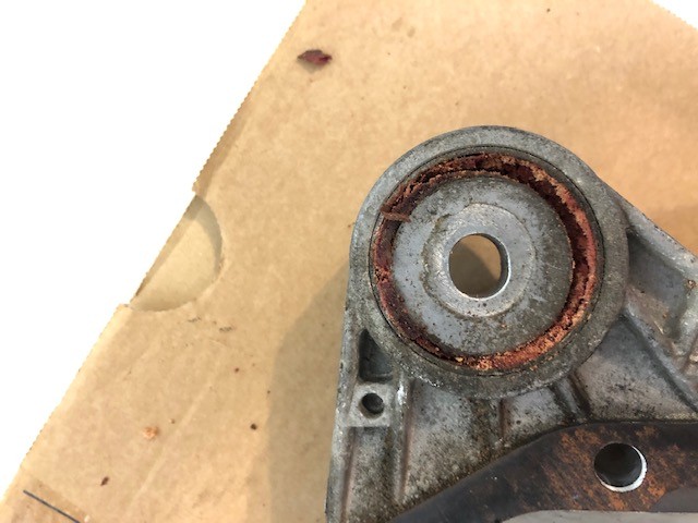

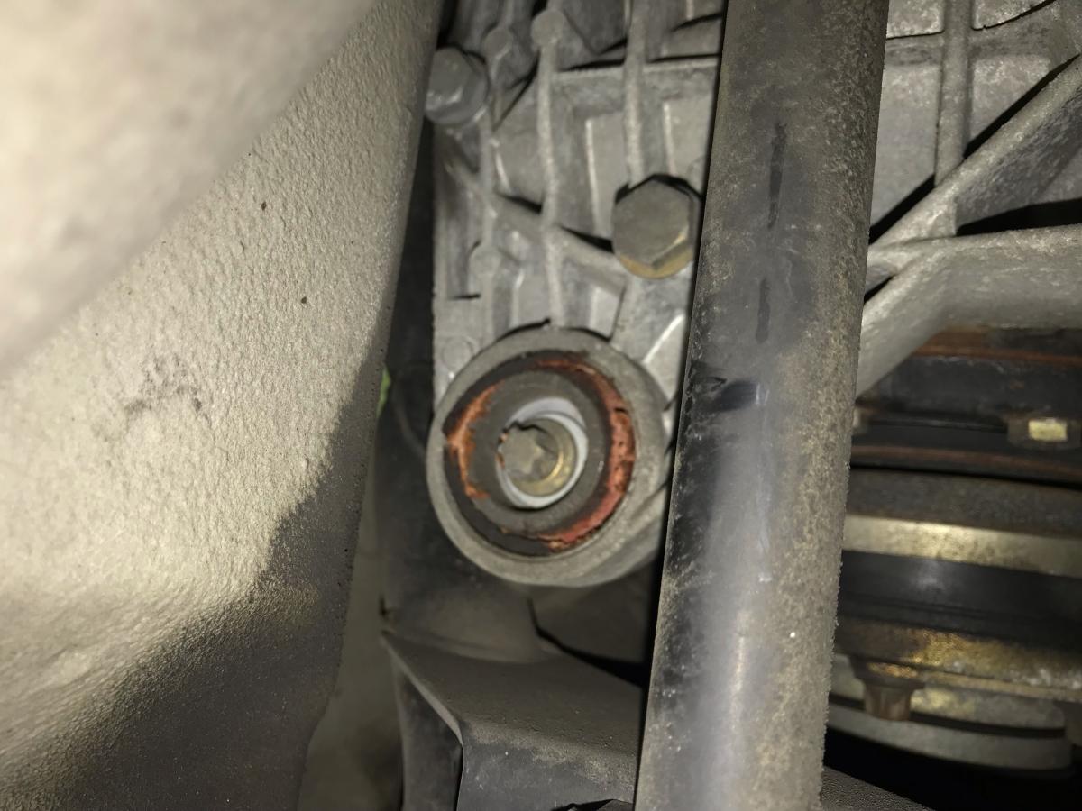

                            My original bushings were shot at 81k miles on a car that has never seen the track and is not driven hard...here are some photos where you can see mine were red at the time I had the cover replaced (BTW I still have the old cover if anyone is interested.) The bushings in the new cover that was installed are grayish color.
