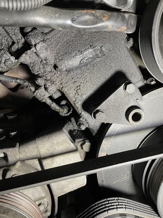

            Which leak causes the timing cover to be completely caked in dirt and oil?
              Could be a bunch of stuff. But I'd start by checking the timing chain guide bolt behind the thermostat housing, then check the VANOS gasket and then check all the other gaskets above that area.
              Clean everything first and that will make it easier to spot the leak.
                Time for new serpentine belts too.
                  The engine is coming out and everything is getting refreshed. My last m3 had oil and grime pretty much everywhere, same with my X5, I just was wondering why this engine would be clean almost everywhere except for the timing cover.
