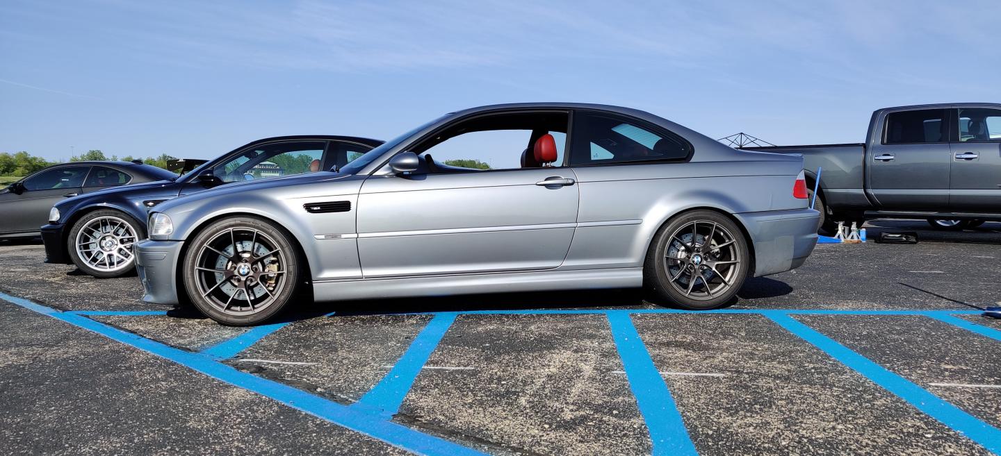

ID:	167739After six months of prep I finally got the car to the track. Doing the Windy City BMW event at Autobahn CC
    I must say I'm blown away by the MCS 3 way suspension and the amount of grip it helps to provide. Direction changes are a breeze even with A052, I can only dream what transitions will be like with a set RE-71RS and their stiffer sidewalls. The only downside is doing the event with the stock seat. At 6'3" my head took some abuse today, I will install my seat before the next event

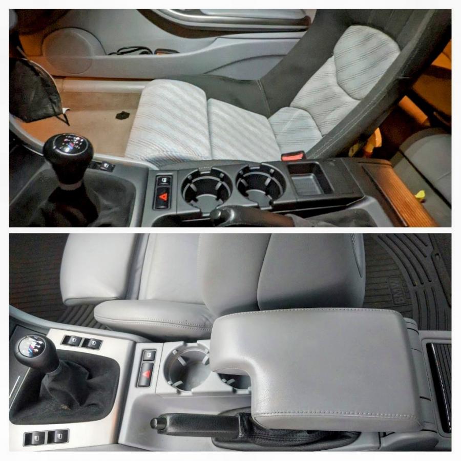

      What seat will you be installing? Is it red to match the rest of your interior?
      997.1 GT3 Carrara White/Black
      C43 AMG Diamond Silver/Red​
        Arm rest delete and moved to black
          Sparco pilot, it is black. I'm unaware if sparco makes it in red

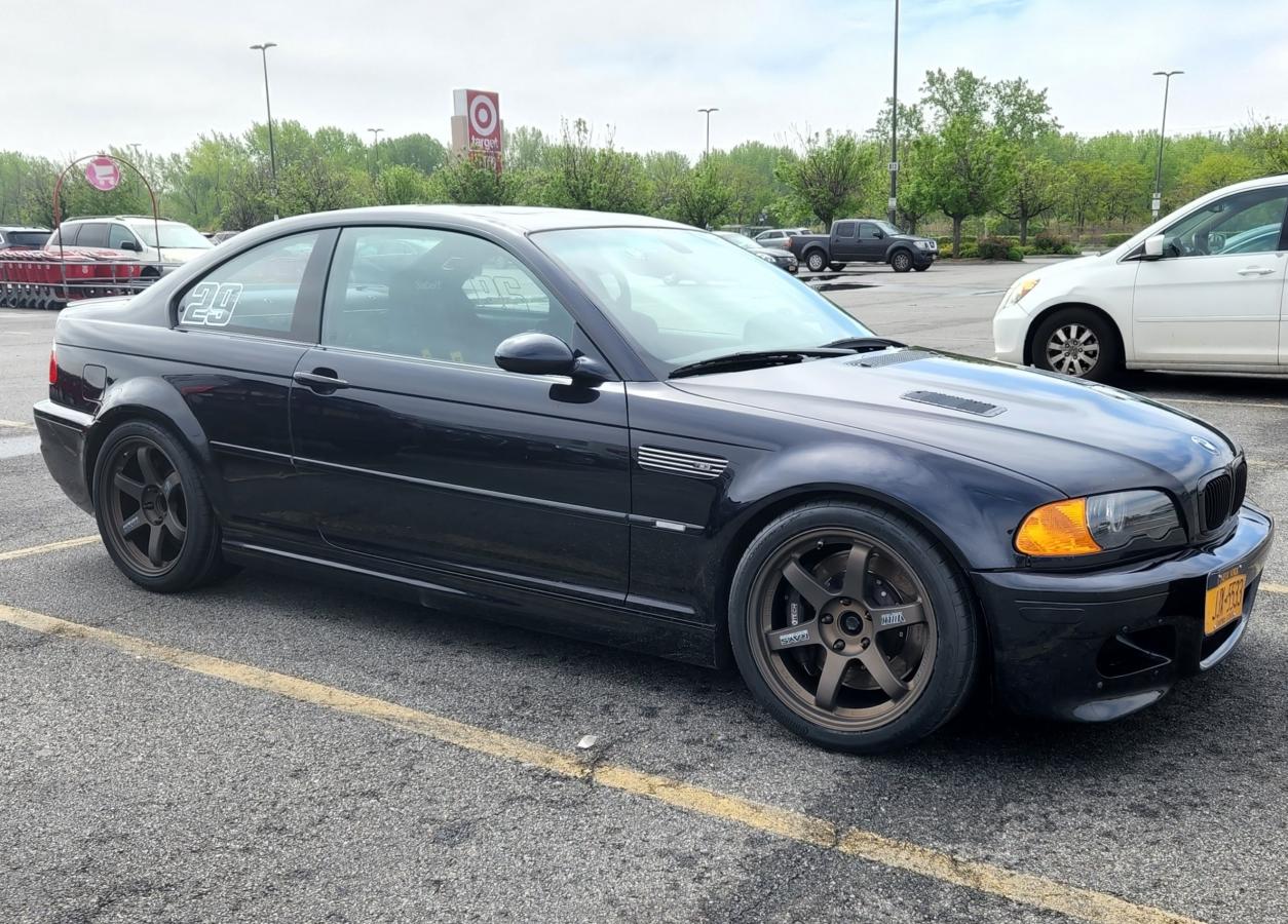

            had a fender bender at the track last year and scratched up my volks....originally mercury silver (or formula silver, i forget). figured since they were already damaged, might as well change them up. had them repaired and powdercoated bronze....put them on this morning and took it out for a spin.

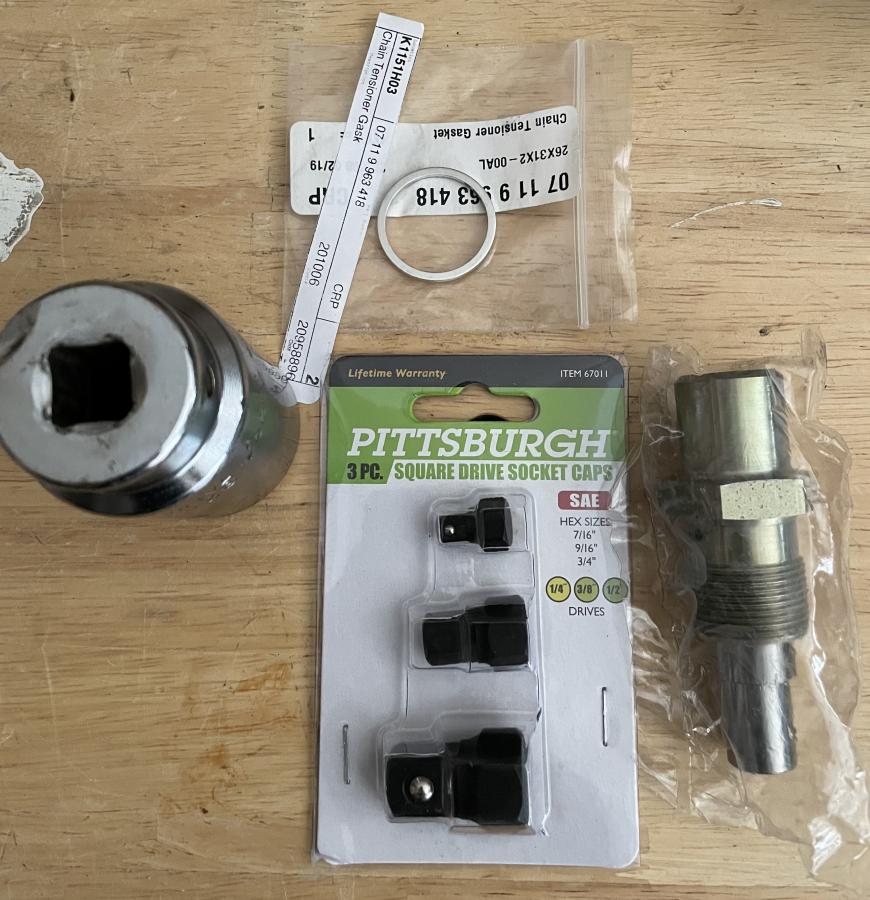

                      Click image for larger version  Name:	0DD973F4-B3CB-4116-89FD-DCB5D2A8A723.jpg Views:	0 Size:	114.8 KB ID:	168470 Posted on my build journal-
                      Discovered an oil leak coming from the timing chain tensioner. Ordered a new one along with washer. Fixed a leak and also a small ticking noise the engine had when cold. The ticket had recently started and thought it needed another valve adjustment. According to different websites says this is a common symptom of a bad tensioner. Took about 10min to replace.

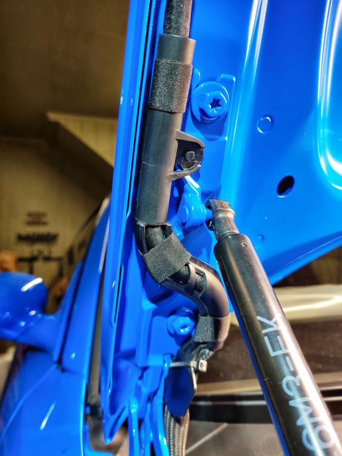

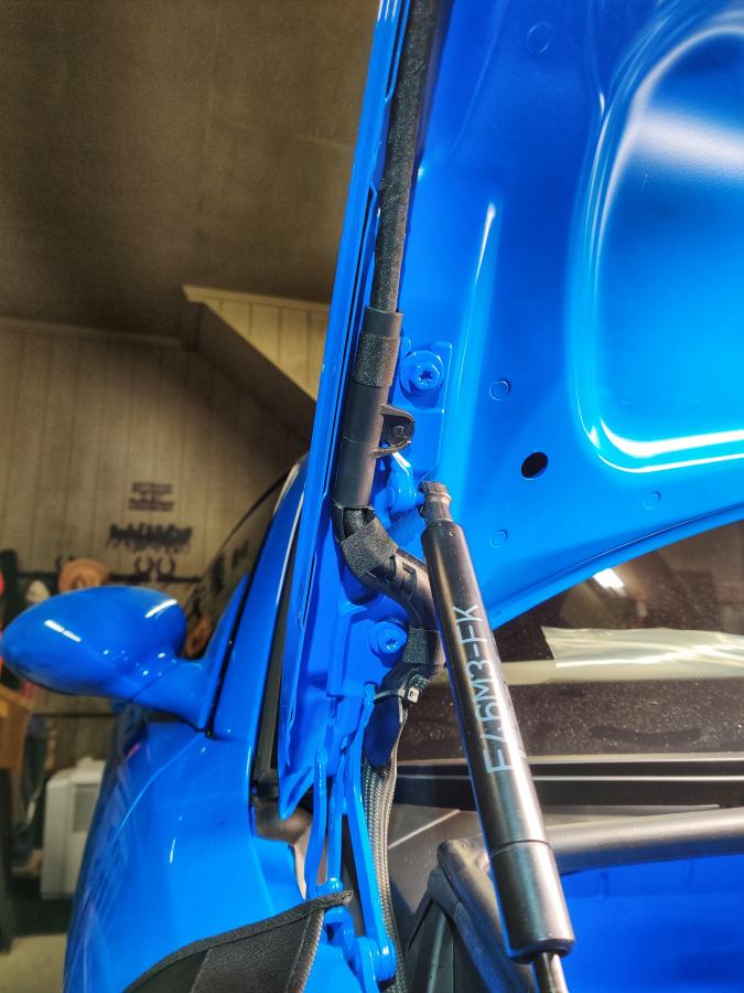

                          Rewrapped the windshield washer hose and heated washer nozzle wires with Tesa tape high temp. I love this stuff. The black electrical tape and the old felt tape on the plastic cable guide were far past their prime. This is nearly the last bit in the engine bay on the to do list after installing the motor.

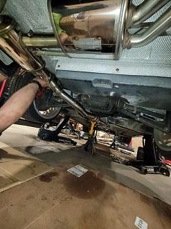

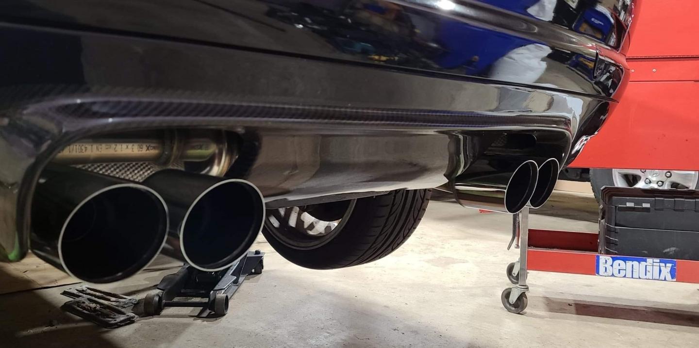

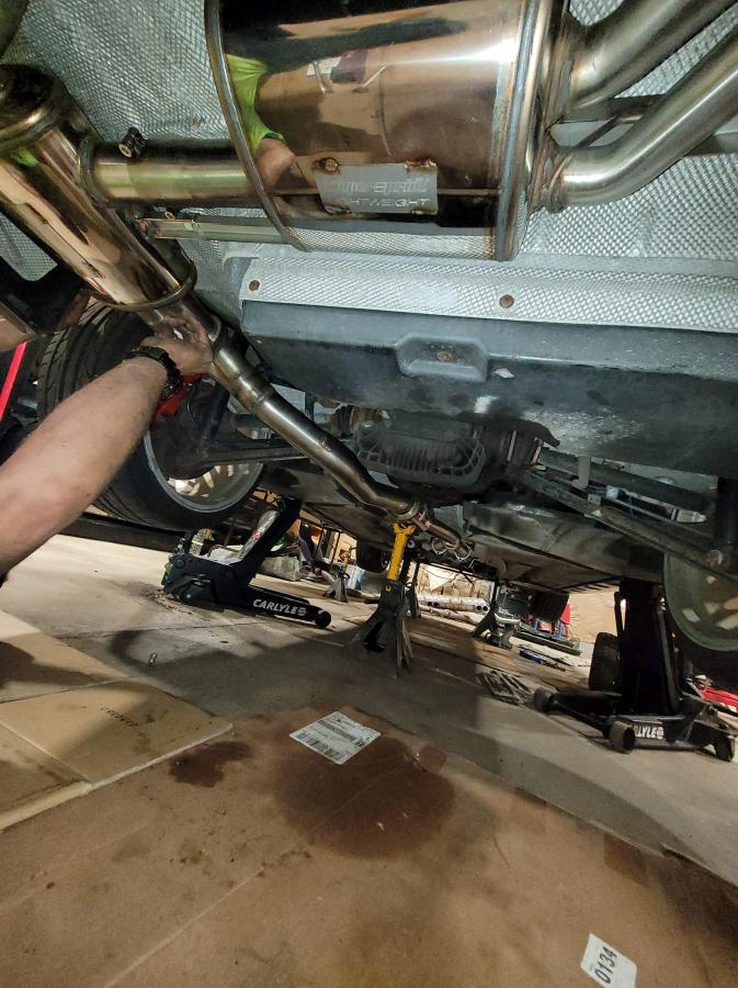

                            Mocked up SS Race muffler and SS resonated section 2. Still need to work on section 1 and headers. Undercarriage needs a refresh, that's in the works also.
