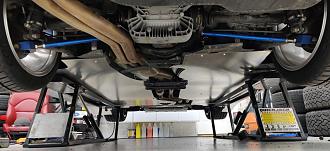

      ​​​​​​Getting close to finishing the sideskirt extensions
      Man do you have a dedicated thread to those underbelly pans? Nice work, would love to see more details. I have a soft spot for functional racecar fab work and that certainly looks like a cool project to me.
          I actually don't because I always get too busy doing the work and don't ever think to document things
